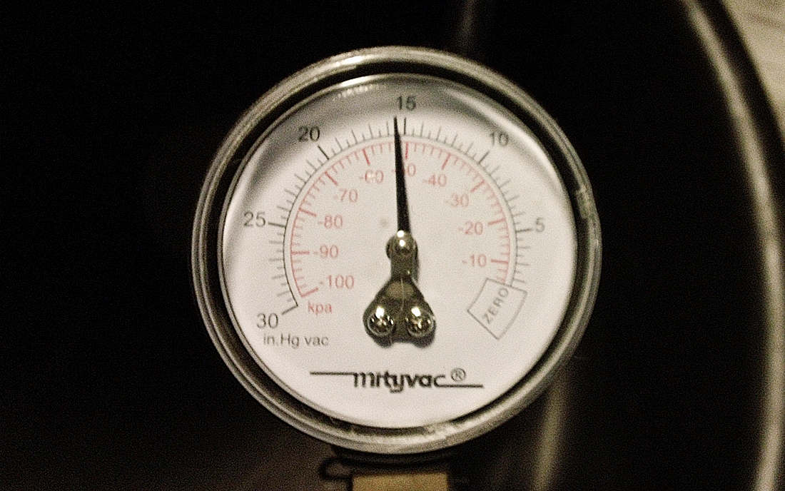

Next step - brake bleeding. Would this MityVac vacuum instruction work since there isn't a 2nd person to assist.

Solo Method: Pump to above 15 inches of Mercury (in-Hg), opened the bleed value 1/2 turn - 180º. 30 seconds of air bubbles, then let it drip close to 2oz, each wheel, while keeping the reservoir filled close to Max marker.
