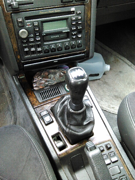

Post by polskamafia mjl »
June 16, 2015 - 275,118
Replaced failing AW50-42 transmission with M56.
Installed new clutch and pressure plates, resurfaced flywheel
Replaced rear main seal
Replaced o-ring and gasket on turbo oil return line
Replaced turbo coolant drain hose with IPD silicone hose
Replaced brake booster vacuum hose
Replaced turbo vacuum hoses
Replaced front, rear, and passenger side motor mounts
Oil and filer change with Mobil 1 10W40 synthetic and Mann filter
M56 gear oil drained and replaced with Valvoline 75W90 gear oil
Replaced intake manifold gasket
Replaced engine oil dipstick
