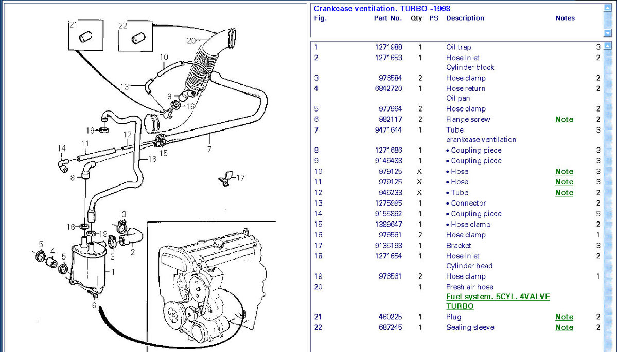

It was the PCV kit from FCP that included URO hoses. Blew it right off and on to the road somewhere. I am kind of interested to see if I could fashion something out of hose to replace the troublesome hose. If not, I am lucky enough to live in Franklin, TN, home of Darrell Waltrip Volvo, and I could pick up some parts from the stealership.jblackburn wrote:Is that a URO or genuine Volvo hose? My URO blew off constantly - it is useless junk.
One thing I did recognize on the PCV diagrams, Volvo has this hose (18) connected to the cam cover with a clamp or clip (19). The hose that I received did not incorporate a clamp and it basically just "plugged" into the cam cover. A little confused because I don't see how the clamp would hold anything. I am going to have an extra vehicle today to run around town and grab parts as I work on the vehicle.
