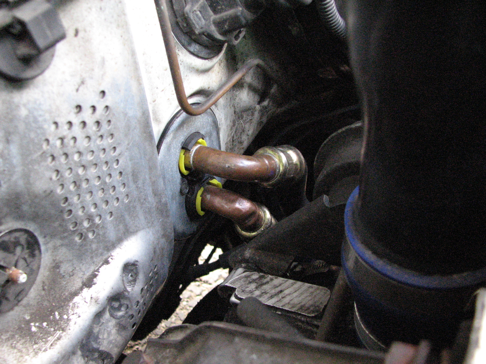

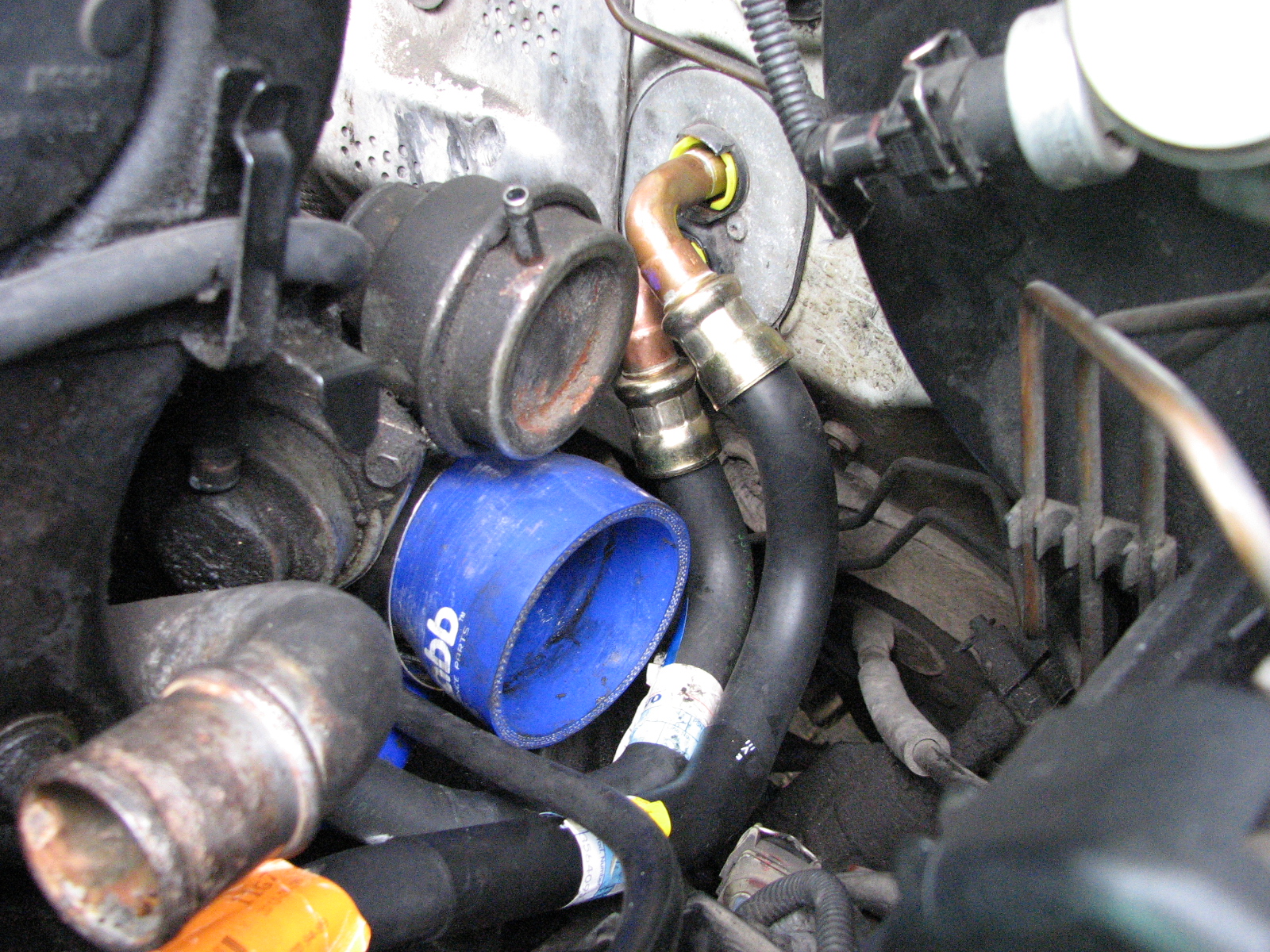

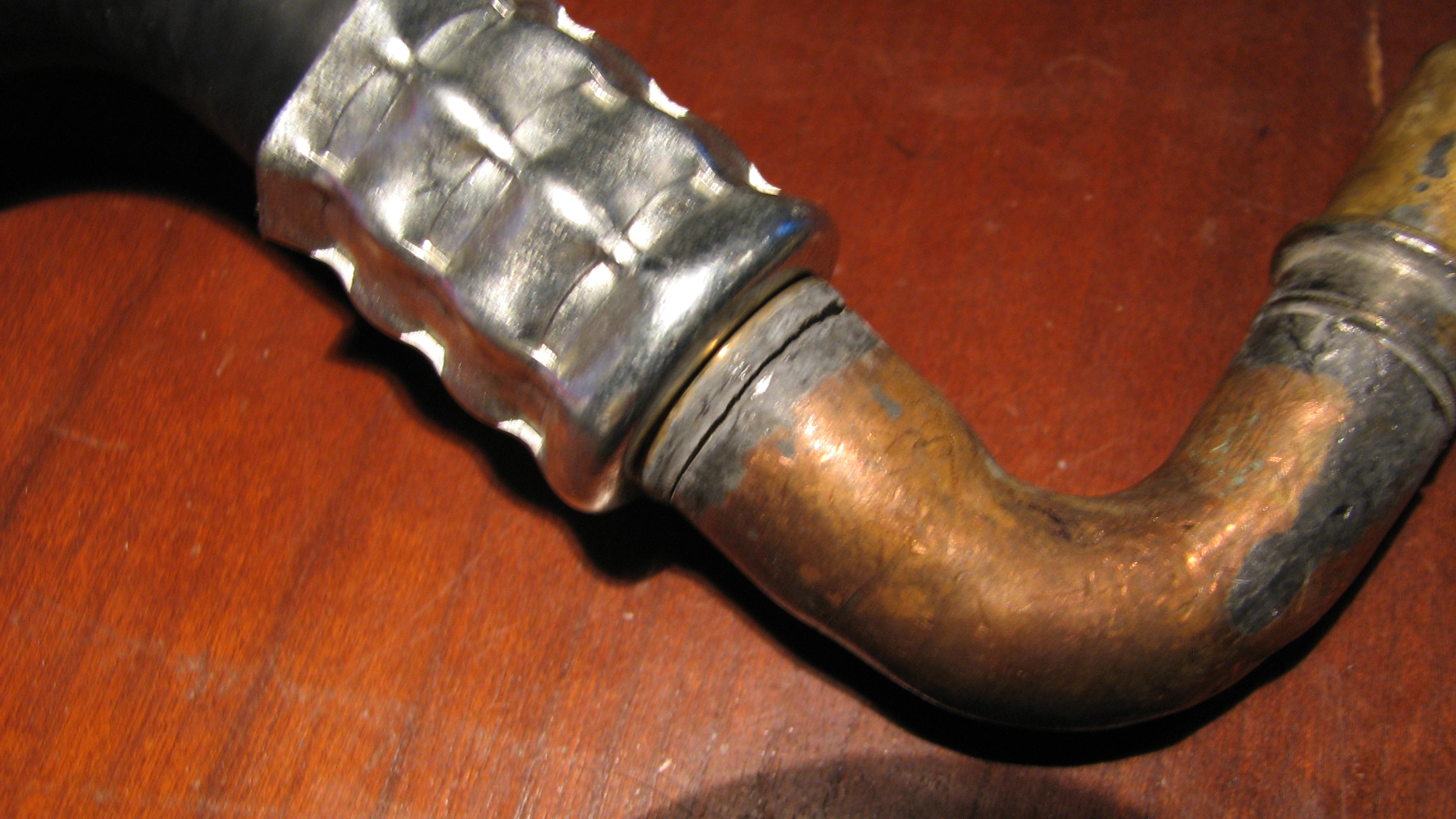

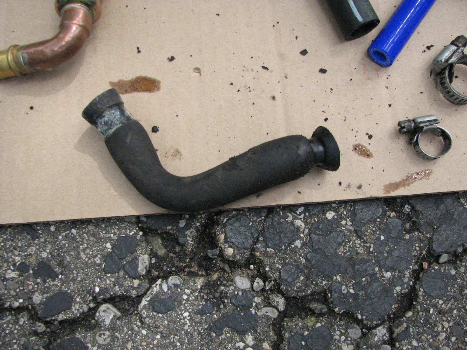

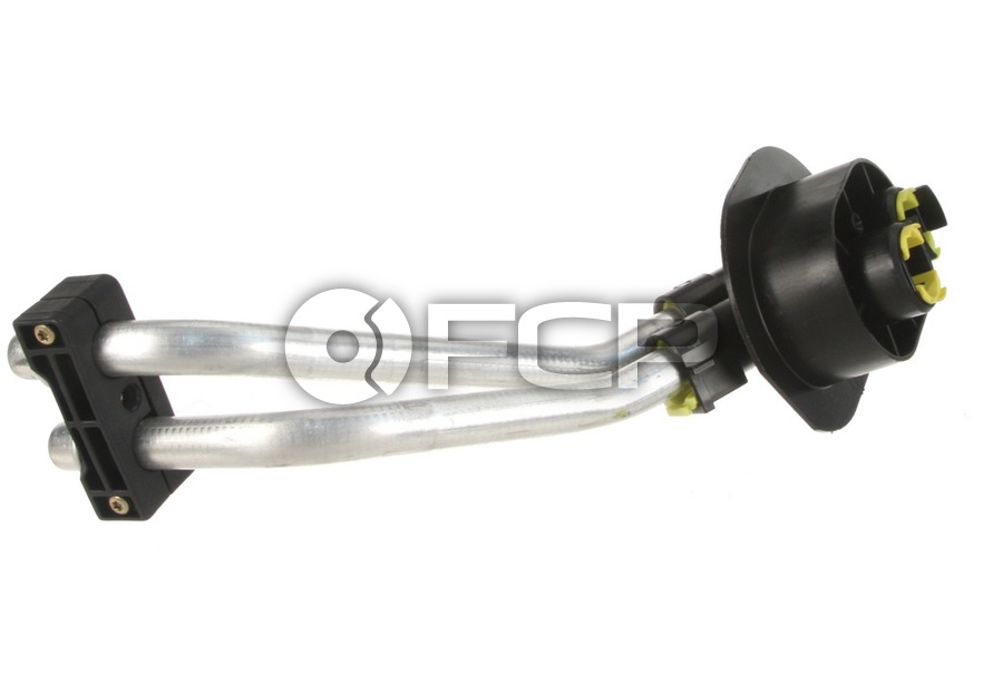

I had heard a click, or crack actually when pulling out the old heater hoses from the coupling at the firewall.
As I was afraid of, I had broken the coupling and the bottom line simply pours out at the junction.

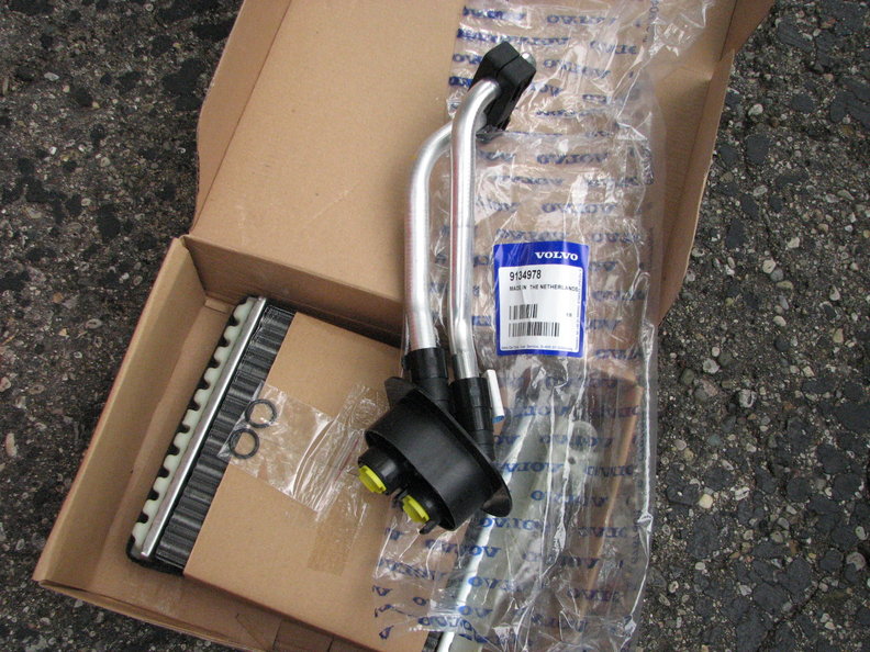

I have ordered a heater core, and the heater tubes with the junction at the firewall all scheduled to show up in a couple days.

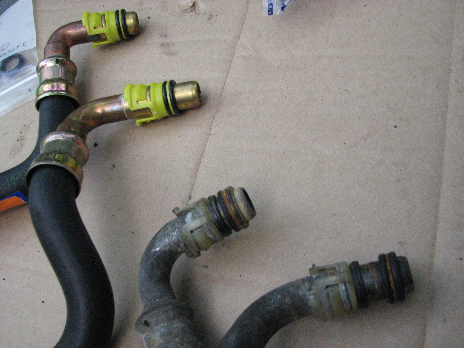

I have to thank Steve, one of our moderators "abscate" for bringing a pair of OE Volvo heater hoses with him on a business trip to my area to assist in the expedition of my repair. I would not install the URO hoses I had received from FCP and sent them back.
I was not happy with rebuilt/re soldered tubes and Pot metal pressure fittings. URO
New and Old. But both OE Volvo. Thanks again Steve! "abscate"

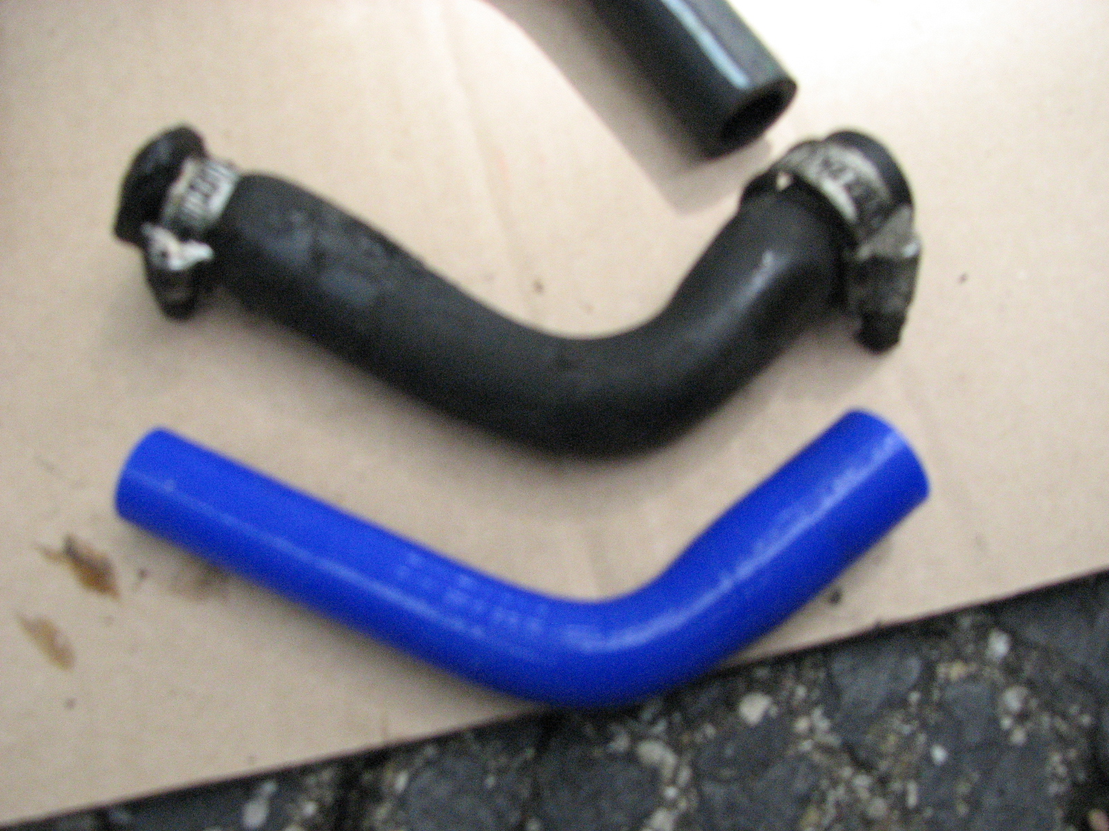

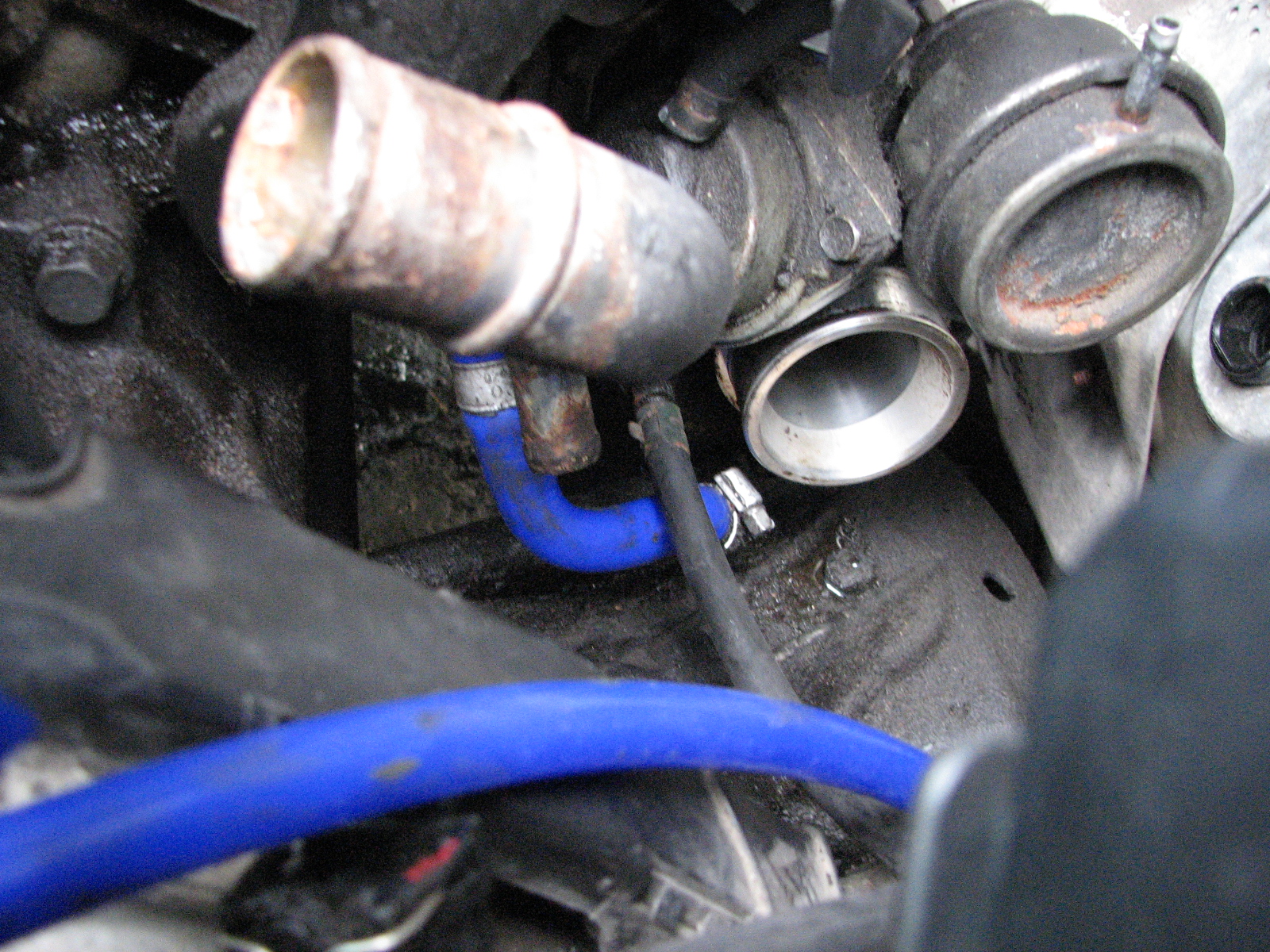

Severely bloated and soft Turbo coolant return hose.
This was an accident waiting to happen.
Glad to have that taken care of.
Yay, almost. I will change out the junction, Tubes, and Heater core at the same time.
Junction and tubes.
Junction and tubes.
Heater Core tubes.jpg (45.33 KiB) Viewed 6744 times
Everything is all buttoned up but I can still pull the pipes out of the junction at the firewall.
The rest of the work will be on the inside with the new heater core and tubes.
All buttoned up but not done.
Only wasted about a quart and a half of my special 50/50 mixture.

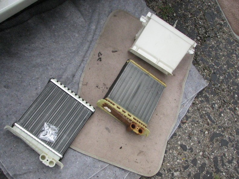

I received the parts Friday, installed on Sunday 9-14-14.
new stuff.
new stuff.

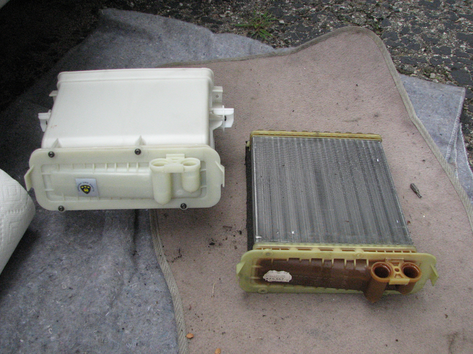

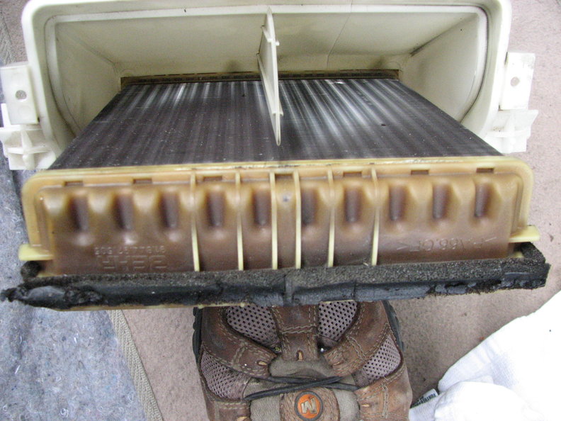

The old heater core was not leaking at all, just brown inside.
New an old.
New an old.
Old core, no leaks.
Old core, no leaks.
I didn't have time to wash the new core, but it doesn't smell unbearably bad.

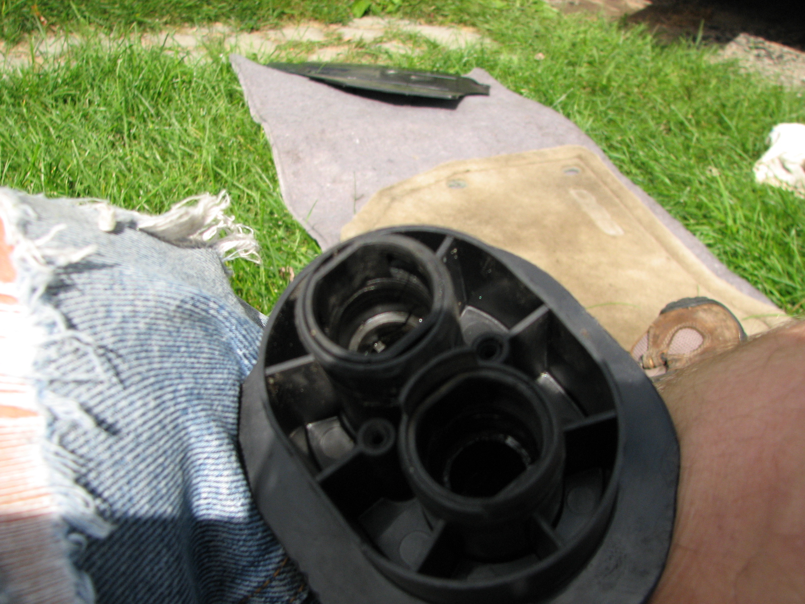

The Junction piece at the firewall is a puzzle to get around the gas pedal and cable on an 850, while getting it out from behind the A/C evaporator box.
The crack can be seen in the sun lit area.
It was indeed cracked from when I removed the old hoses, hence the pouring leak. The black plastic is very brittle.
Glad to say it is all buttoned up and holding fluid.

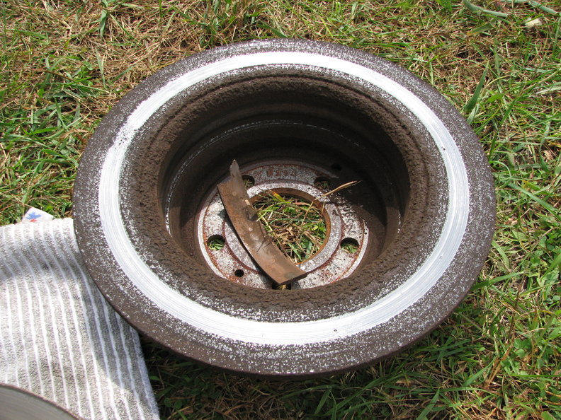

Rear brakes, rotors, e-brake shoes, pads. It was a scary mess back there.
This was not the original plan.
filled with shoe on both sides. Better now.

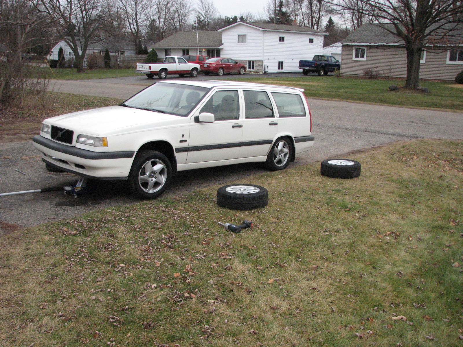

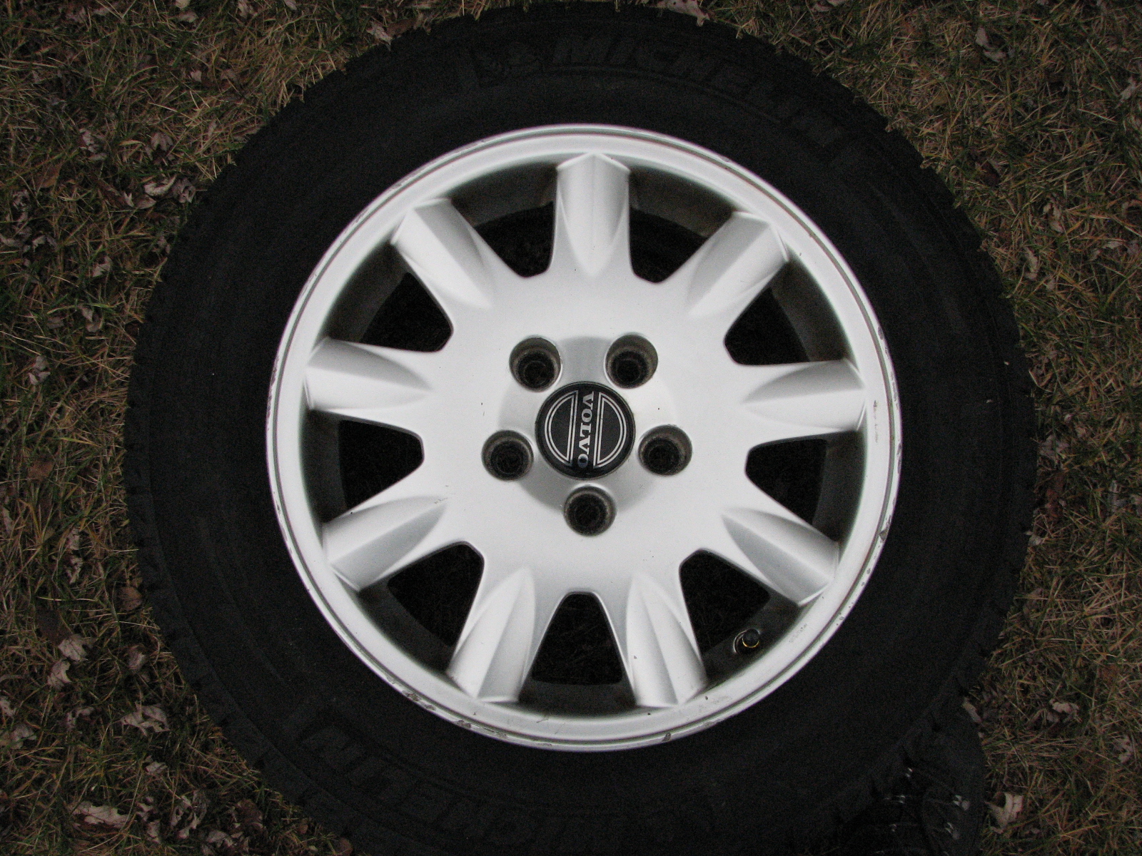

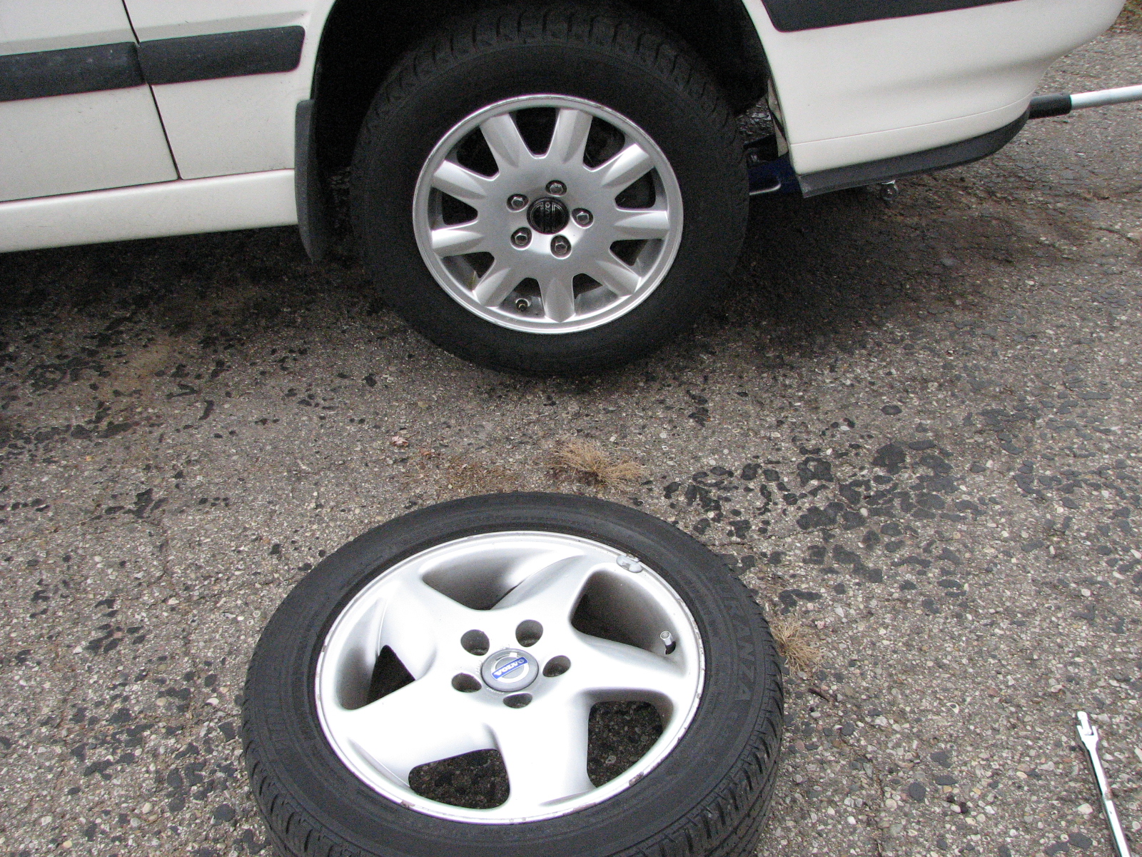

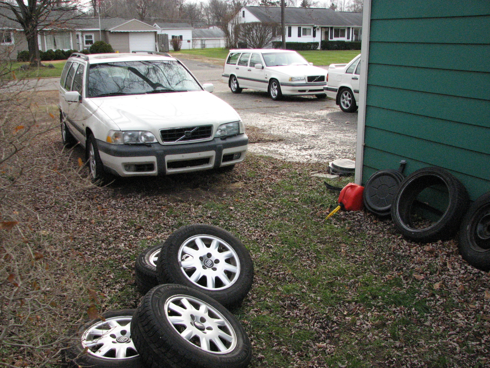

I put on the winter wheels with Michelin snows I found on craigslist for a good deal.
This looks like the last week I would want to do much to the "fleet" without a garage.
The '93 Sedan worked well for the last two winters without snows. Last year we had a record total snowfall here in Michigan.
The '96 Wagon is this years winter driver. Everything seems to be working as it should.
Everything having to do with the coolant system is new.

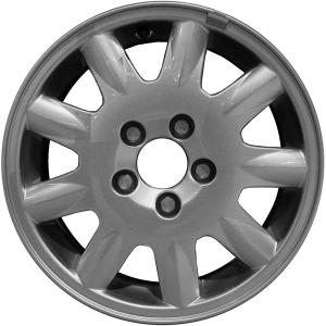

I found the name of that wheel again. Lysithea.
Like new Michelin Snows.
Lysithea is the name of the wheel.
I would have used the XC for the winter. It needs evap. work.
Columba wheels go to storage.
Until next year.
Until next year.
I can live with that look for the winter.
After a short drive, the 15" wheels with new snows feel like a luxury ride compared to the slightly used 16" tires on the Columba wheels.

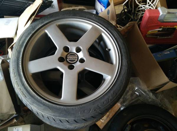

I also picked up a set of original '95 T-5R Titans in great shape that will likely go on the Wagon in the spring.
The 16" rims are a harsh ride as it is. I hope the tax goes through to repair Michigan roads or I may not enjoy the 17" Titans.
!995 T-5R Titan
!995 T-5R Titan
I have these on my T-5R of course being a '95.
Actually I had put them in storage today.
New wheels coming..jpg (37.95 KiB) Viewed 6546 times
I found a set locally for a good price in very good shape for the Wagon maybe, or possibly The '93 Sedan after I do its 5-lug conversion.

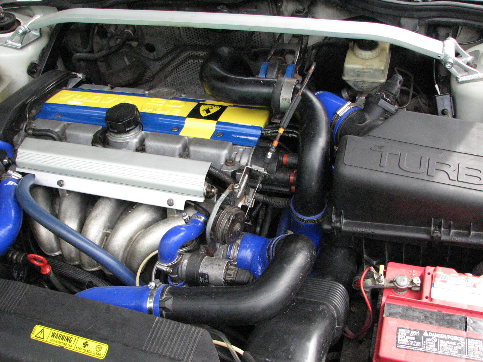

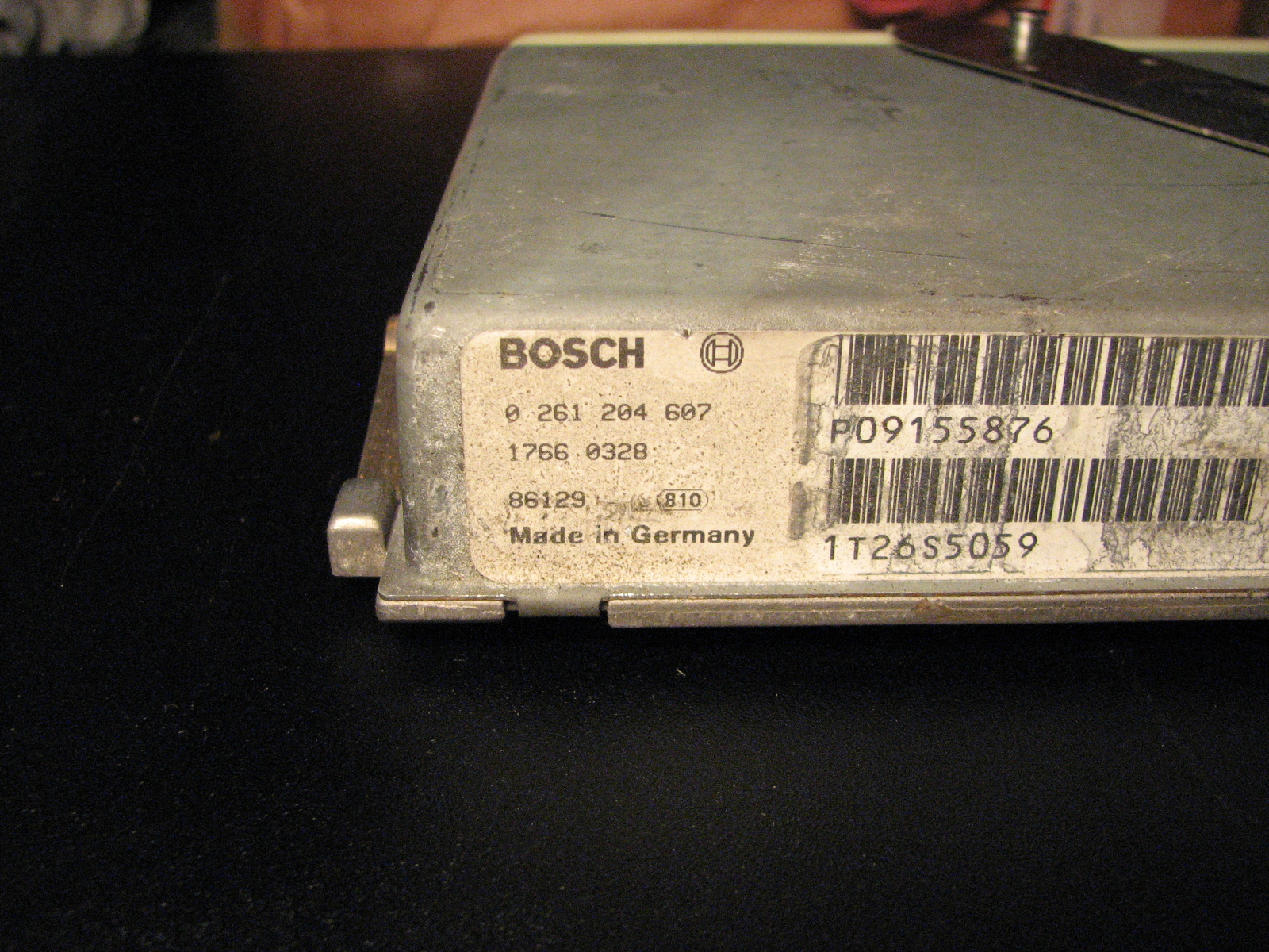

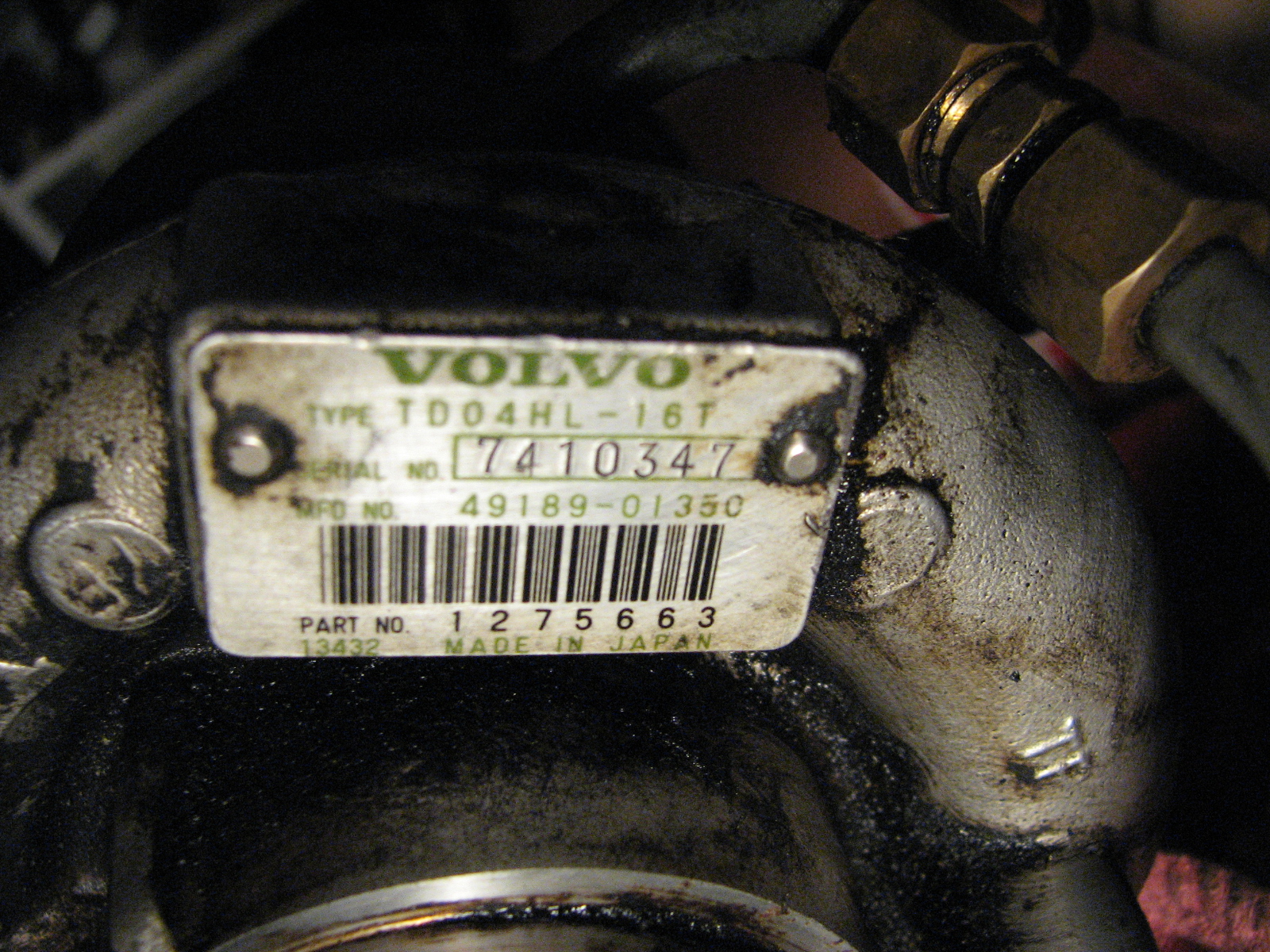

In an earlier post in this thread, I had mentioned a 16T, as well as the R exhaust manifold.
I now seem to have a feeling to step up to the plate.
I had never expected to come across all the parts to do it.
This ECU may go to the new XC because it is from a '98 T5.
16T with no play spins freely.

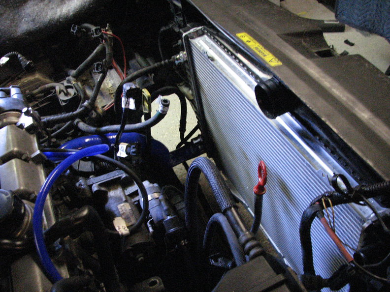

In my haste to bolt the new radiator in last year, I think I had neglected to change the O- rings to the Trans cooler lines. Although I had used new clips.
Yeah. There.
Yeah. There.
Things were moving fast, garage time was limited.
Bottom line is, the lower connection now has a leak. Easy ten minute fix, I had the O-rings on hand, just didn't change them.
