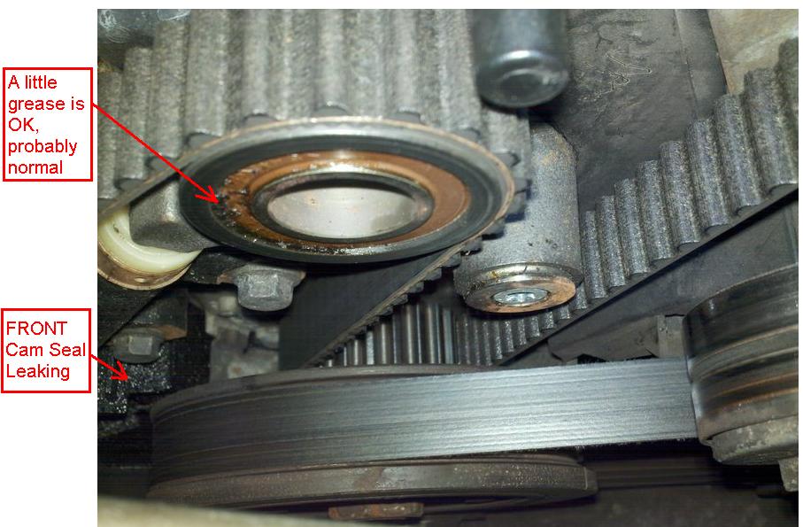

Anyway, I put some caption on the original photo for future readers.
- The little grease on the pulley is "normal".
- The oil collecting at the bottom of the TB compartment is from:
a. Either FRONT cam seals leaking or
b. The Valve Cover area (bad oil filler gasket or broken PCV hose).

bearings for the auto industry ? If so there should be no more need for discussion or debate . Please tell me you were not kidding . That oil leak in the bottom of the timing cover is probably coming out at the exhaust manifold gasket via the turbochargers internal seals . I know that sounds strange but believe me I have looked a lot and that is really the first place it originates from when the oil starts to come out . The area was repeatedly wipe down to see where it was first coming out and my old mechanic told me turbocharger seals can actually do this sometimes . It didn't make sense to me at first either but I checked it repeatedly . The longer I use full synthetic the more this leak decreases . It used to be much worse about a year ago .
