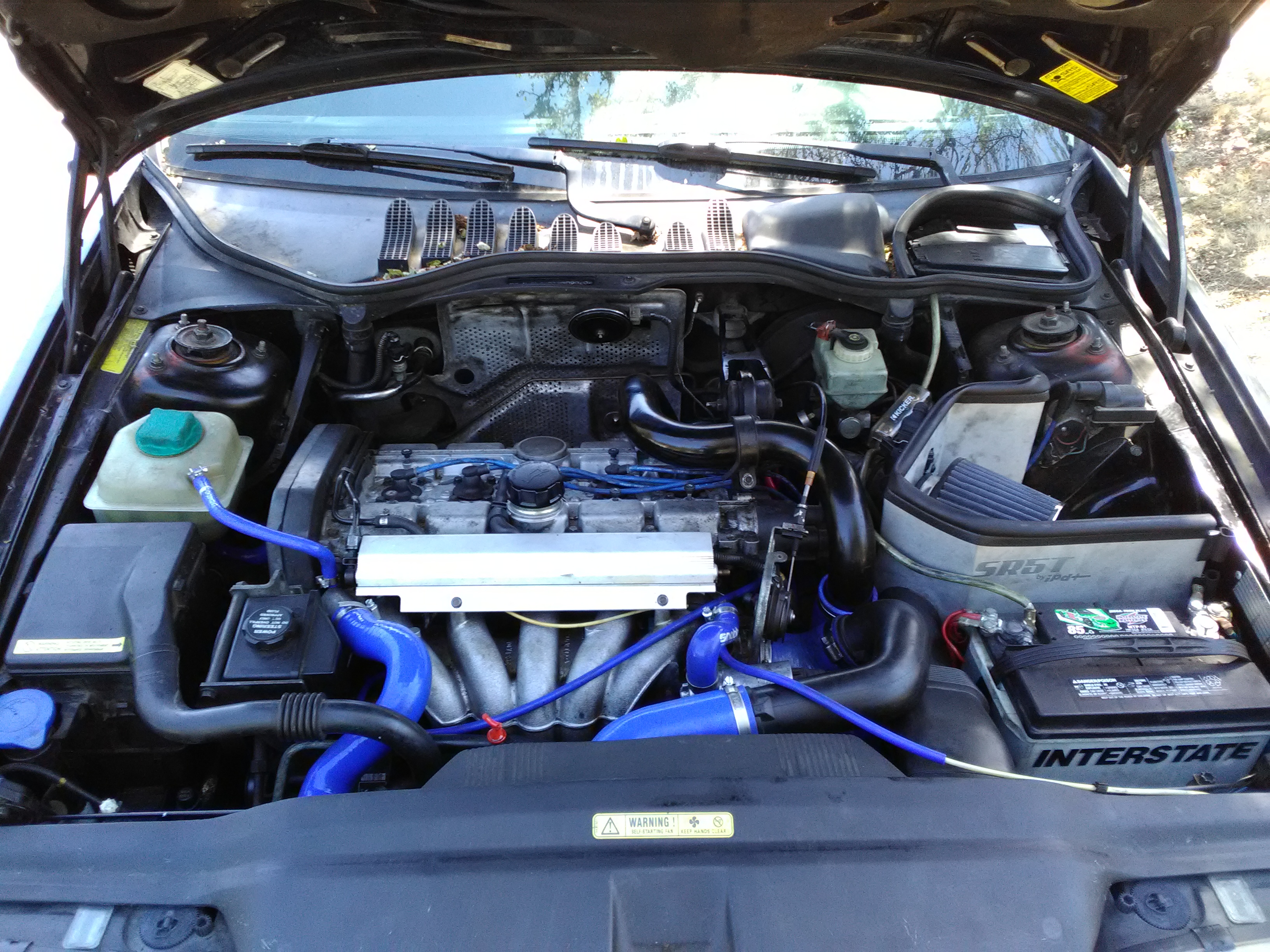

Thanks for all the advice guys! I've recently been working on my R as I have days off and have done quite a bit since I last posted. I have been using 93+ octane since and no more knocking or stuttering. Here's what I've done so far:
- New radiator and silicone hoses from Do88
- New HDTCV from IPd and silicone vacuum lines
- New silicone hoses for inter cooler
- Replaced the PCV's vacuum line with a 5mm ID silicone one and ran it outside the manifold.
The current look.
Still need to get the brass elbows and the wider hose for the PCV and I don't have a drill, so I'll need to rent one. Also, could I drill out the ptc to 1/2" or 5/8" or is that too wide?
No more oil leaks so far from anywhere. I seem to have gotten rid of the smoke at startup. Even after sitting for a few days since the new TCV and fresh IC hoses, although my exhaust still has a black film on the inside at the tip and I'm imagining it goes all the way up. Would this affect my emissions? I still seem to be getting 22-28 in the city per my dash readout.
