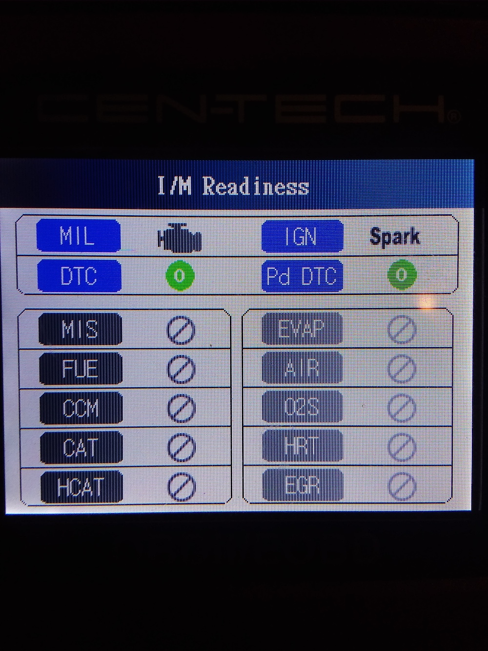

Well I finally pulled this one off the back row and it's back in the shop. Still no spark and still looking for the reason. (tried multiple cam and crank sensors last time). I did a sensor ready test with my obd2 scanner and all show grey on the screen. They don't show 'not ready' or 'ready', just grey like not there. I swapped another ECU from the same model and year and all I could get was 'failure to connect', so I put the other one back in.

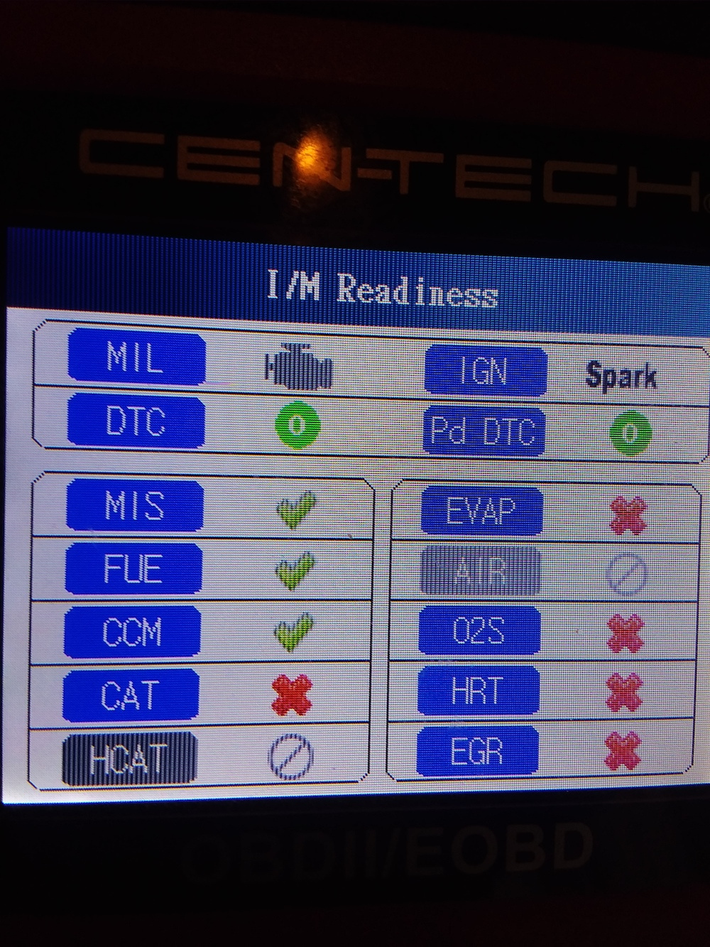

I think I did but it has been so long that I'll try another one, Thanks. Here's a picture of the scanner on a different car when I do a ready test and also what it shows on this one. You can see in the second pic that the reader simply sees nothing there on the individual sensors.tardcart wrote: 30 Jun 2019, 20:02 with the blinking arrow, Ive heard a bad transmission computer will disable the ignition. Try swapping the trans computer.
UPDATE: I just replaced the fuel pump relay above the radiator and scanner behaves normally now, though still no spark.
