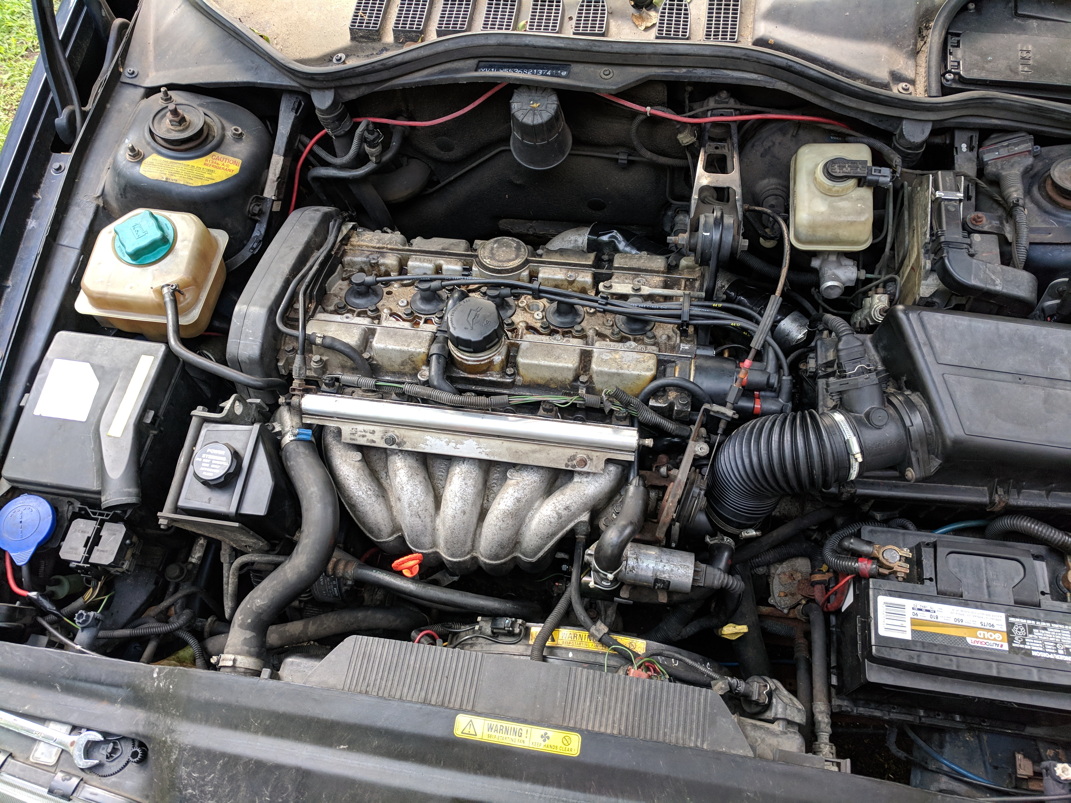

Just put everything back in nice and snug to the best of my abilities. Even got the other 2 head bolts to go in.
But still. No. Sparks.
What now?
If anyone wants to check my work, \/
What now?

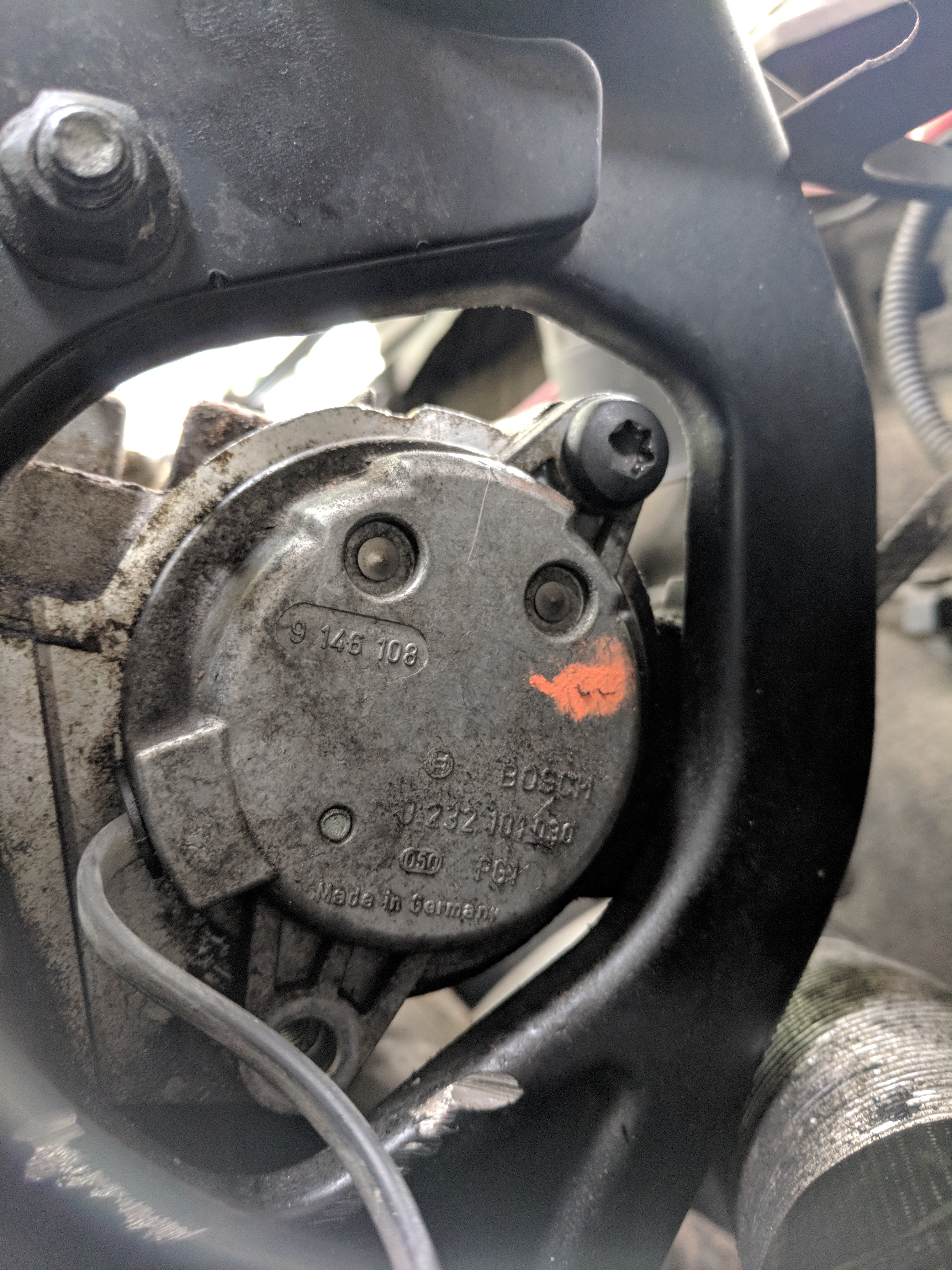

Take a picture of cam sensor cover post pic here. Double check it's plugged in

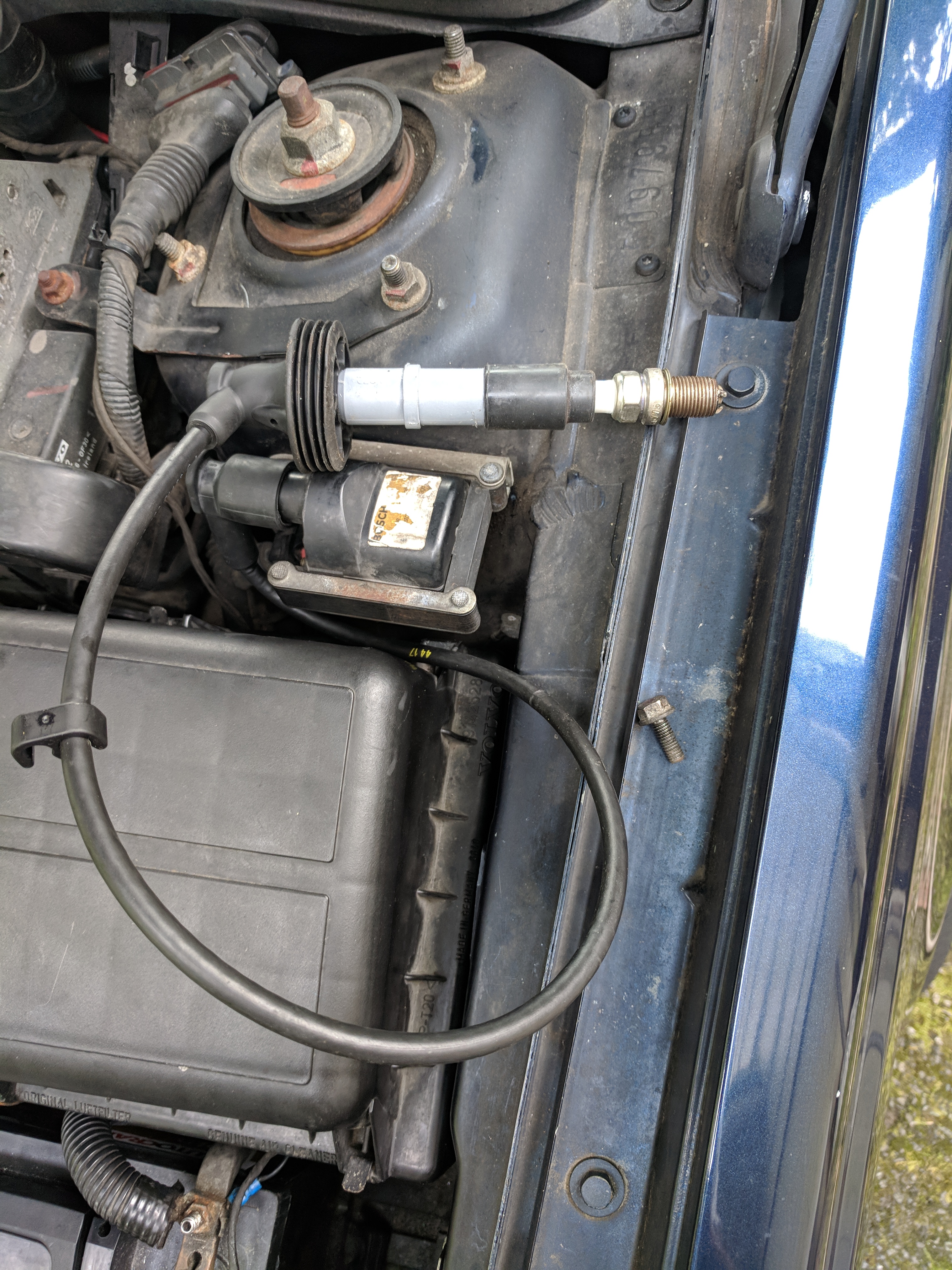

Remove a sparkplug, remove a sparkplug wire from distributor. disconnect fuel injector from the open cylinder you removed the sparkplug from for safety. Plug the sparkplug wire directly into the coil and connect the sparkplug into the end of the sparkplug wire. Are you getting a spark on the sparkplug?

If you have 12V or battery voltage on the SECONDARY side of the coil on the thick wire, it is shorted to battery voltage and won't work.
Try a NEW coil - not one from a junkyard. If your money has been stolen by my generation and Wells Fargo, lets finds someone nearby with a KNOWN good one.

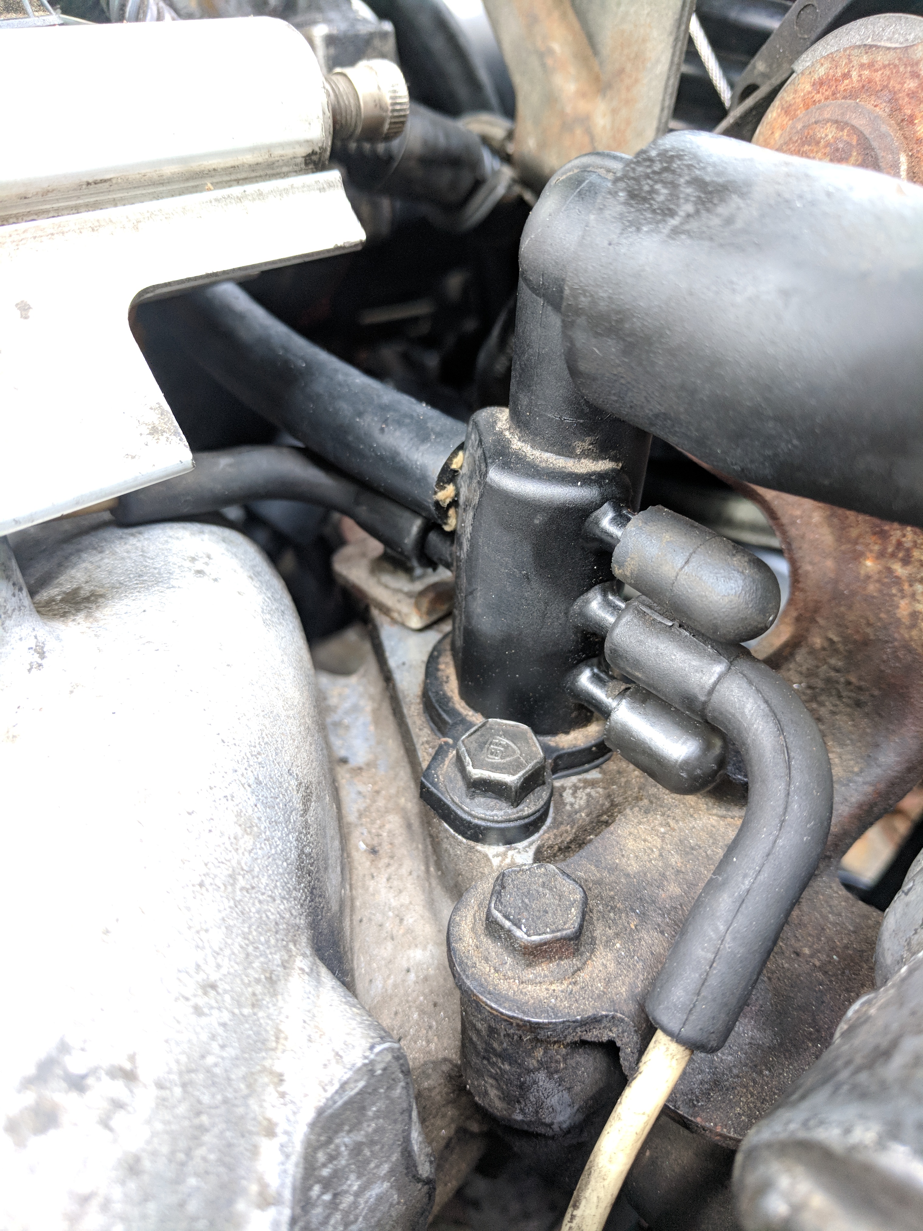

Also it looks like you haven't plugged in the fuel rails vacuum hose yet. I think I see it resting there on the intake manifold next to vacuum tree
Take pic of vacuum tree too

Cam sensor cover: (note that the bottom screw is missing, this is noted, but it also shouldn't stop the car from getting sparks, seeing as we removed it thinking it was the cause of the no-spark and thus had to grind the screw off)(Plus, the top screw is tight, I tried wiggling the sensor around, it's not going anywhere)
Unfortunately, my wallet doesn't allow me to buy a new coil, and nobody around me has a Volvo... (just a side note, you guys do know that I'm 17, right?)
Fuel rail vacuum is plugged in, I just tried to hide it to make it look nice :'(
