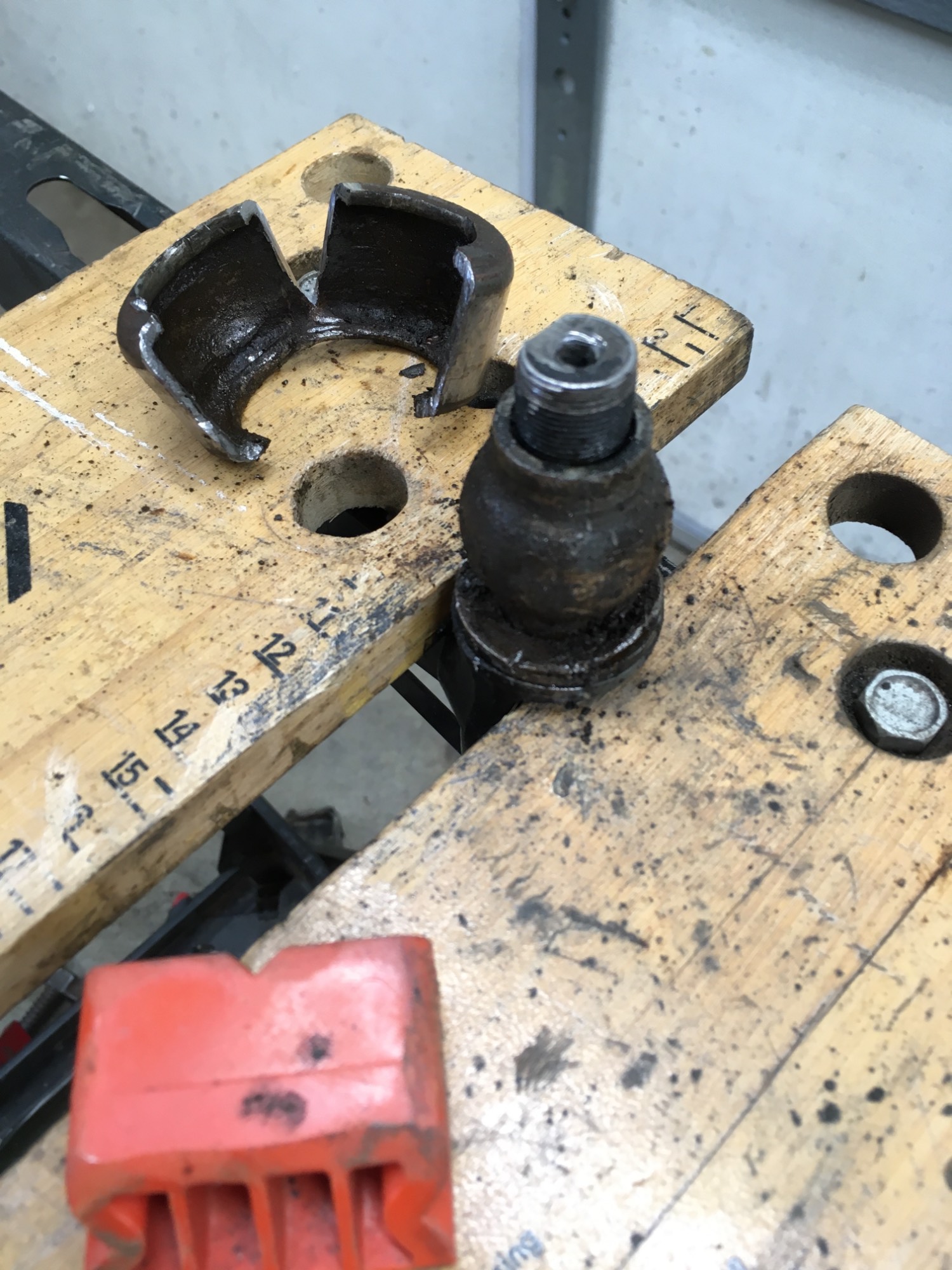

Disassembling my Alfa's LF suspension to rebuild. Control arm big bushings (spherical bearings really) hard to get out, but got them. But then one of those bearings is bonded onto the "dogbone" or structural piece that holds it all onto the cross member. Tried 3-jaw puller, big 3-jaw puller, four hands, lots of PB Blaster soaking.....nothing.

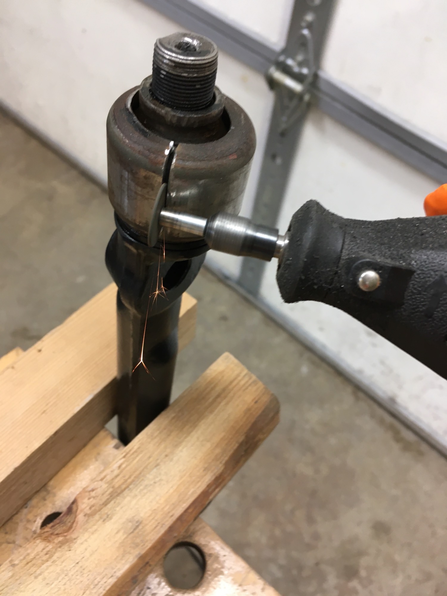

Last resort - cut it off.
Still wouldn't budge with two cuts. I chiseled on the two cut faces and it finally rotated a bit, and I could twist it off with a big channellock.

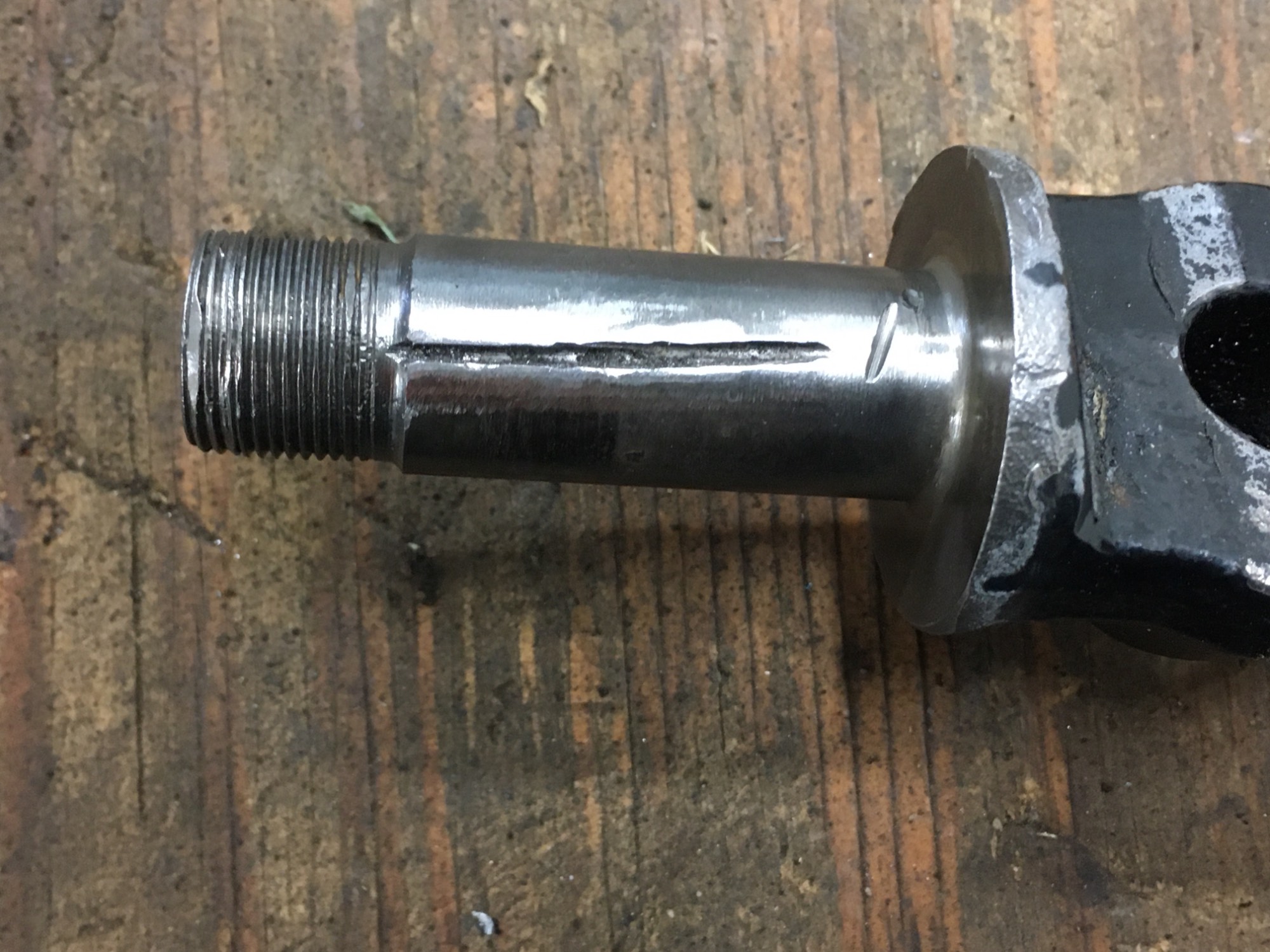

But it's hard to judge depth as your cutting wheel wears down, so I scored the spindle shaft, ugh. Could be in the blooper thread.
A couple of people say find a good used one. Another two say it's fine for a street car. Another says what about a stress crack starting? Another says what kind of steel alloy? Could you stitch-weld the crack and file it smooth? What about heat damage?
Another guy said Just use it, it's fine. I'm not sure what to do next.
Assembled lower control arms attached to the "dogbone" in question. The spindle shaft is 16mm diameter.

I vote with the "it's fine, just use it" guy. Why? It is not very deep. You are not racing. It has a radius at the bottom of the groove so is less likely to start a stress crack. The other 'repairs' may make the problem worse.

It really bugs me to damage really old parts, especially if I could have prevented it by being smarter. These are out there in people's hoards I assume, but not very many of them. Then you see where I took one whack with a ball-peen at the top of the spindle with the nut barely on, and mangled some threads? Now I need to find an M16 x 1.00mm pitch die chaser that's not made in China.

Use a fine triangle file to clean up the threads. Slow, patient work with satisfaction when the nut fits again.

Nice job getting that off ! And I agree - don't worry about the shaft. Being a bit anal myself, I'd probably put some JB Weld or equivalent in that cut and smooth it out. Just because....
And they make thread chasing files. I have one around. Square with maybe 8 different thread pitches on it. It has saved my *** on more than one occasion.

Fill in groove with JB Weld and check in 20 years

There’s no movement at this joint, it’s a fixed bushing, so smoothness isn’t as important as strength.
