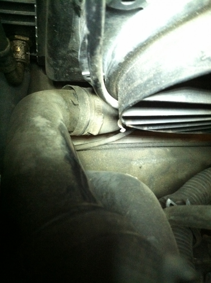

Dove into the No-Boost issue on the T5, disassembled the left side of the engine bay, all the while wondering how I could afford a new turbo control valve in my present circumstances. I was so distracted by the Worry Video going on in my head it took a while to spot this:

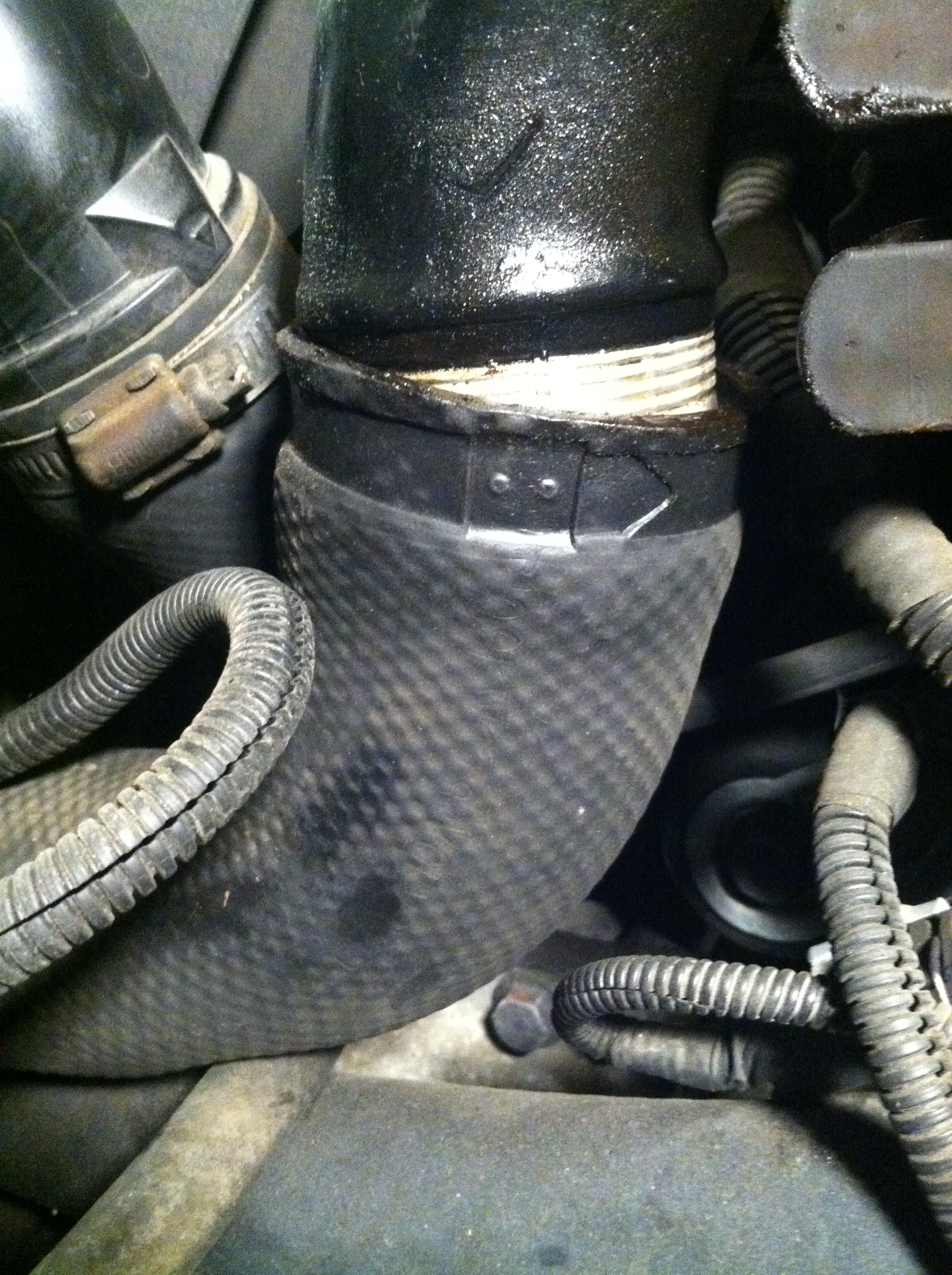

The spare clamp was conveniently stored lower on the pipe:

Yep, that'll cause some boost issues! Glad it was a free and easy fix!
