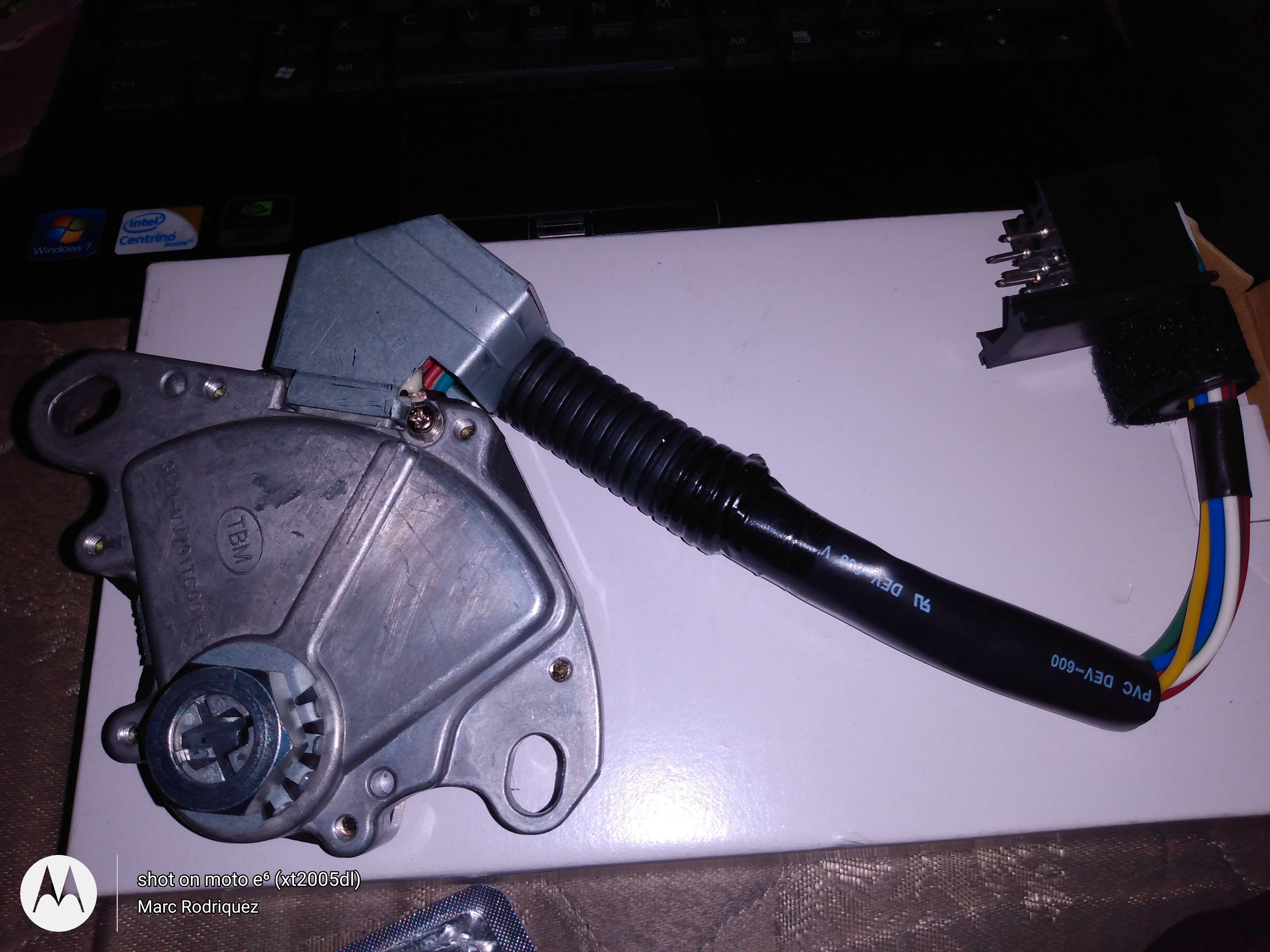

Yes, I did. Also the starter is new and all cables and connectors along with terminal ends are in good shape with no cracked insulation which is a surprise.RickHaleParker wrote: 01 Jun 2021, 17:22Have you checked and cleaned the battery terminals? Starter cable connections ?mdr1220 wrote: 31 May 2021, 13:24 I did the shifting back forth and only got a slight cough from the engine when I turned the key.

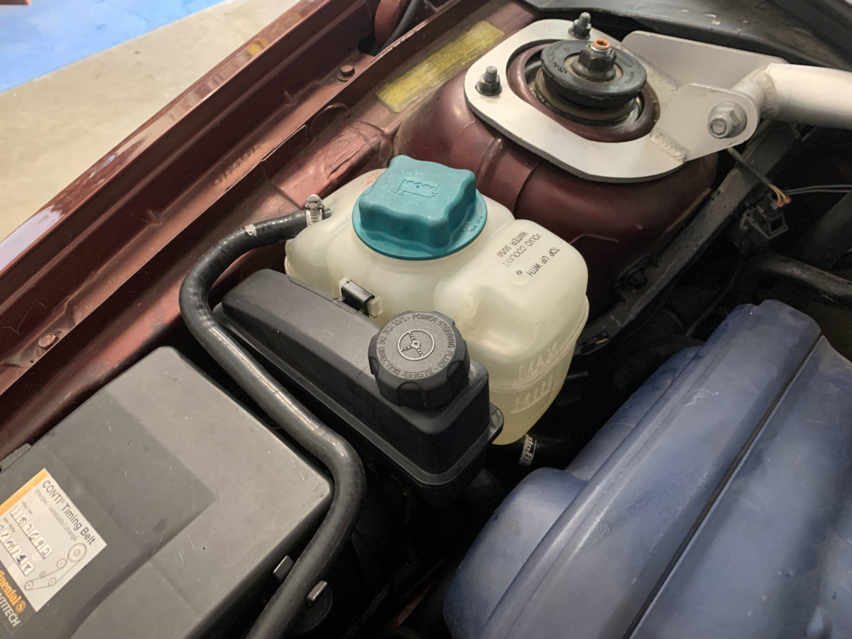

Replaced my expansion tank yesterday. Fortunately I had this much newer one sitting on the shelf, since my old one finally sprung a tiny leak from a crack in the top last week. Well, I noticed last week... it’s probably been leaking for a little while.
The water in there is temporary, I need to flush the cooling system out. There’s still traces of stop leak from the previous owner... from YEARS ago.

Grossbmdubya1198 wrote: 04 Jun 2021, 21:46 The water in there is temporary, I need to flush the cooling system out. There’s still traces of stop leak from the previous owner... from YEARS ago.

Yup! I hate that stuff with a passion.ZionXIX wrote: 04 Jun 2021, 22:46Grossbmdubya1198 wrote: 04 Jun 2021, 21:46 The water in there is temporary, I need to flush the cooling system out. There’s still traces of stop leak from the previous owner... from YEARS ago.![]()
