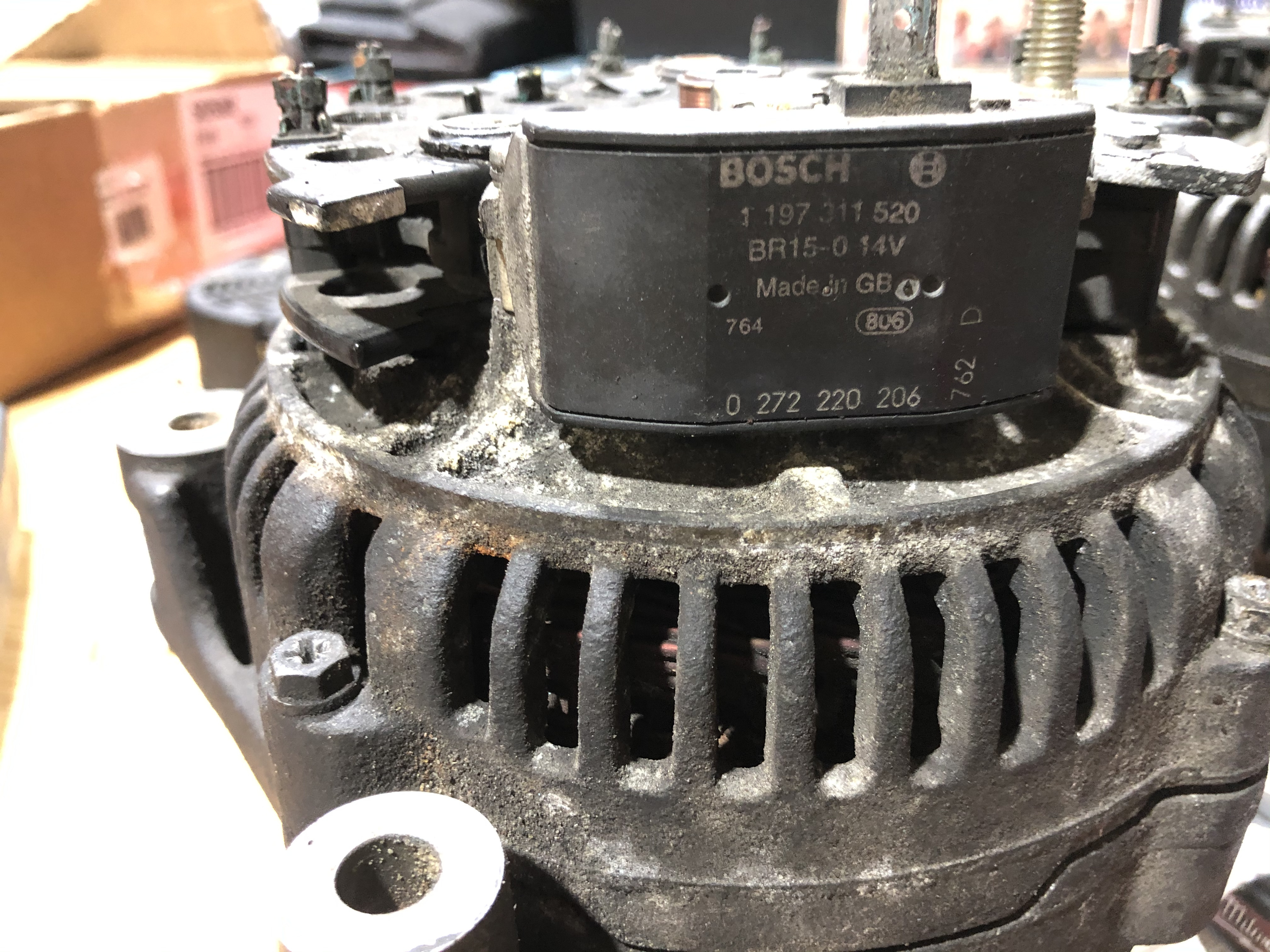

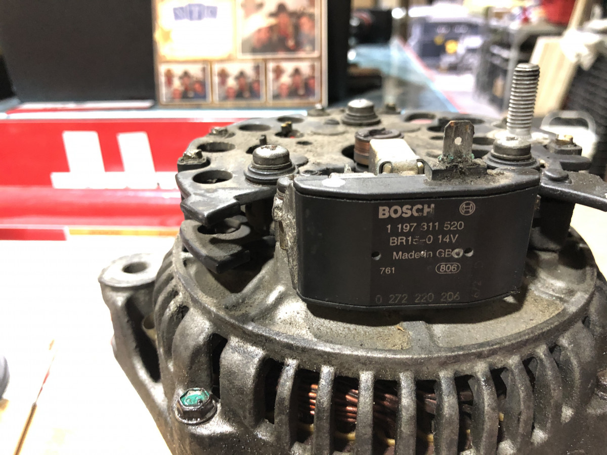

Grabbed a spare alternator to find its bearing make even more noise then the original. I did swap the voltage regulator which fixed issues with charging. It almost looked like the one I changed out was a counterfeit Bosch. Look at the stamp marks

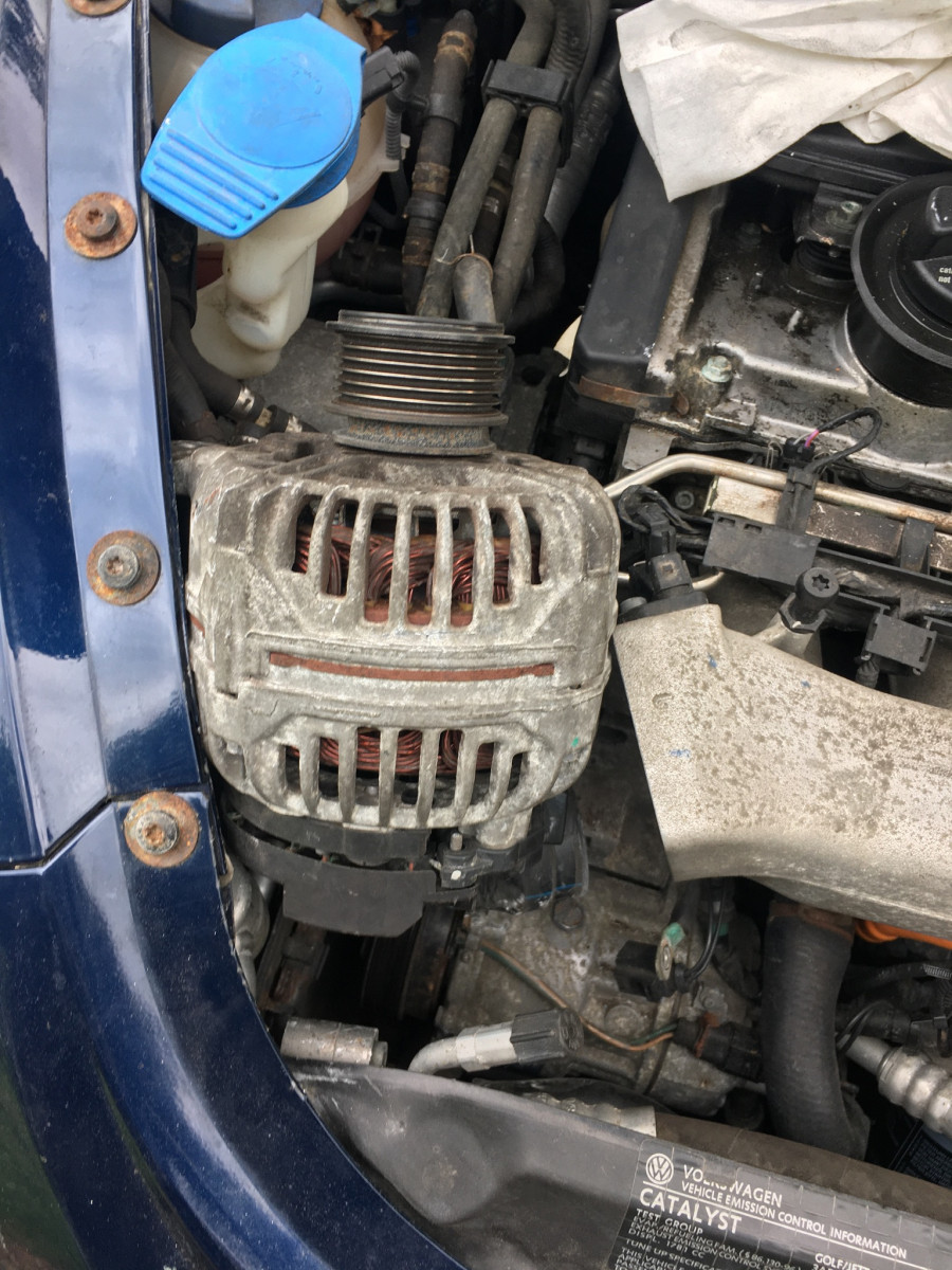

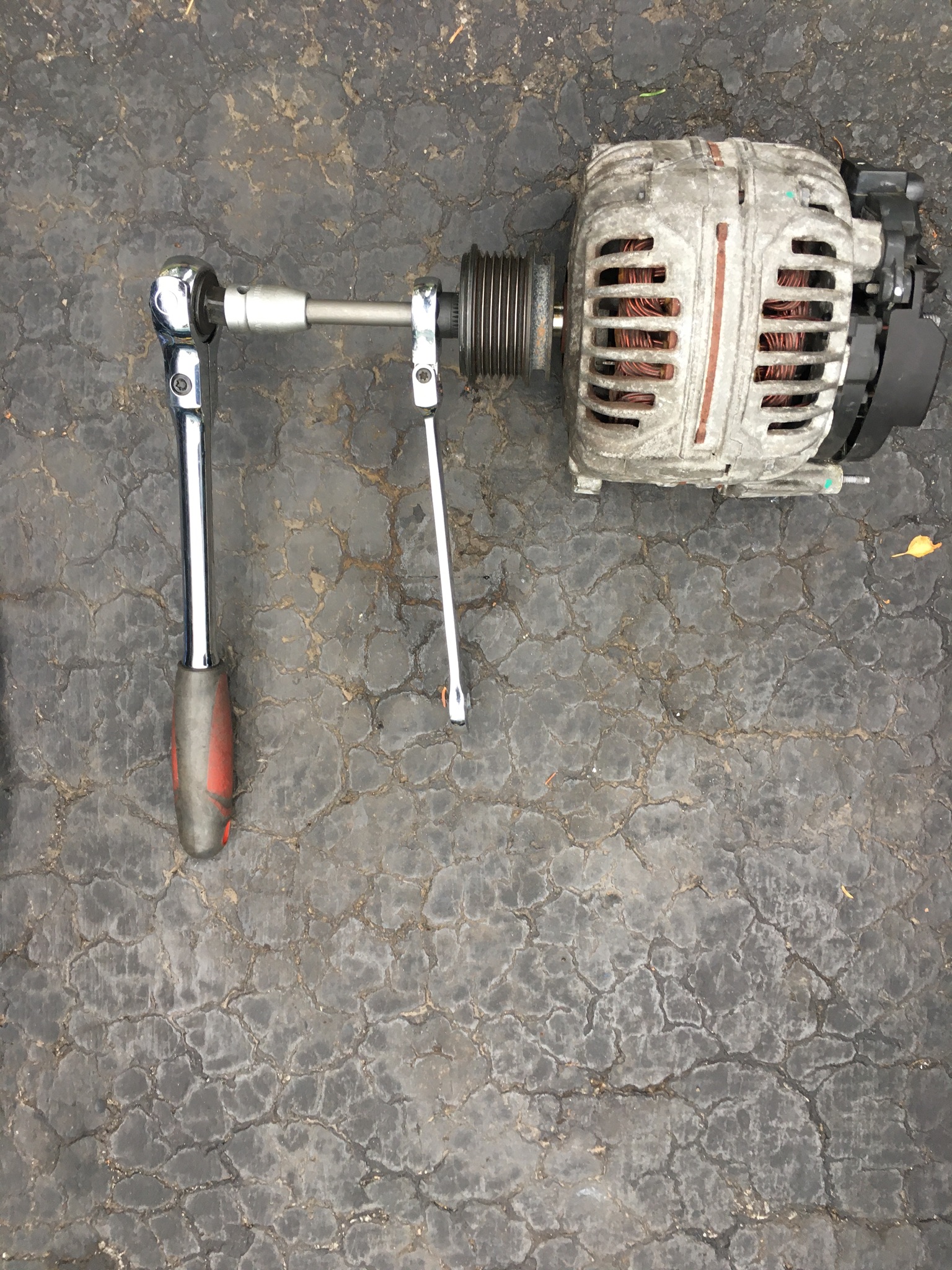

I begged forgiveness from the Creator for complaining about Volvoalternator Tetris after having to extract an alternator from Juliette, the TurboManBeetle
This was the worst case of access I’ve had in decades of memory.
