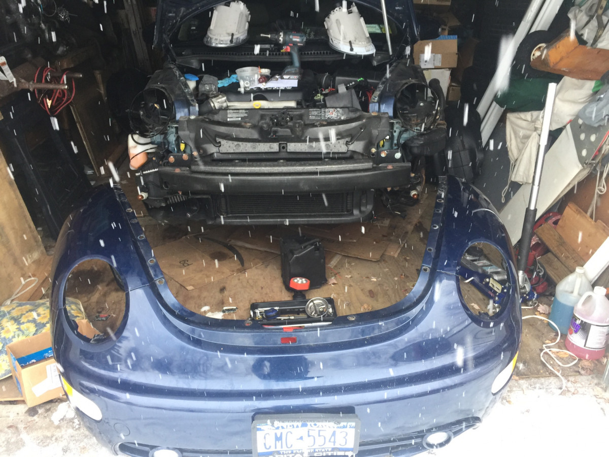

The "easy" way to do that would probably be to put it in "service position" and remove the whole front end. Simple!

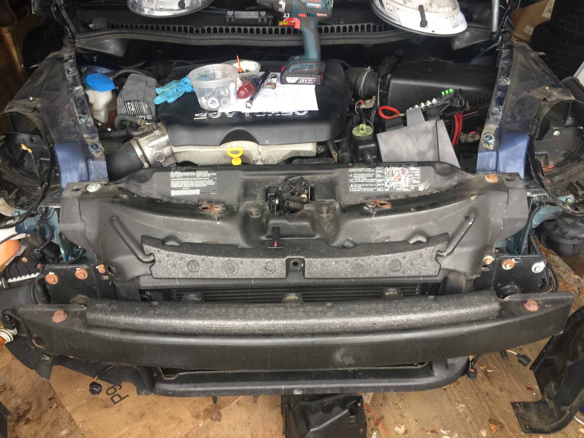

bmdubya1198 wrote: ↑23 Jun 2021, 09:54 The "easy" way to do that would probably be to put it in "service position" and remove the whole front end. Simple!
Welp!

Well at least they make it somewhat easy, everything looks to be removed in one piece.

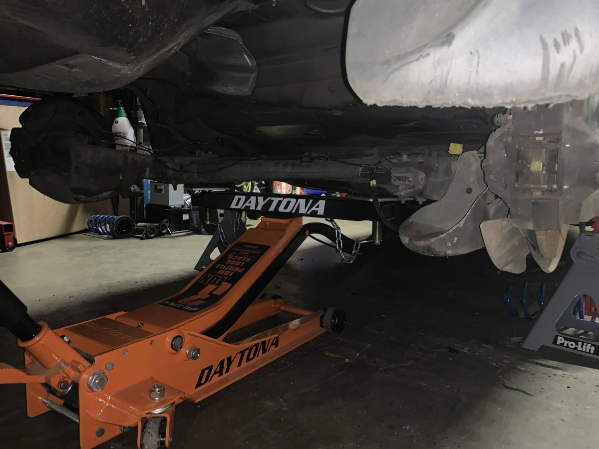

Hey, I'm doing that now! Except I'm not putting the AWD subframe back in...
Exhaust came down yesterday, now today I'm hoping to be able to finish the job now that I have a second and third set of hands at my disposal. The only thing I may have to get from the JY is the fuel line from the filter to the engine bay, I just want to confirm the regulator setup I'll need. Of course, the '98 line I have will not work due to the different connection at the engine, as well as a totally different regulator. Fortunately, I have a FWD 2000 turbo on my driveway that I can check out to see what I need. There's a '99 Denso car at the yard right now (actually was my cousin's old S70, the guy he sold it to appeared to have wrecked it) but I'm not sure if the regulator is the same on NA and turbos for '99-'00.
I'll try to take some pics of the delta link swap process and put that in its own thread, but I have a habit of forgetting pics.

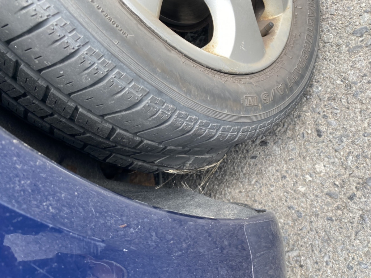

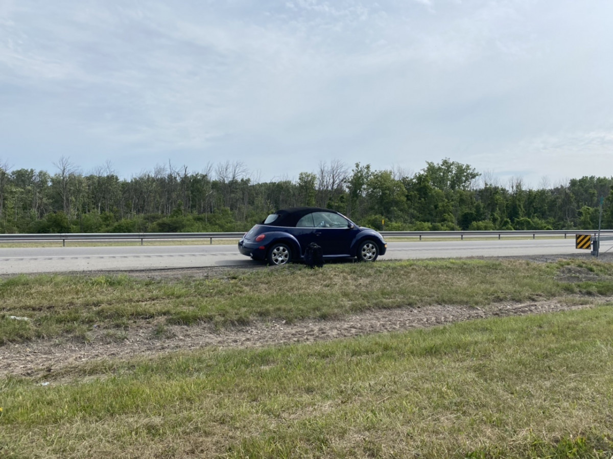

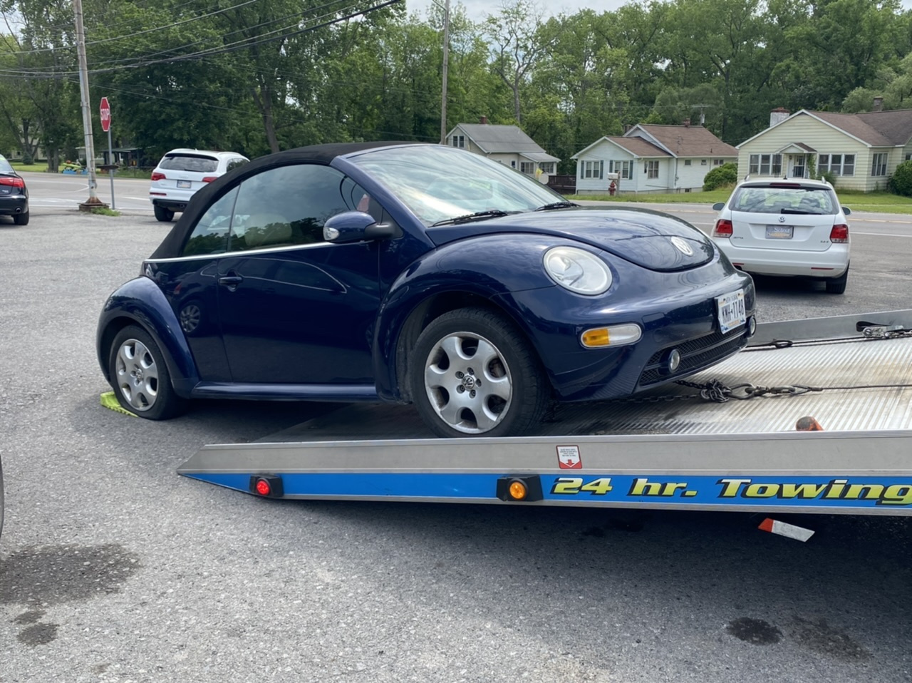

Enjoyed a recovery ride with Caitlin after my ManBeetle had its first flat bed tow in its history. Actually , my first flat bed tow in history!

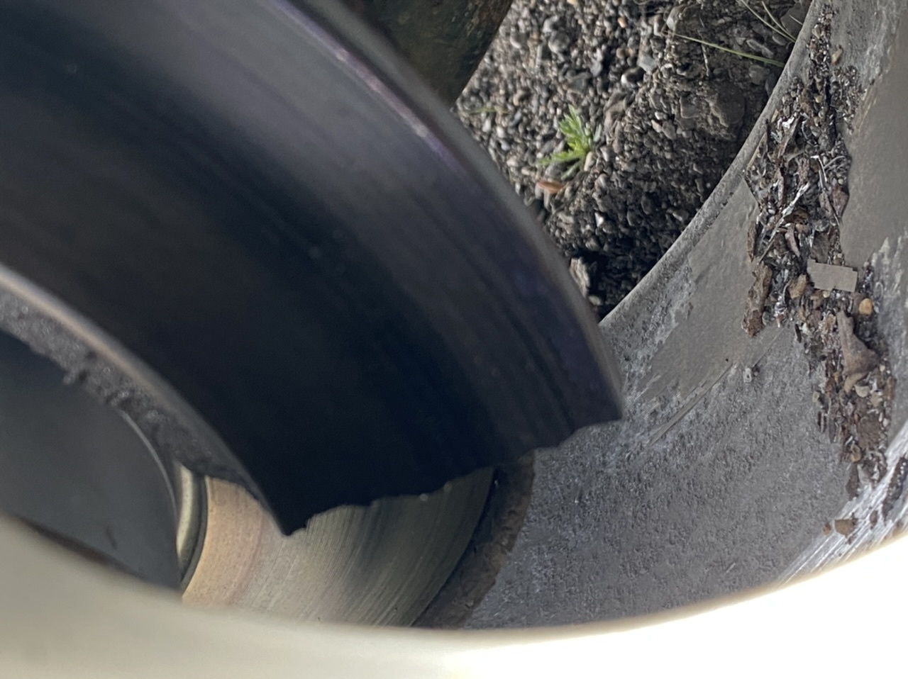

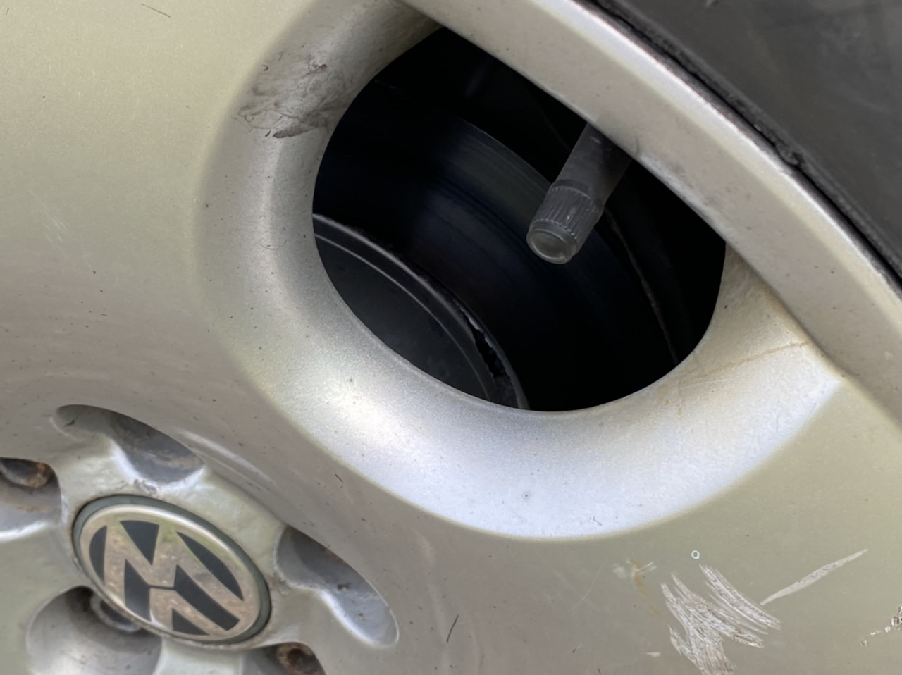

Post Mortem to follow , but I think the Creator sent Saint Humility to slap my face on my rear brake job last month on this car. I had trouble with two of the caliper bolts, and got the wrong ones, and used alternate hardware.
I’m guessing one of the calipers got loose, snagged the alloy, locked the wheel up at 75 mph, took out the brake rotor, alloy, tire, a piece of rotor flew over and took put the other tire.
I felt a slight Rear vibration in Buffalo 70 miles earlier which suddenly got worse, then 10 seconds later , BOOM!
So trip report.
Buffalo at 0700 mile 420
Roadside mile 370
Picked up by AAA 0830
Dropped car at SELECT euro vw in Waterloo, NY by 0930

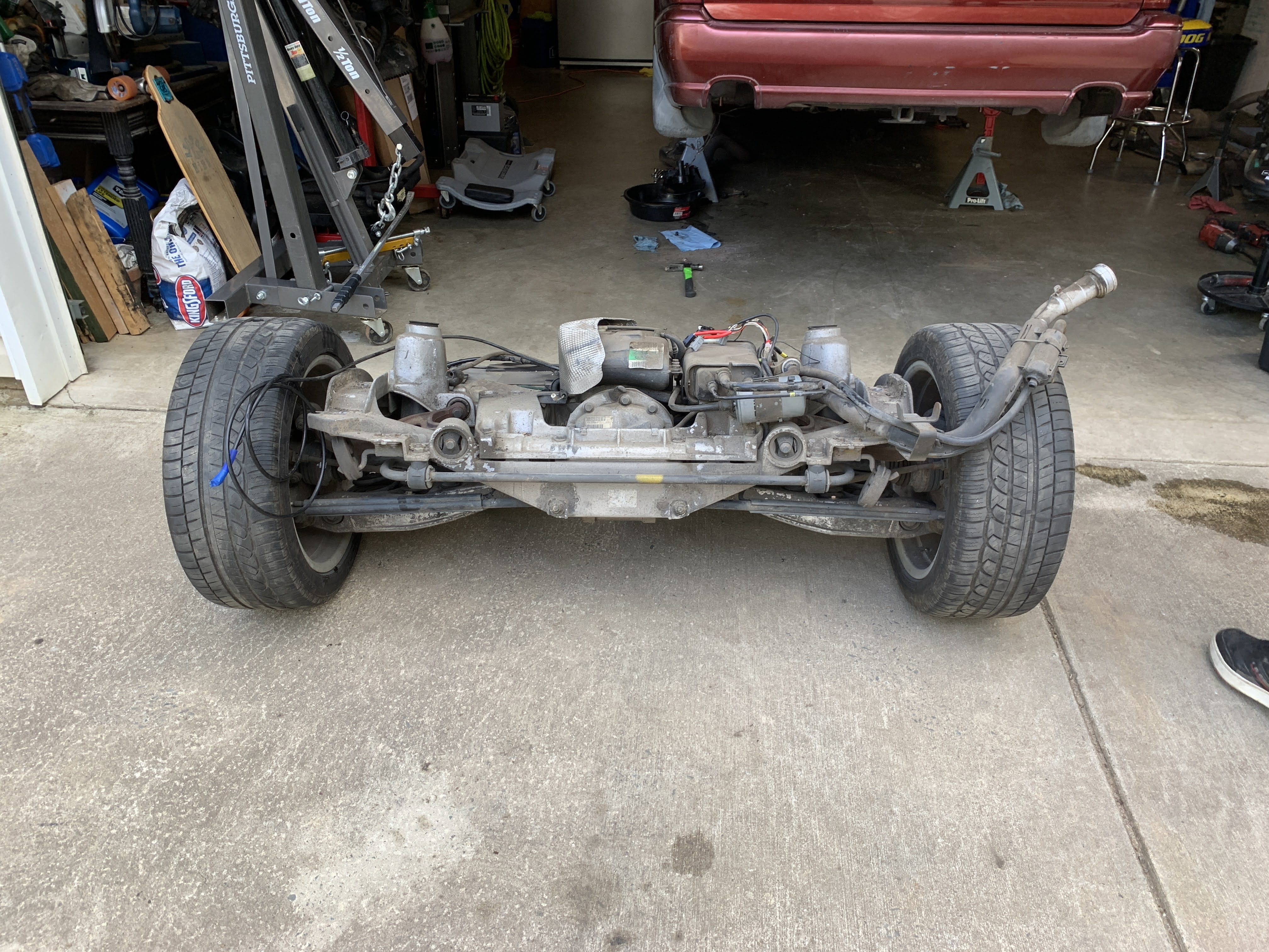

Speaking of eventful, the multilink rear end is out. Delta link is mounted, and I'm happy to report everything lines up perfectly, and they do in fact share some mounting locations. So far, the ONLY thing that will not be able to be used is the heat shield that attaches to the body above the muffler. I'll come up with a temporary solution, since I'd like something there, but I plan to go with an aftermarket exhaust before too long, so that won't be a big deal.
