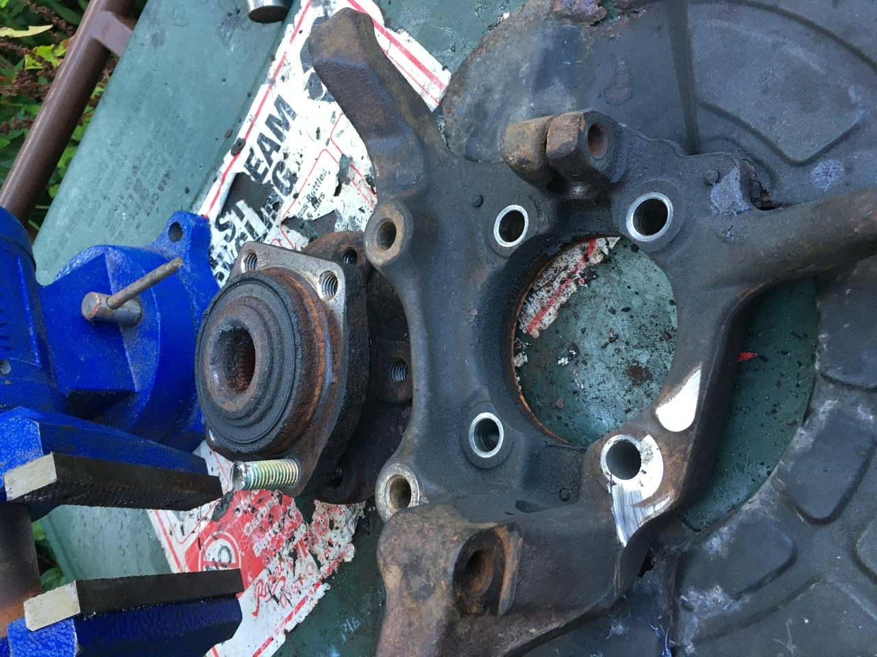

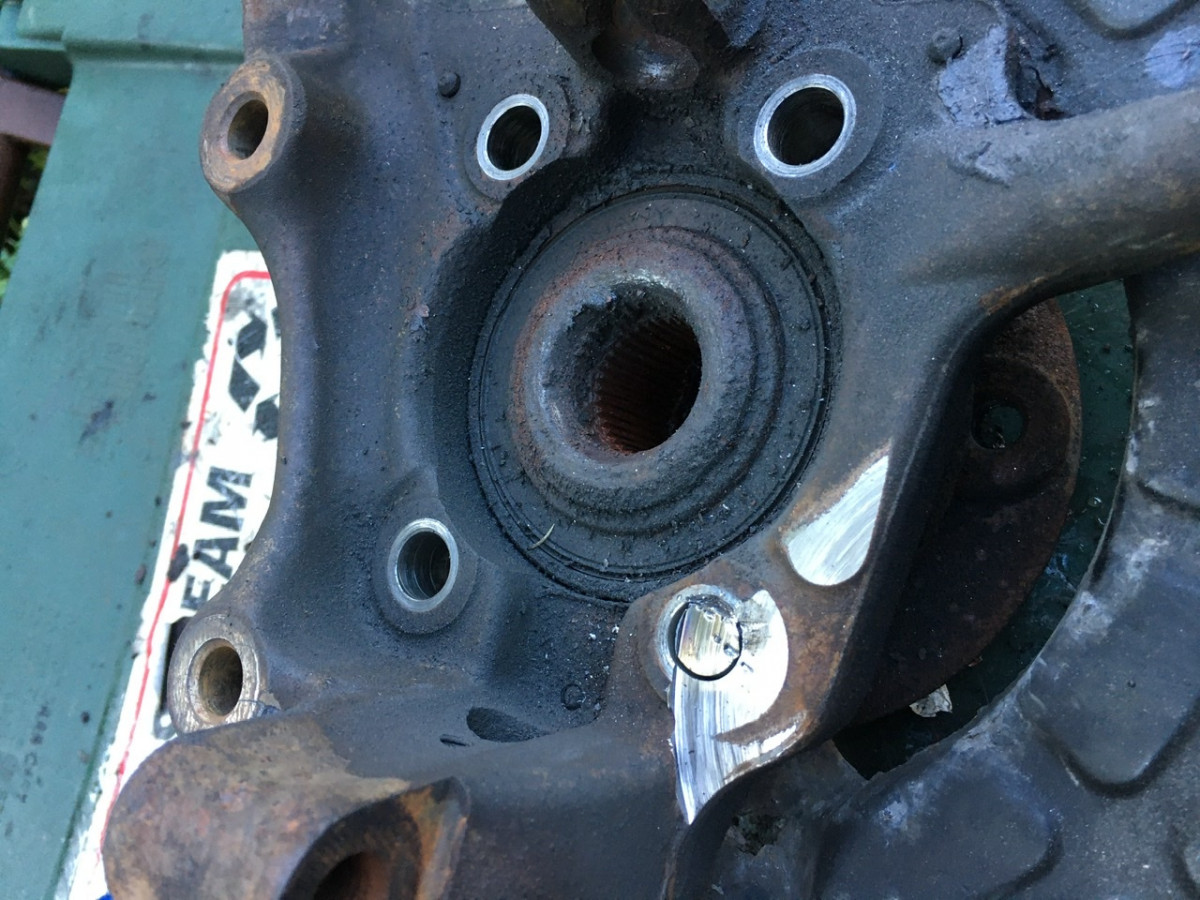

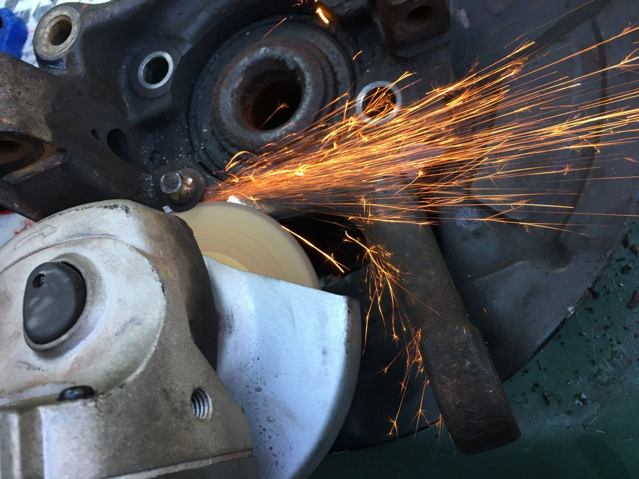

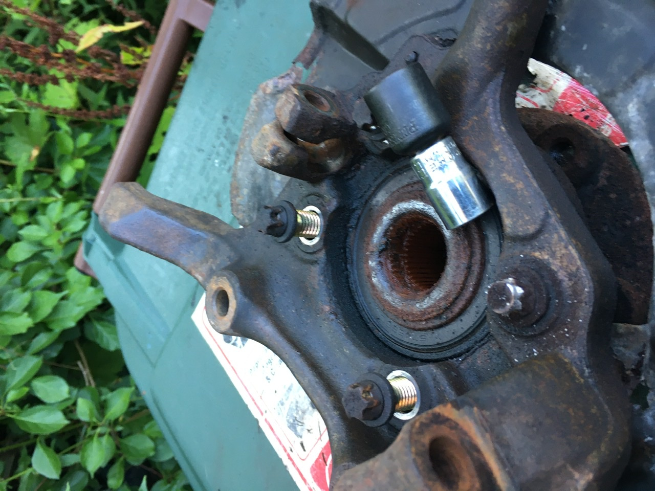

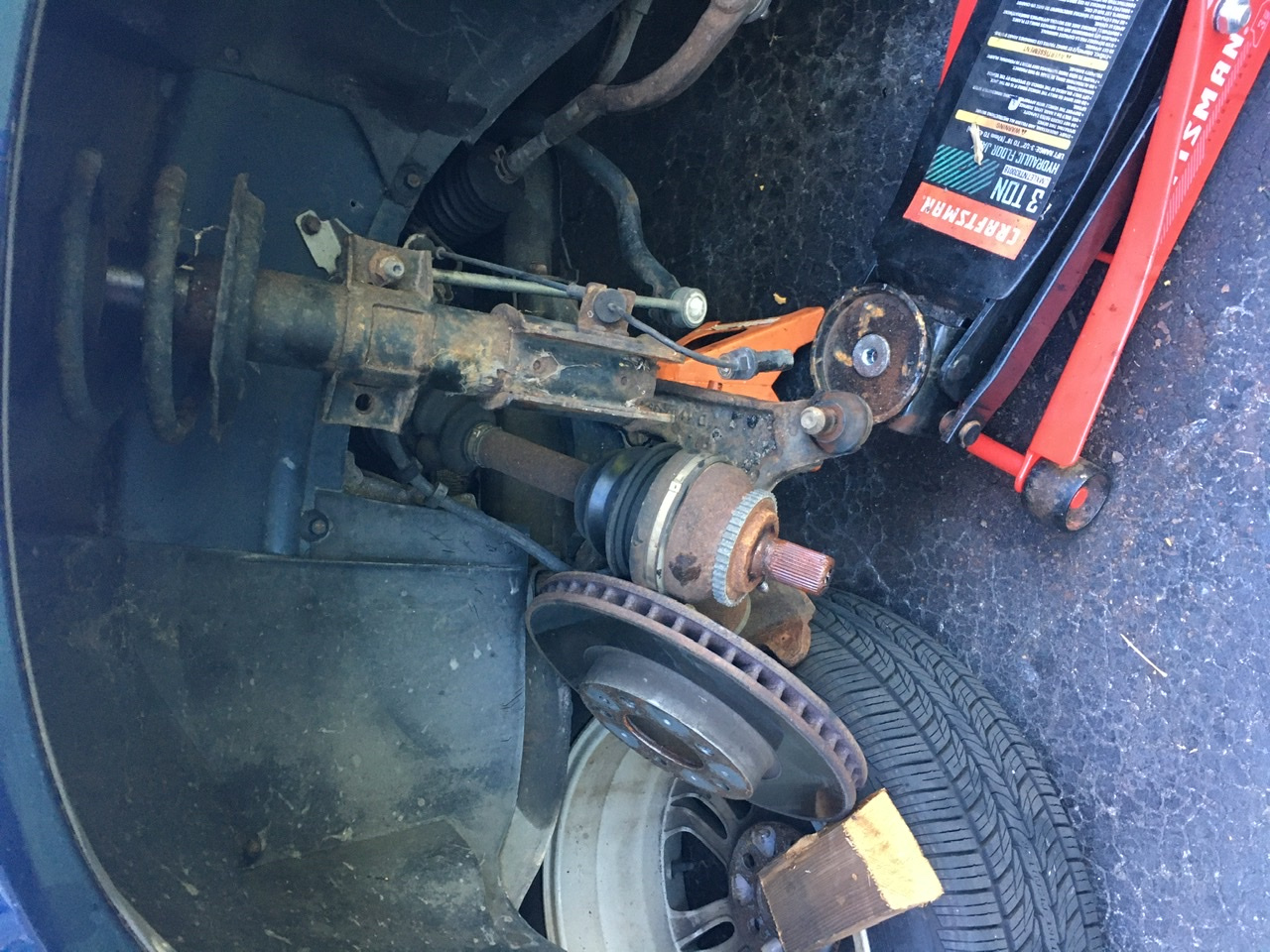

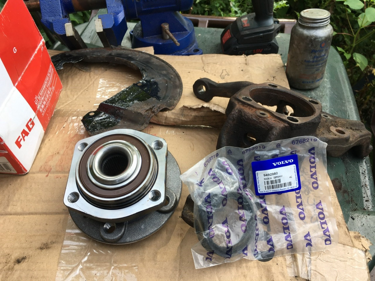

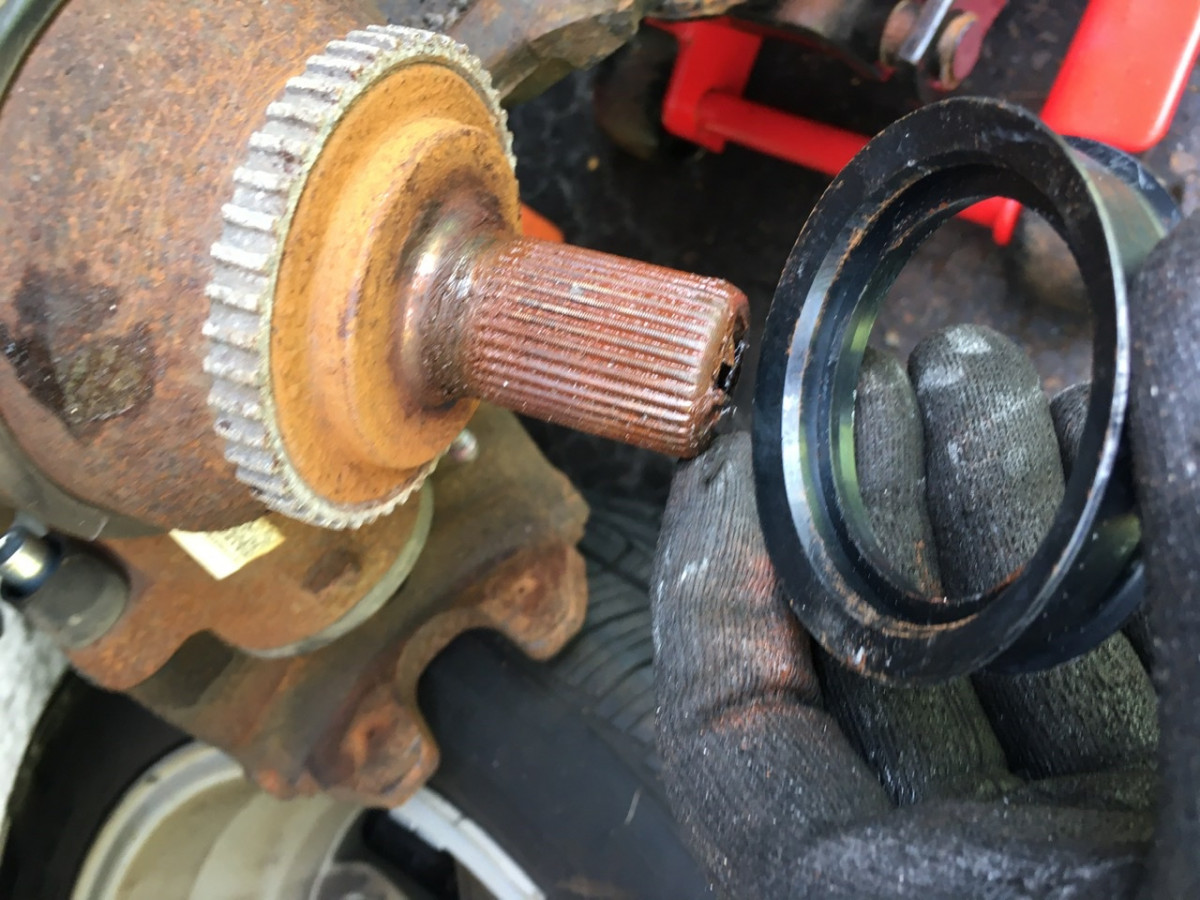

I finished fixing Shaggs left front foot. New FAG bearing. One of the heads on the hub bolt stripped, zip zip zip
I treated the brake backing plate with ortho for rust and then hammerite. One hole had rusted out on the plate so I added a fat washer to the M6 bolt
