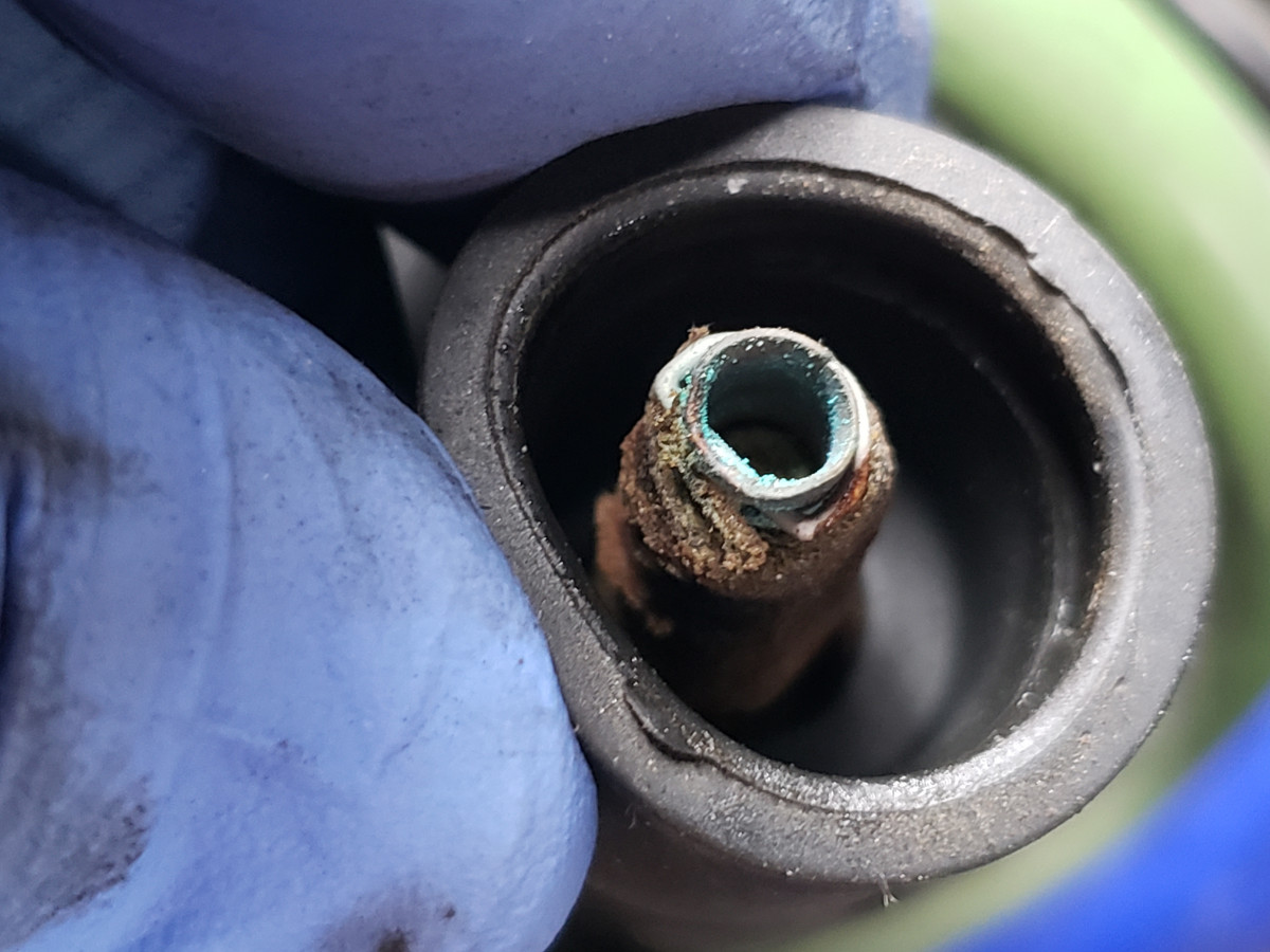

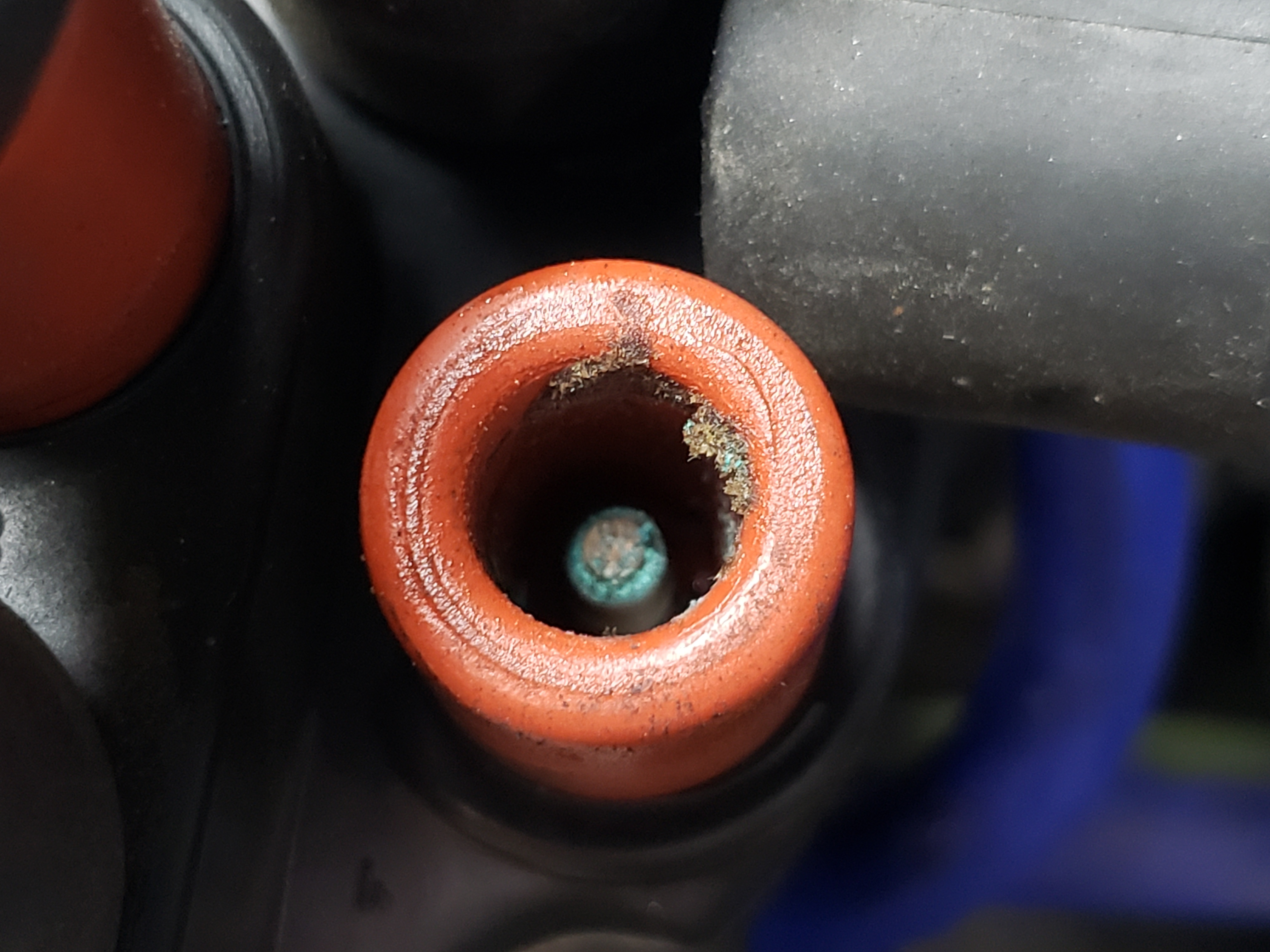

Thank you all! Found the culprit on store parking slot after returning there with parts i had on shelf waiting for years in case it was these.. and it was happily.
Note to myself that you cannot use multimeter to measure the camshaft sensor.. but crank one you can its between 200 to 400 Ohms.
Camshaft one gave anywhere between 5 -7 Mohms where you measured.

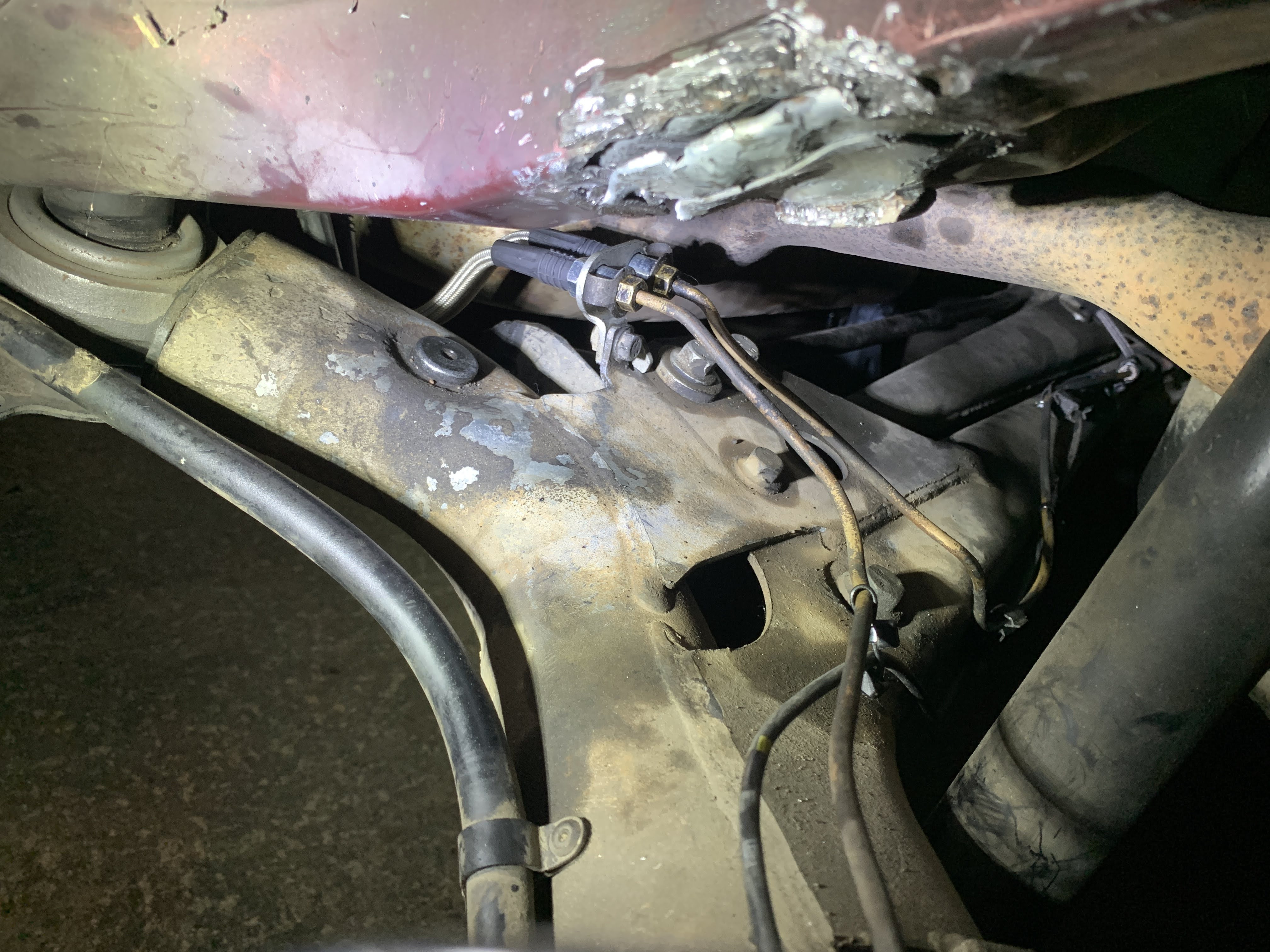

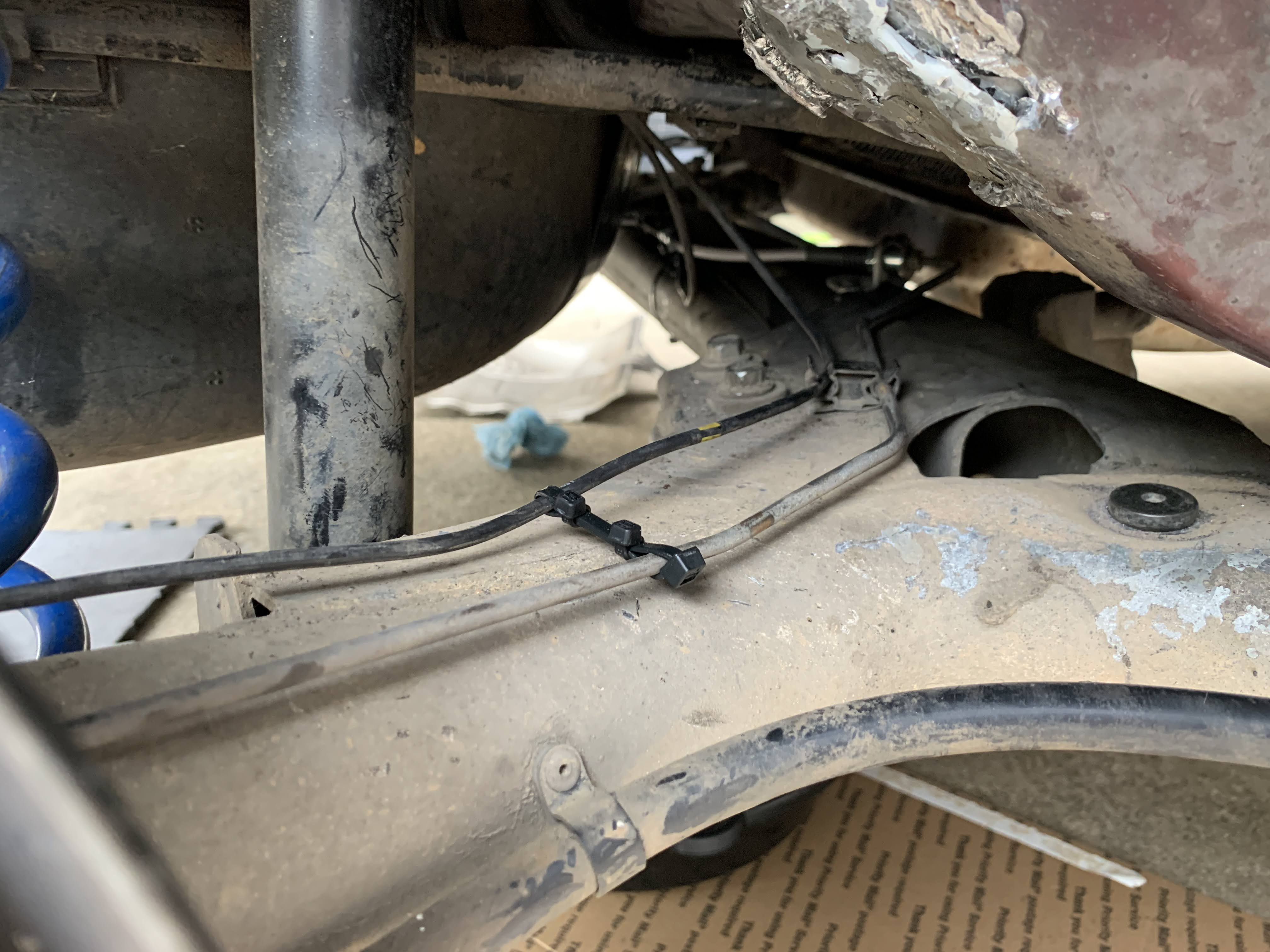

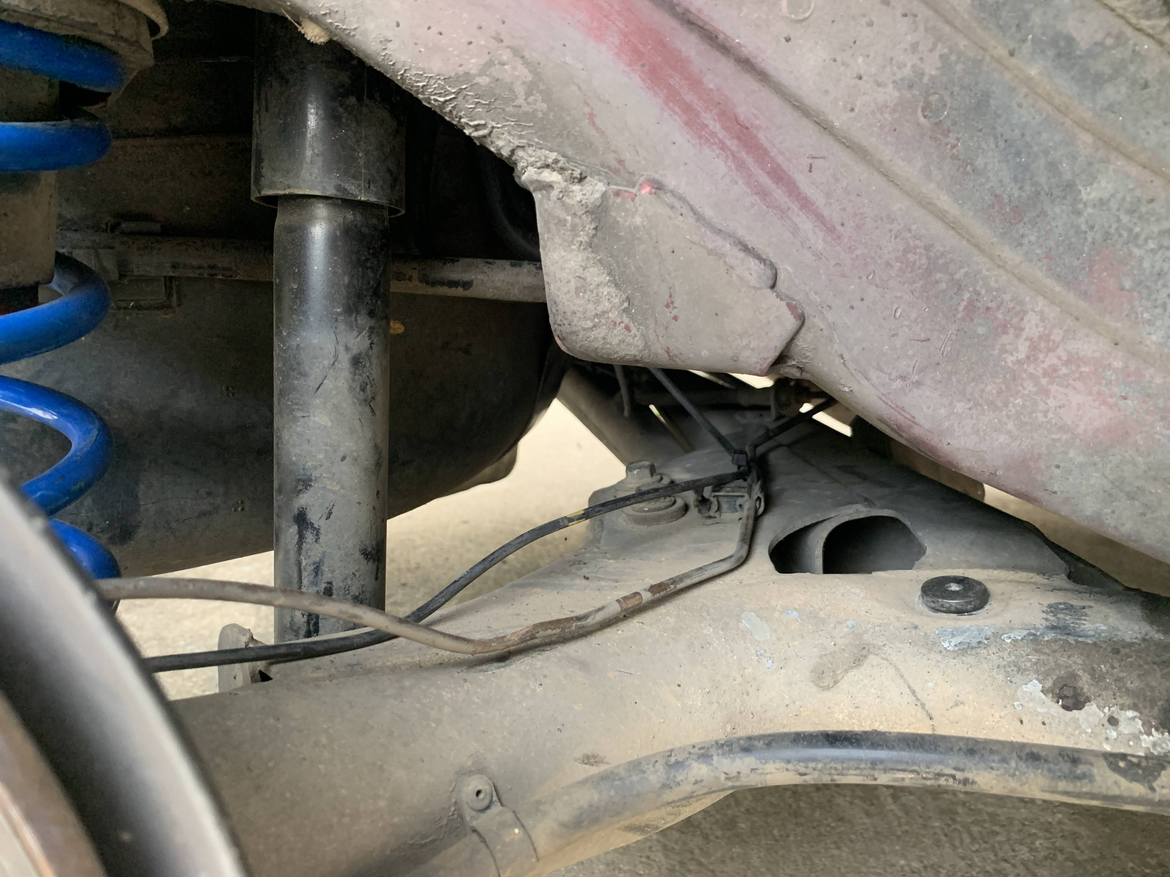

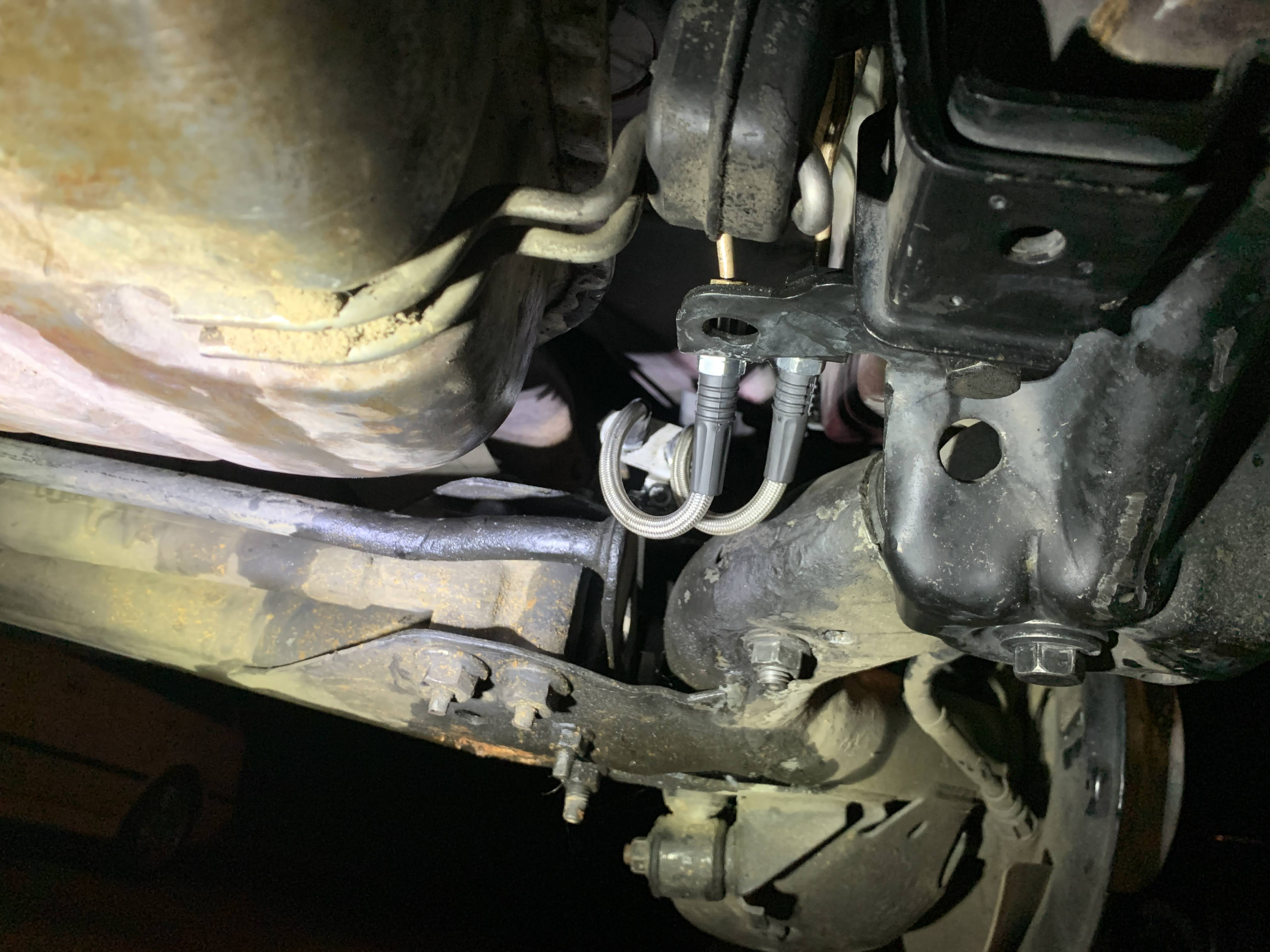

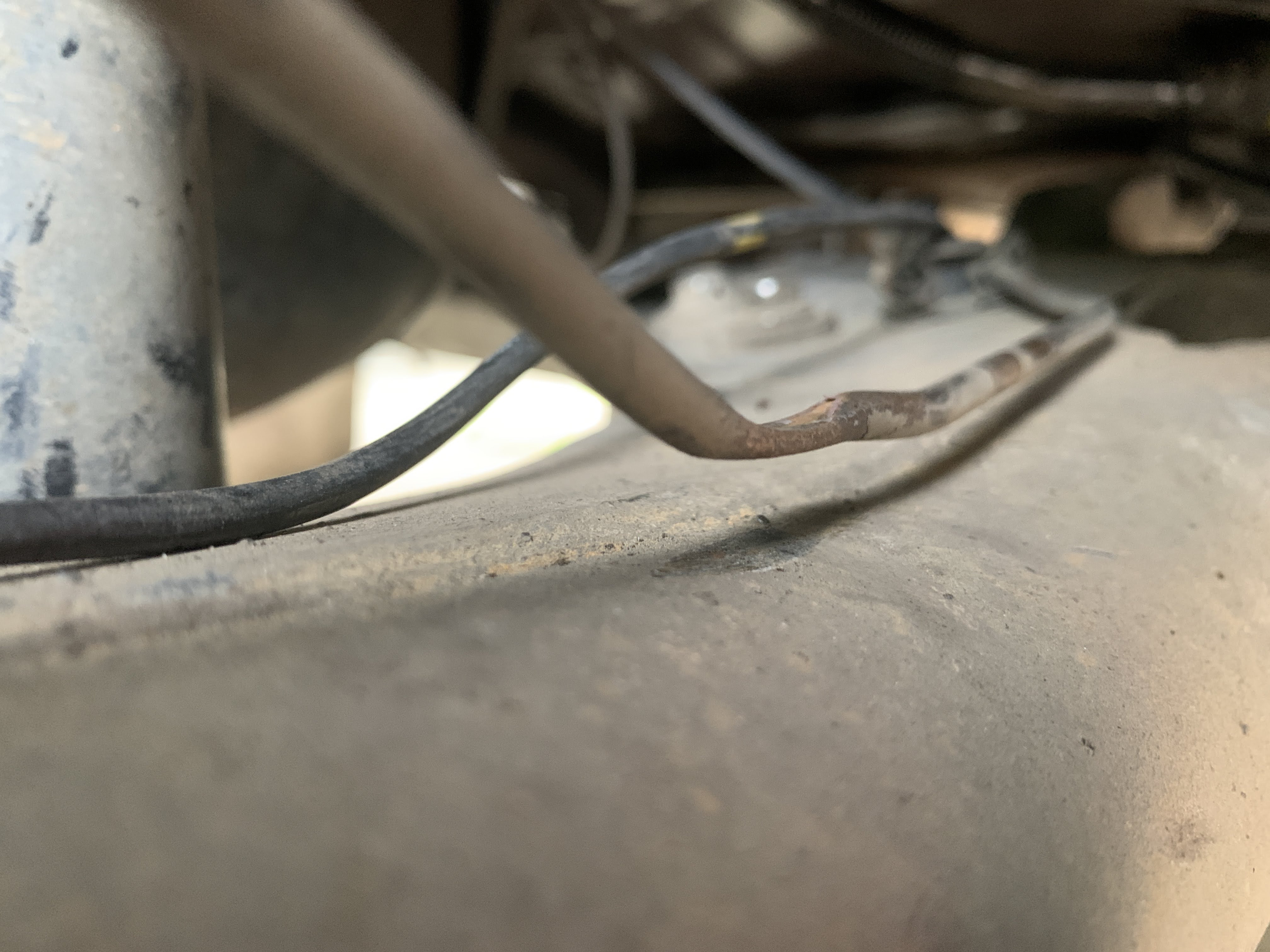

Finished chopping these AWD subframe brackets off so they don't smash my brake lines anymore. Believe it or not, I had no indication there was an issue beyond hearing a clunk on harder bumps. No issues with the brake pedal!
I took the opportunity to replace the old stiff rubber brake hoses with stainless ones. I had to cut back and re-flare the driver side line, since I had just use a union to keep a hard brake line to that side when I did the FWD suspension swap. I prefer to have a flexible line somewhere in the area to allow for suspension movement!
And yes, I plan on cleaning up the leftovers from those brackets. Just too lazy to do it now... I've been really slow to get this done, I'll just be happy to be able to drive the car again after it sitting for another week or two now lol.
