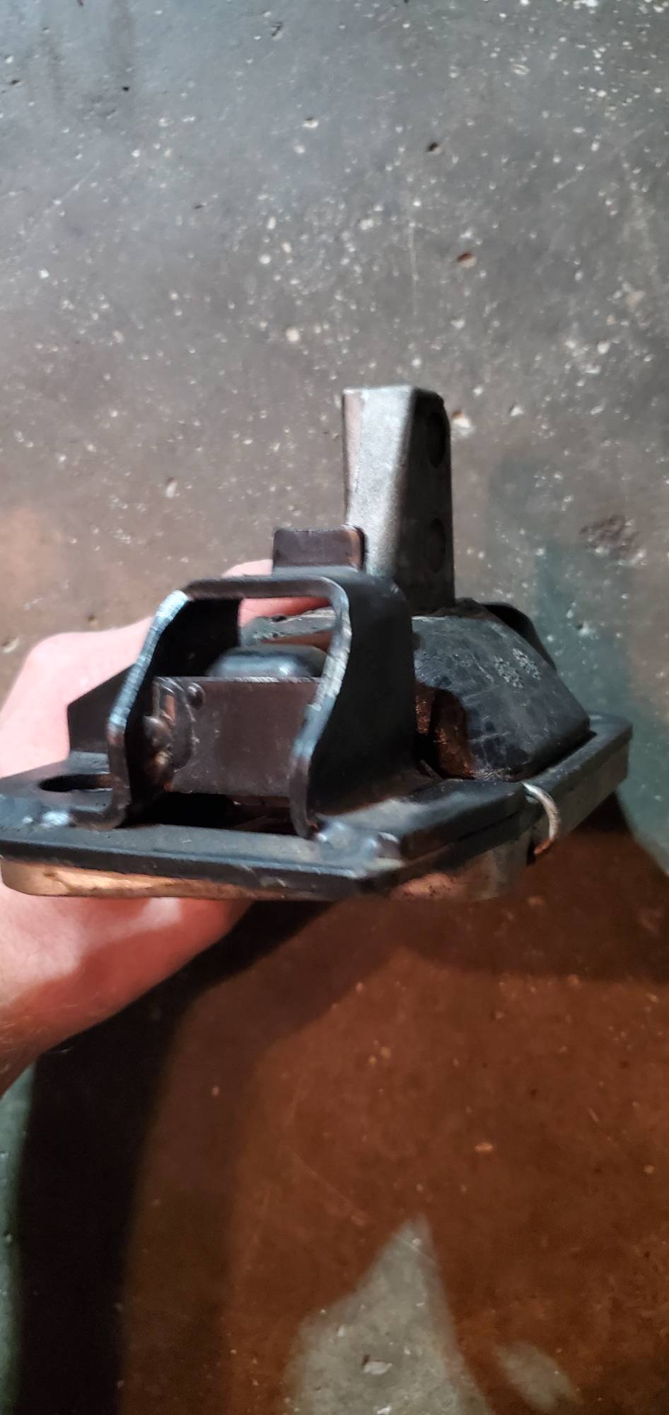

Whatever IPD is selling under their generic "aftermarket" for the passenger side "front" engine mount for AWD P80s is not worth it. After 5000 miles I was getting some pretty bad vibration at idle, and I found that the mount had already partially collapsed. I put the original, unknown mileage Volvo mount back in, problem is mostly gone.
It turns out that these mounts are just the regular p80 mounts with a little clip holding them onto an aluminum plate, so you can just buy the FWD mounts and use the plate you already have.
I have a Rein mount for the same place, which seems like higher quality rubber, but it still needs to go some miles before any verdict can be made.

jsrnsis wrote: 19 Aug 2023, 19:11 Whatever IPD is selling under their generic "aftermarket" for the passenger side "front" engine mount for AWD P80s is not worth it. After 5000 miles I was getting some pretty bad vibration at idle, and I found that the mount had already partially collapsed. I put the original, unknown mileage Volvo mount back in, problem is mostly gone.
It turns out that these mounts are just the regular p80 mounts with a little clip holding them onto a steel plate, so you can just buy the FWD mounts and use the plate you already have.
