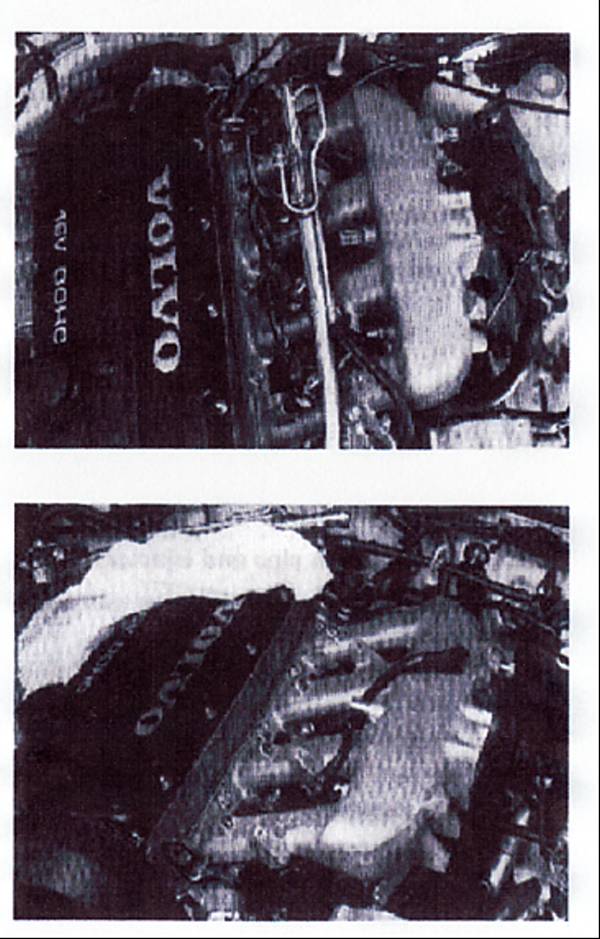

The intake manifold is the silvery bit in these two photos, which are from VADIS:
The place to spray is where the manifold joins the engine block after, of course, getting the beast up and running again.
