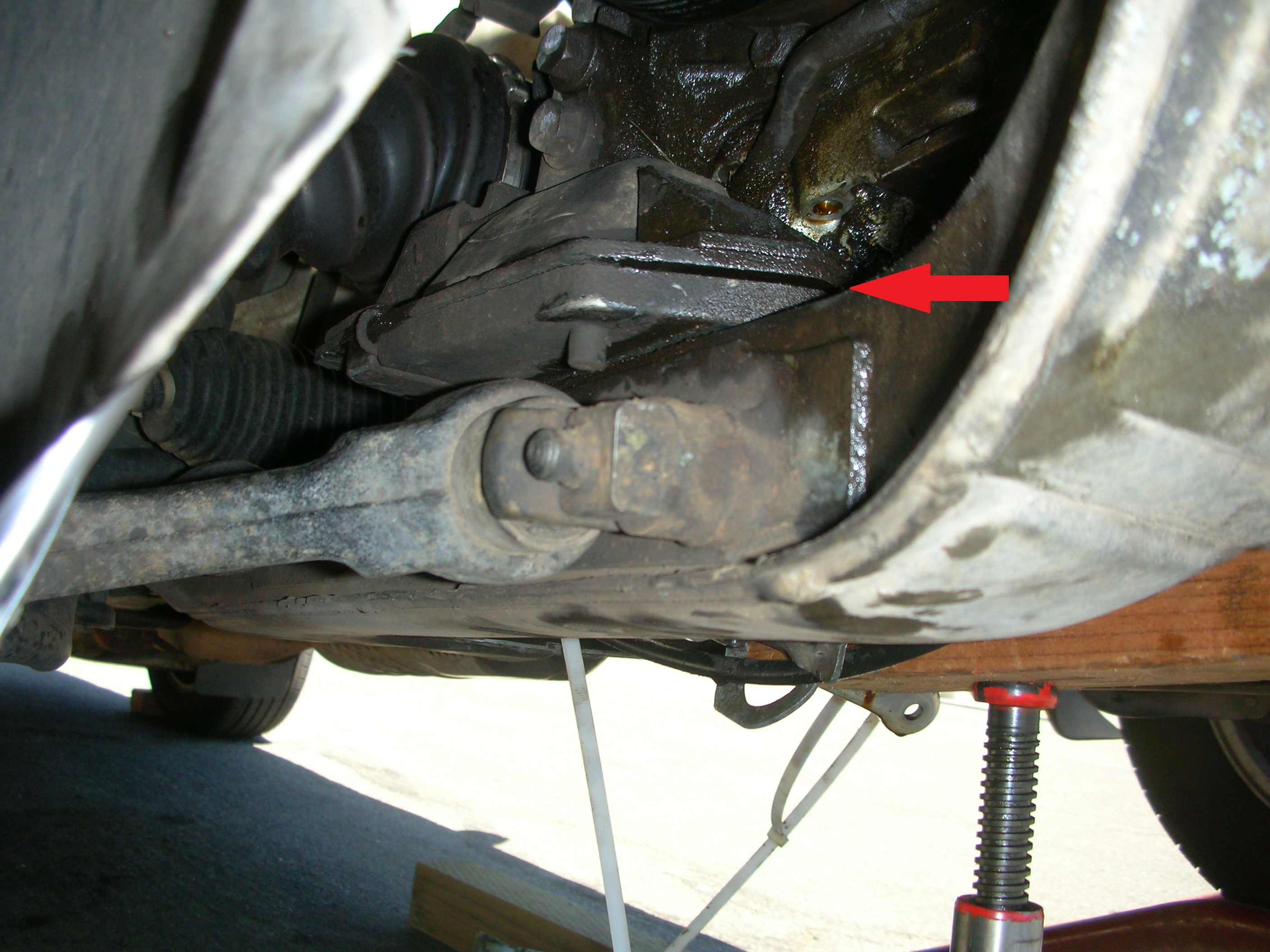

Ok, so after I took off the mount bolt and started jacking up... this happened! :shock:
I don't think it's supposed to split there...

JDS60R
Posts: 3532
Joined: 21 February 2009
Year and Model: 2007 S60R 2016 XC70
Location: Mount Juliet, TN
Been thanked: 3 times
Post by JDS60R »
How many bolts did you take off - one on each side??
