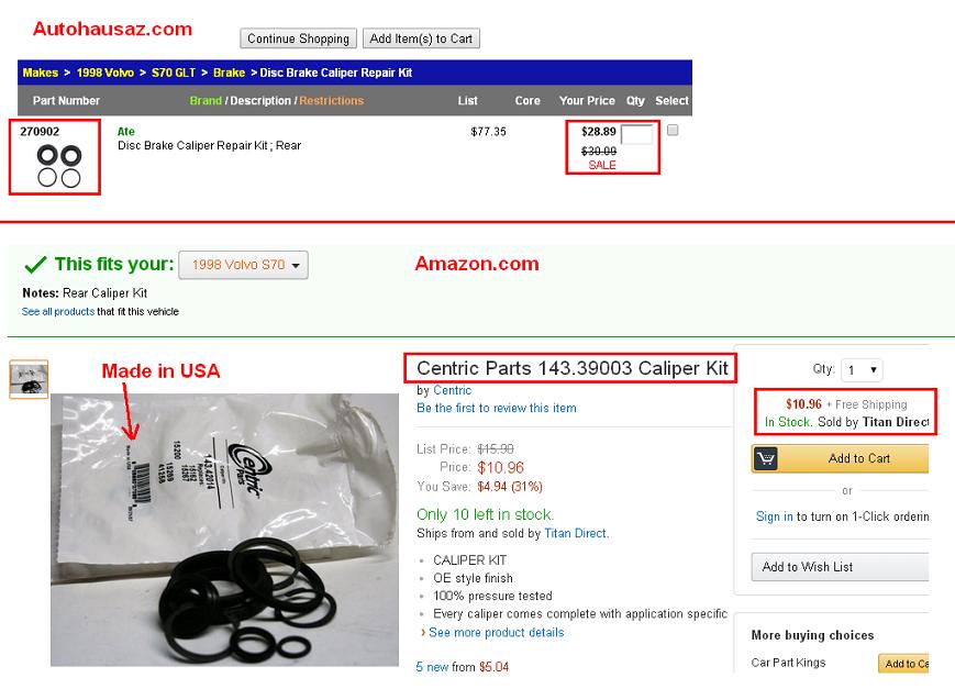

Since I posted the DIY three (3) years ago, a few things have changed regarding the REAR rebuild kit...
The REAR rebuild kit Volvo PN 270902 is now about $30 for each caliper.
However, if you look at rockauto website (or local OReilly autoparts), you will see:
CARLSON Part # 15174 ---> $3.50 (rockauto pricing)
CENTRIC Part # 14339003 ---> $5.50 (rockauto pricing)
Then I did some more research, amazon shows photo of CENTRIC Part # 14339003 with the bag clearing saying "Made in USA".
Has anyone here used CARLSON or CENTRIC REAR rebuild kit?
Top of photo shows autohausaz pricing, bottom of photo showing amazon pricing:

I was at local OReilly auto parts store today and looked at CARLSON Part # 15174 rebuild kit.
Seems good quality, but the package says "made in China".
I wonder if anyone here has any experience with this particular rebuild kit made by CARLSON?
FYI, the ATE rebuild kit (made in Germany) is now > $30.
