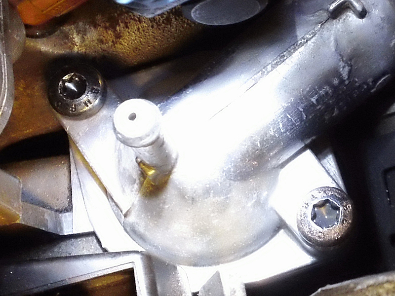

The thermostat shank removal is complete, details here...viewtopic.php?f=1&t=50844.
Used cn90's tips and tricks for thermostat replacement.
new T40 screws with new blue box Wahler inside...
Water pump and all tb components are installed. All torqued to specification.

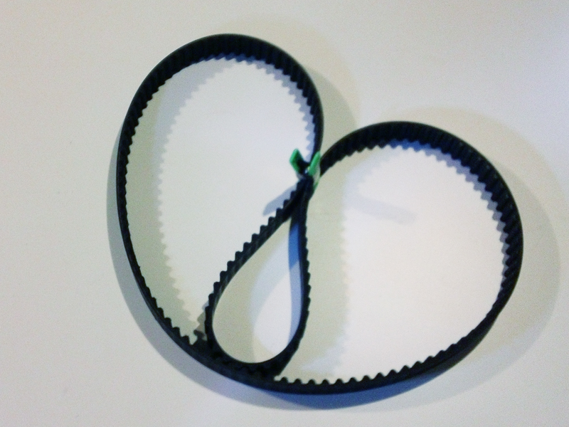

Belt was slipped in from below easily, now around the crank gear, but a few teeth short coming to tensioner roller. There is bit of a slack before the intake cam.

Great start this morning, belt couldn't stand my advances. I now have water pump and tb components fully installed.
Timing marks are holding firmly. I am about to start the two turns on crank.

That thermostat housing looks new.
xHeart
Posts: 3306
Joined: 3 December 2011
Year and Model: 2.0/3.2
Location: Great Lakes - USA
Has thanked: 113 times
Been thanked: 116 times
Post by xHeart »
rspi wrote:That thermostat housing looks new.
I treated the housing with citrus cleaner, and scrubbed it a little.
