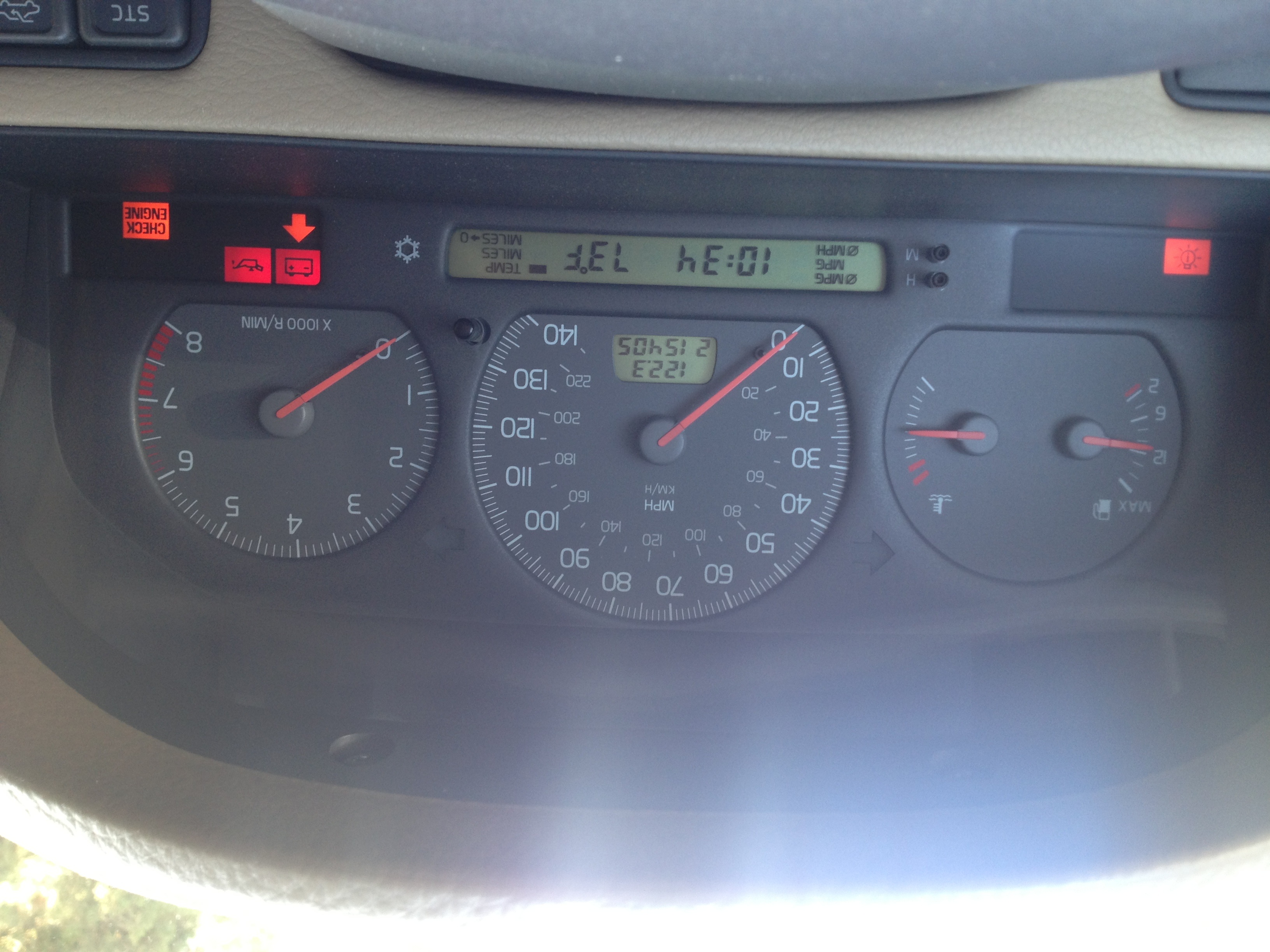

Today my car died when I pulled into a parking lot and these are the lights on the dash every time it dies (not that it is indicative of anything).
I will check codes tonight as well.

PS my light bulb indicator is indeed legit due to having the hatch door top panel light out at the moment.

Check those grounds and read the codes again and lets see where we are..
Not sure why my pics post upside down on here (when I upload the pic on the mobile site, it appears right side up). Sorry.
