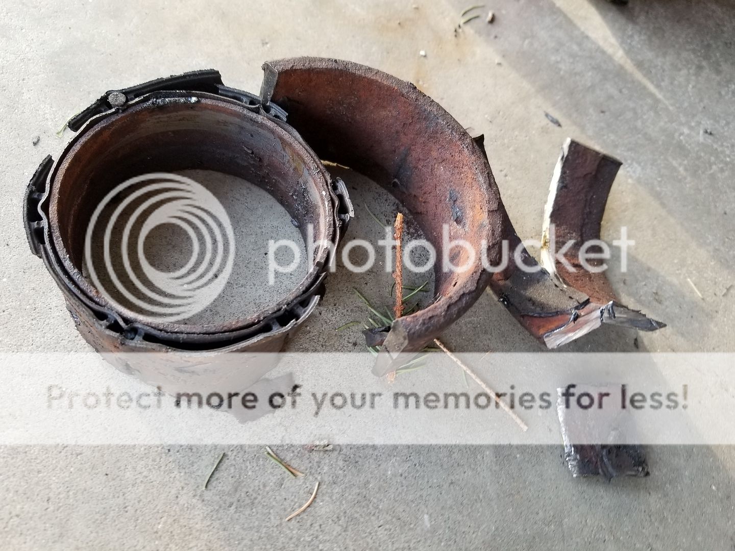

Here's the OEM damper I had to cut in half to get the driveshaft removed.
There is very little clearance room between the damper and Haldex 3. If there was more space I might of been able to force it out with a crowbar using a bolt through the backside.

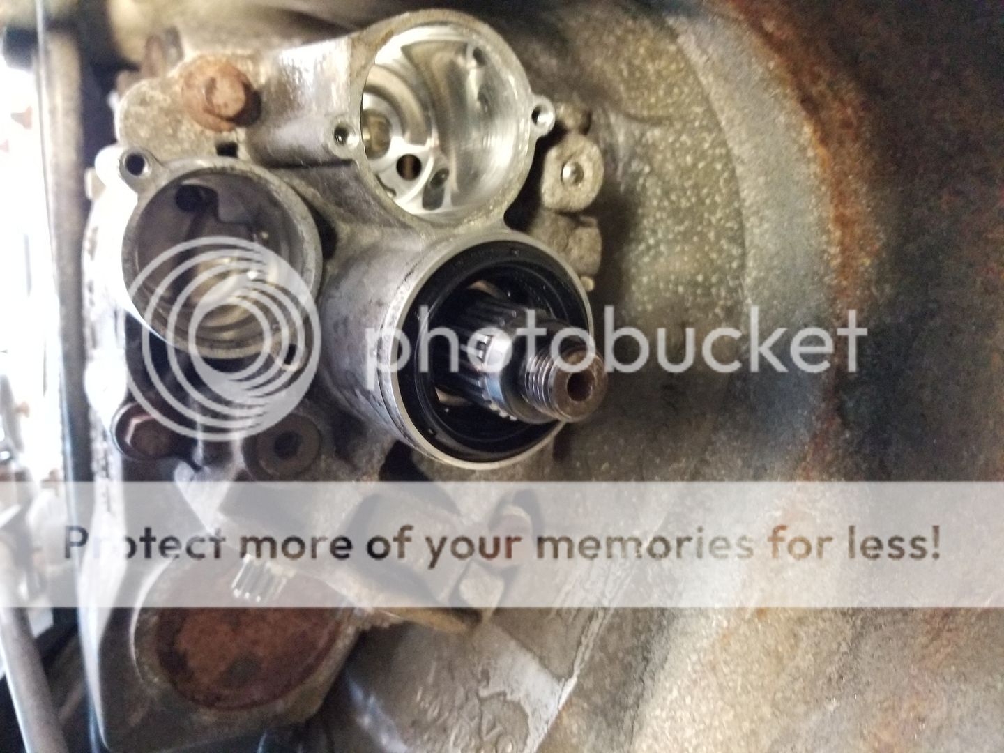

I cleaned up the Haldex 3 oil pump & filter housing and threw on a new seal.

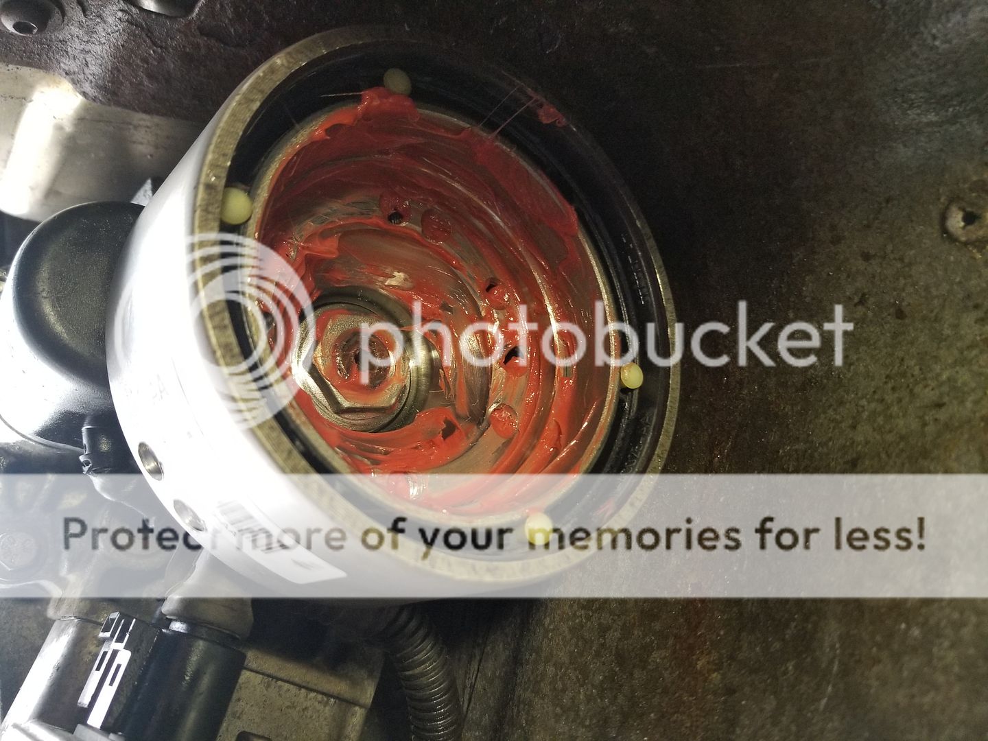

After mounting the new damper I covered the inside with ball bearing grease.
This will make the driveshaft easier to remove if needed in the future.

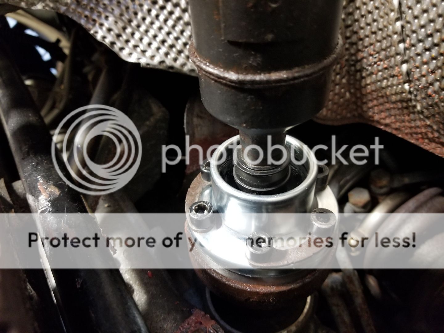

Here is the driveshaft mounted into the new damper.
Here is the other end mounted in the bevel gear.
I threw new CV joints on both ends I got from Colorado Driveshafts. The boots are made of nice thick rubber on these joints.

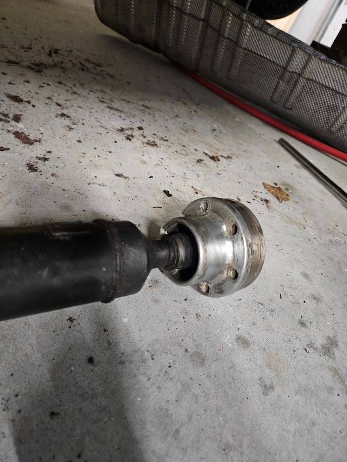

It's been nearly 5 years and 56,000 miles since installing these CV joints from Colorado Driveshafts and they're still in great shape. Took this photo of the front CV joint without cleaning it yet.
Having new CV joints on the driveshaft made the removal super easy this time. After removing the 6 bolts each CV joint came out with little effort.
