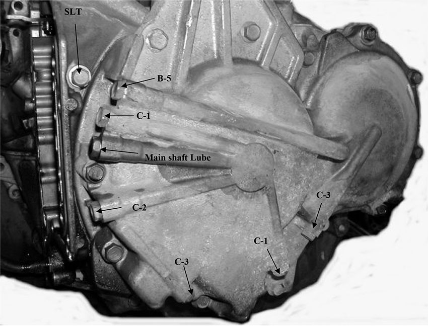

If you're not hearing the whine, it could possibly be something besides the clogged filter. A total failure in the torque converter could cause no movement, but that's remarkably rare. It's possible to check if the pump is running by looking at line pressures. This can be done on jack stands or a lift.
The pump pressure can be checked at the ports on the outboard side of the transmission as shown: The following link walks through what pressures should be measured at the ports:

For a backyard mechanic like me with no advanced pressure testing guages the pump pressire is also visible at cooling lines on the radiator. Just use the bottom hose to drain into a 2 quart milk bottle with engine running. It should fill quickly ie. no more than 40 secs of engine operation. Have some fresh green clips for the coolant line from the dealer on hand as they are mostly destroyed once removed

Each of the 3 ports there has different pressures at idle and in D. We have to be pretty specific here......

The document I linked to walks through the specs for pressures at each of the ports at idle and load. Regardless, the "jug test" should probably be done first as a go/no-go check.
