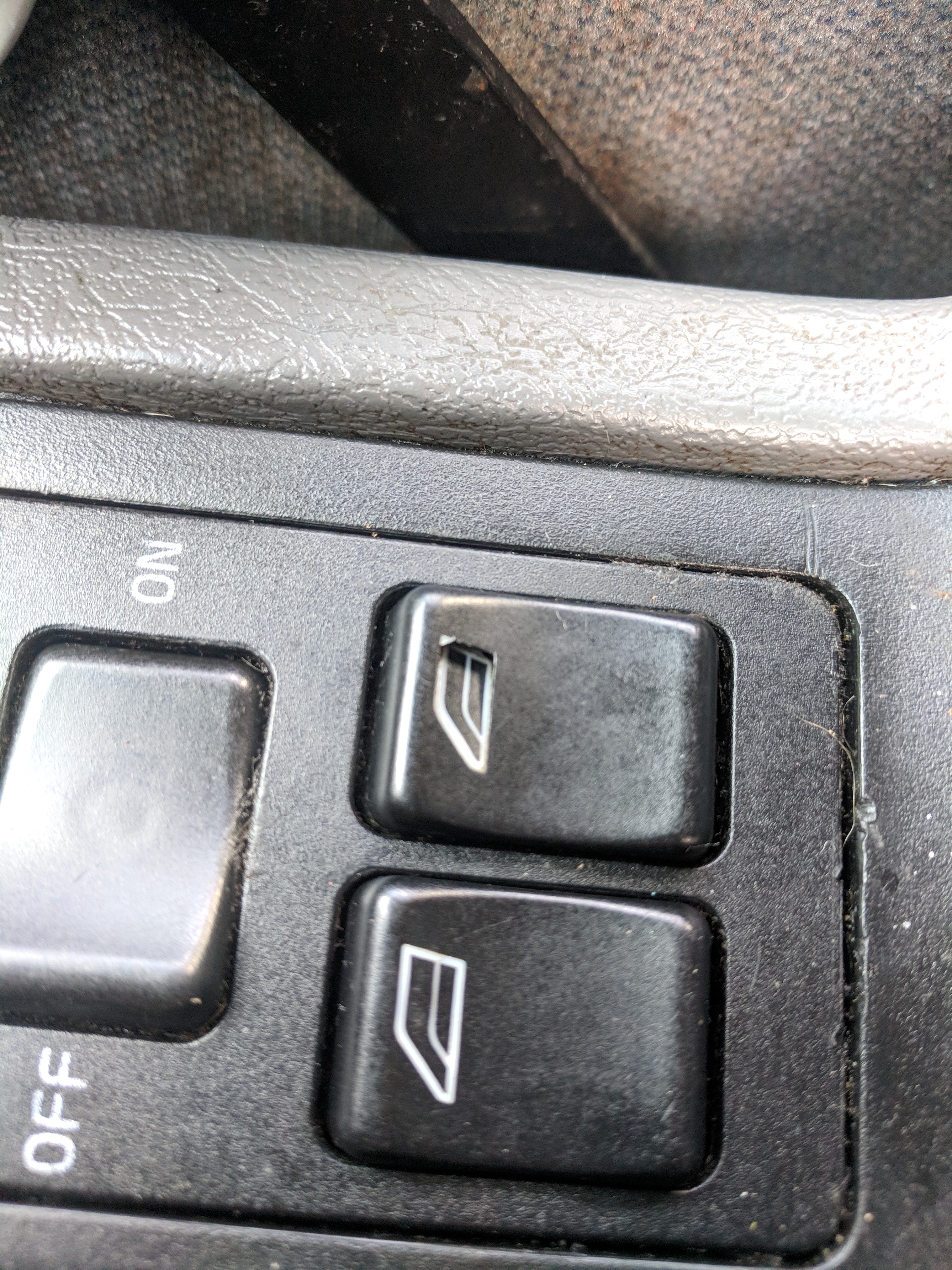

Dear diary,
I've been recently trying to replace the rear right brake calipers. Unfortunately the brake line nut has been giving me a really hard time. I've been spraying the thing with WD-40 in attempt to loosen it up, so we'll see how that goes.
Additionally, my Engine Coolant Temp (ECT) sensor has failed, but in order to take it off, I need a 19mm. And once I get one of those, I need to head to a junkyard and hopefully rip one off.
Also, I broke my window switch button.
Along with lots of other things which have been moving rapidly. This car is going through a lot, and I salute it for being such a soldier of a daily driver and keeping up with my young-adult shenanigans, as well as tanking 50+ miles a day, 6 days a week.
Also, I've given him a name: Idris

Trick on the rear caliper. Leave the hard nut alone, and, with the caliper still firmly attached, loosen the soft brake line attached to the caliper 1/4 turn. Now unbolt the caliper and carefully unscrew the caliper from the soft line.shihabafi wrote: 17 Aug 2018, 18:10 Dear diary,
