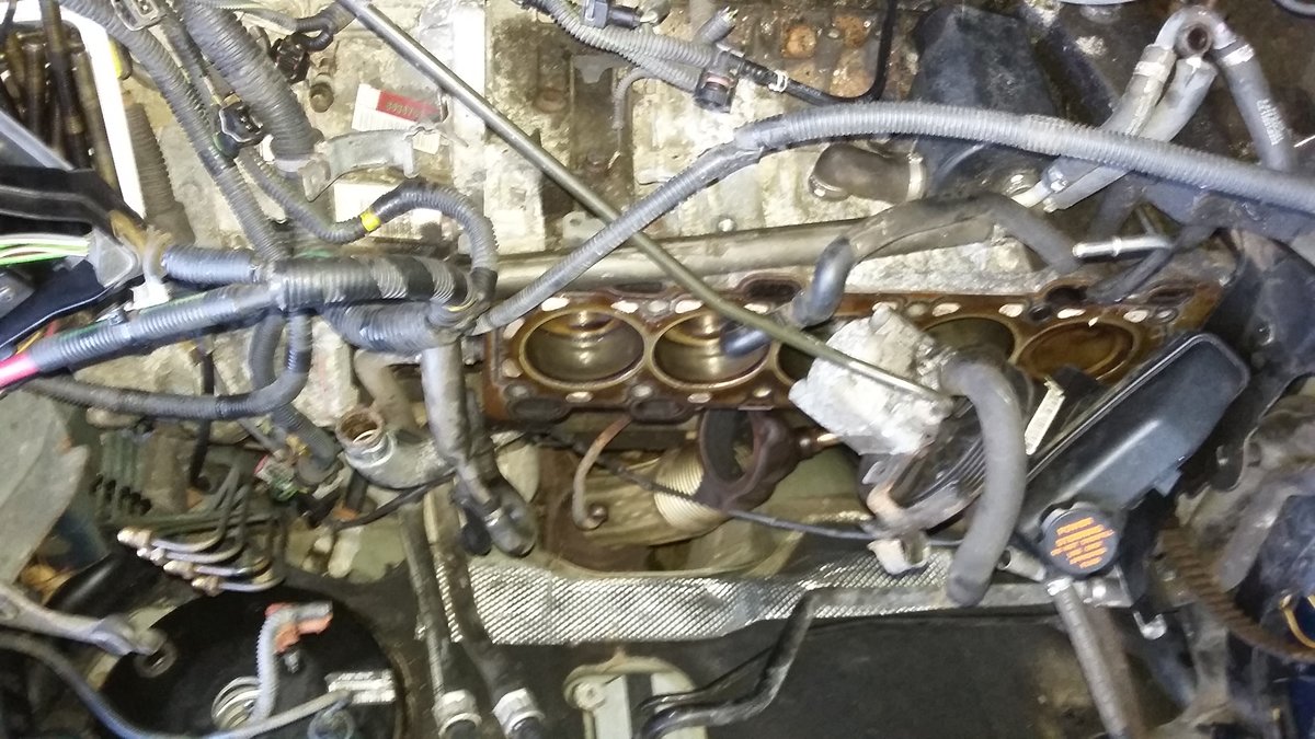

The head is Clean used 1000,1500,2000 grit with WD40 its nice and clean , mostly looked like oil stains no real thick stuff, No gasket material.

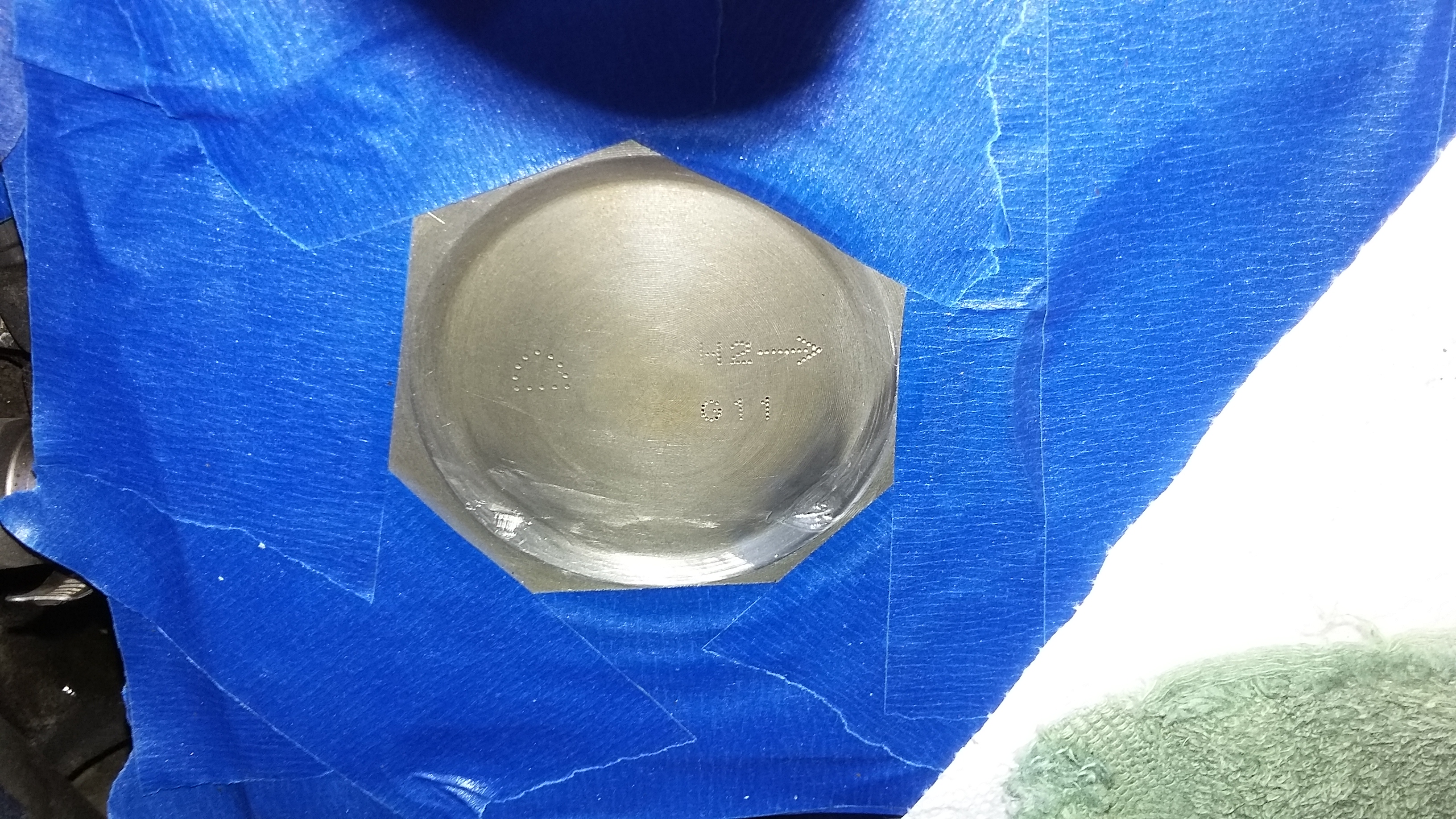

Did the same to the Pistons knocked of the metal that roll and hit with the sand paper same as the head...just used my thumb. Glad I did some of those pieces I was able to pick off using my thumb cnail..

Covered the edges of the Pistons to hopefully keep the sand paper grit out .

The fun of it all is you can look at that picture and be perfectly calm, borrowing the words of "Spicolli" - "I can fix it". (name the movie)
The piston looks ready for another 200k. Project seems to be moving along nicely.

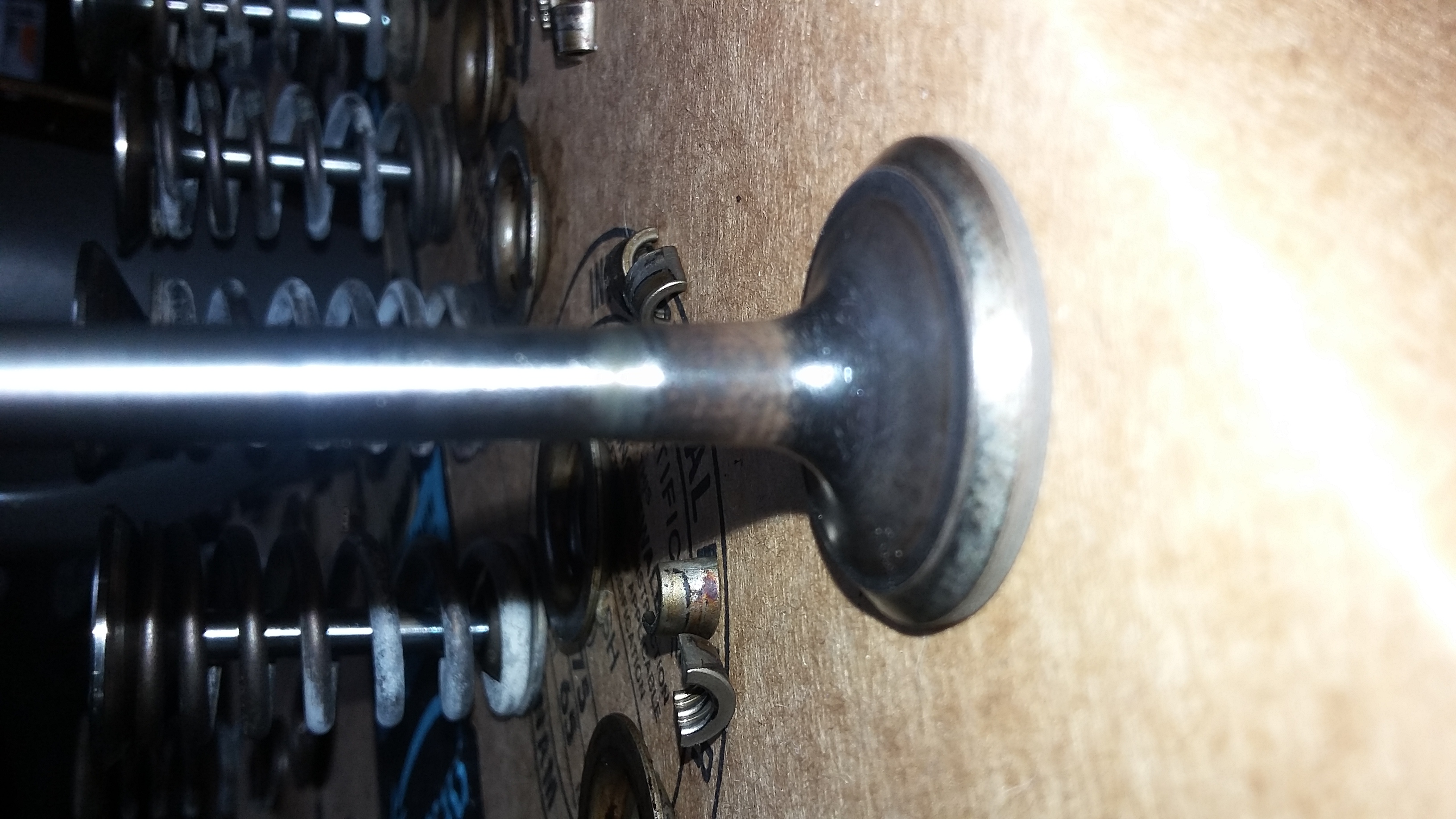

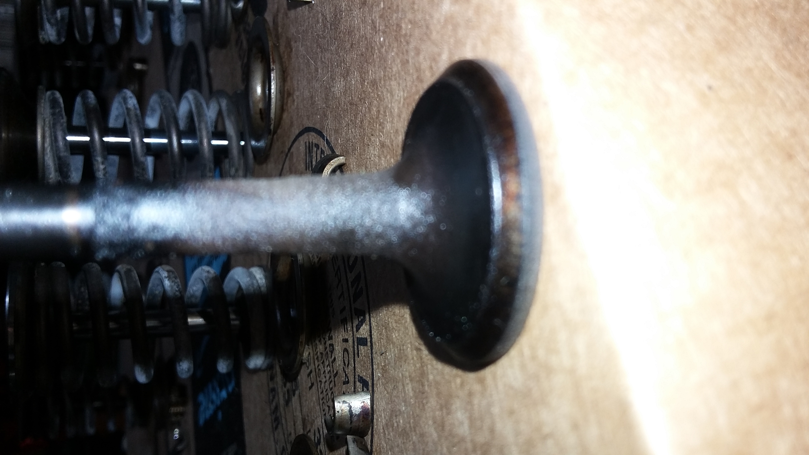

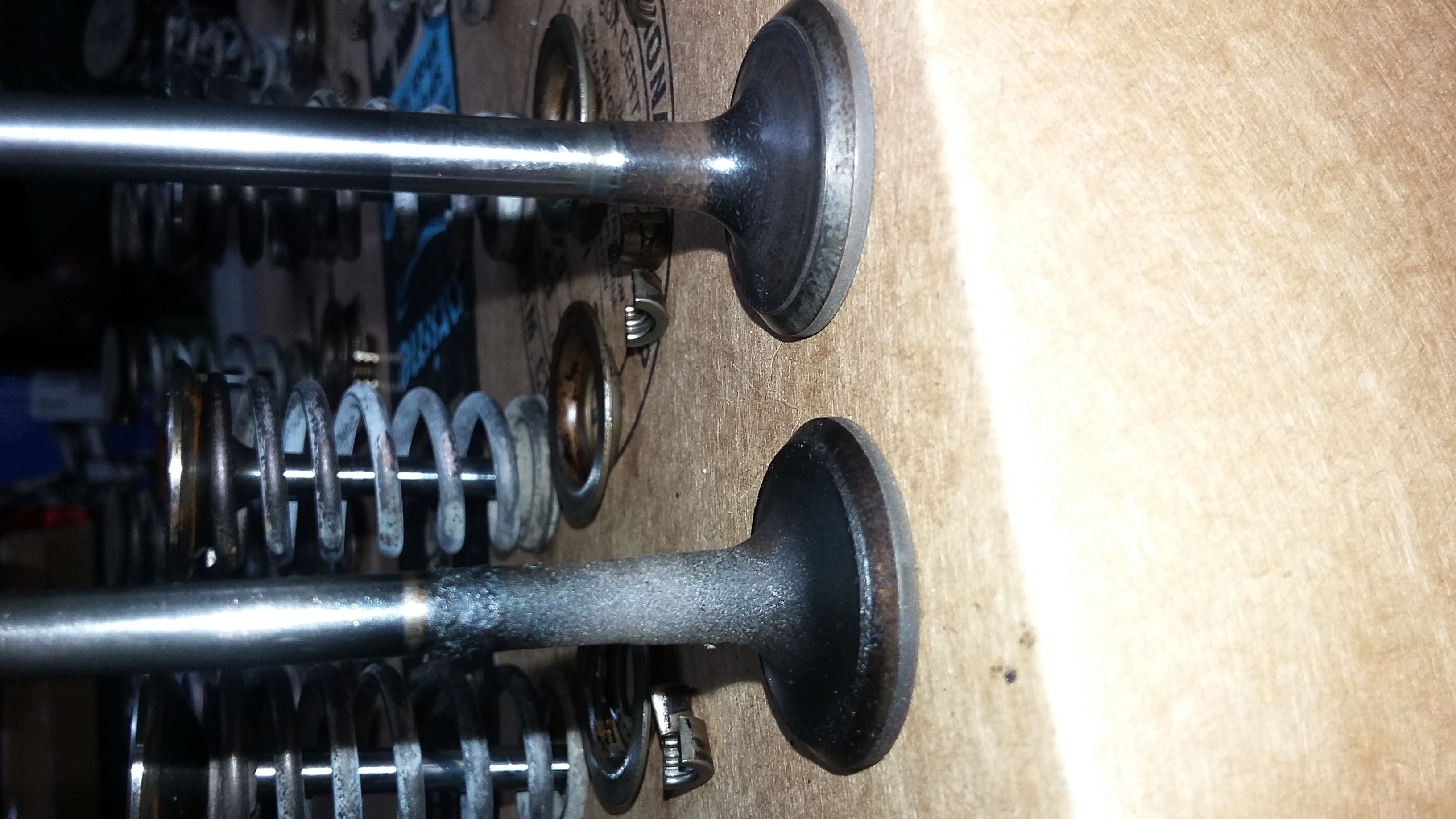

My cheap spring compressor tools workec just fine, Got all the valves out and trying to clean them before trying to lap them and replace the stem seals.
This what I have don't know how much more I can do to the stems themselves. I Soaked in parts cleaner Carbon Remover for over 24 hour... its old stuff may be spent, then chucked on to a drill and with while Scott Pad very soft for polishing I ran it thu..
Not sure how aggressive I can get with these valve..
Anyways.... Here what I started and ended with... What do you guys think?
Time to try and get a few more things done..

There was quite some carbon deposit on them. Did you also try Seafoam? Good for carbon and oil varnish.
I'd use a steel wire sponge on these, gently. I wonder if these have a coat or something?

To me that's Alot of Carbon ! I can tell that the seals are hard and brittle lots of oil had to be getting by them...
I don't know if they have a coating or not..... I just don't want to scratch them and ruin them...
If no one thinks I need to go any further with cleaning ill just move on....
Thanks for your input.

You only need to worry about scratching the area that passes through the valve stem seals. The area I am seeing that still has build up will not touch the seal. What I do is take a razor blade AT AN ANGLE with the valve spinning in a cordless drill. I knock as much as I can and then follow up with a Scotch Brite pad. You can get those cleaner, just use caution with the blade so you don't cut your self. I have worked on way worse and got them clean down to the metal without scratching them. Some people take the valve to a wire brush on their grinder (numerous videos on this). What every you leave behind will attract buildup, but to be honest most likely the engine will have other issues before the build up gets super bad.

I watched a bunch of those videos. I thought wire brush was a little too much...
I am using the drill with the scotch brite pads I finally gave in and started using the Gray,Brown,Green,white pads...
It working but is a PITA... Taking way too long, I can't just leave it be.... its a sickness.
Anyways, ill get back to it today and post the results.
