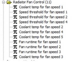

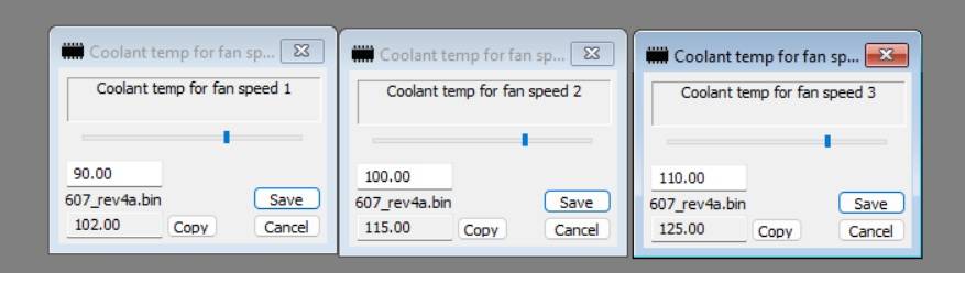

I just changed the fan trigger temperature in the settings Coolant temp for fan speed 1 changed to 90C, Coolant temp for fan speed 2 changed to 100C,etc. With a difference of about 10 degrees. The fan operation time was left unchanged, as long as this time is enough for successful cooling.

A PWM option for fan control would be a great upgrade.
Can you post a screen shot of which fan parameter you changed? Like I mentioned, I recall several different fan control parameters.
Perhaps one of them could also be used to turn on the fan in low-speed mode (like when the AC is engaged) giving at the very least a two-step option in fan speeds (even for cooler months).

Yes, of course. I can. I think it is possible to additionally configure the fan to turn on when using an air conditioner. But it will turn on normally at the first or second speed (if you have 2 speeds of course). Smoother regulation is possible only through PWM.Chuck W wrote: 21 Apr 2023, 05:19 A PWM option for fan control would be a great upgrade.

The fan already turns on low speed when the AC is engaged. I was wondering if it could be also be enabled at a different temp than the high-speed.
Is fan speed 1 for the low speed and fan speed 2 for the high-speed of the stock fan set-up?
