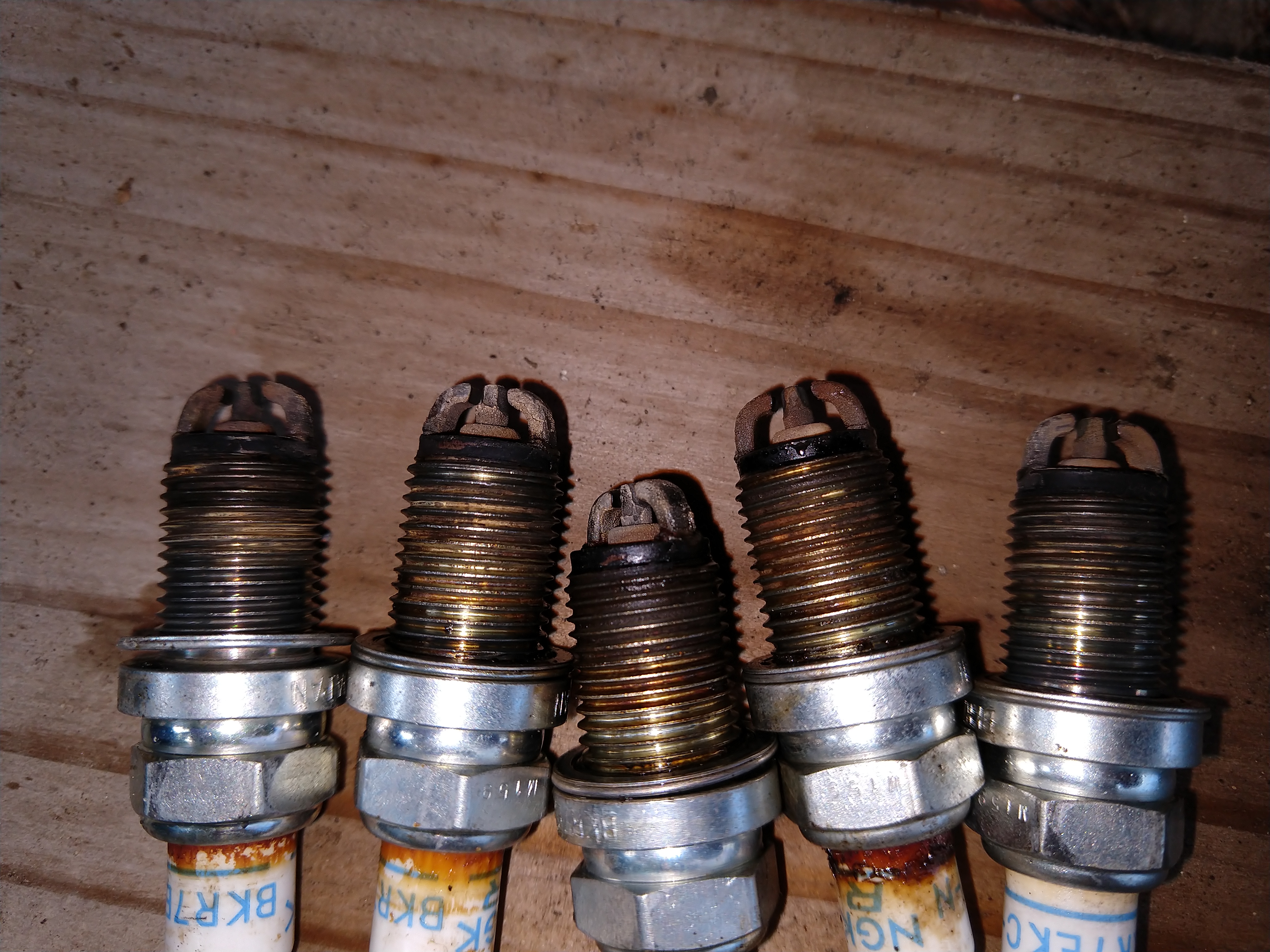

So, needed some small victories after the big disappointing weekend. Since I already had the parts, I replaced the nasty cabin air filter and the sparkplugs. Here's a pic of the disgusting cabin air filter. Felt like it weighed at least 10 pounds.
After quite a bit of effort, I removed the old spark plugs. Was surprised to find dual ground NGK R plugs inside. Replaced with Bosch FR7DC+ copper plugs gapped to ~.029". This took way more effort than it probably should have. Had to use a big pair of channel-locks to regap the plugs because the grounds must have titanium cores or something.
Sparkplugs 3, 4, and 5 came out easy. Probably had something to do with the two tablespoons of oil sitting in the sparkplug holes.On a side note, also replaced the oil cap gasket. Spark plugs 1 and 2 were damn stubborn but I got them out eventually. She idles beautifully now and runs a lot smoother; however, the unscientific butt-dyno feels as though she lost some pep above 4k rpm. On the plus side, it would appear my daily commute has gained 4mpg (with A/C on), will update later.
Protip #1: If you are unfortunate enough to drop something small down the sparkplug tube and do not have a small magnet handy, Stick a piece of duct tape sticky side out on the end of a screwdriver. Works just as well.
Protip #2: Here's how to remove very stubborn sparkplugs. Spray a little penetrating oil down the spark plug hole. Put the boot back on and take the vehicle for a quick drive to warm it up. Now try removing the plug (caution: everything will be hot now). If still stubborn, add a very generous amount of penetrating oil to the spark plug hole and wait about an hour, but not so long that the engine cools down. Now try removing. If still stubborn, grab an 8 to 12inch 3/8 drive ratchet. Position in such a way that you are pulling with both hands. Remove everything from the crash zone, because you will fall on your butt when it breaks loose. Now lean back slowly until you put your full weight on it. Give it some time, and eventually it should break loose (at least that's what it took to do mine). Soak up the oil before removing the plug, unless you like fogging out your neighbors.
