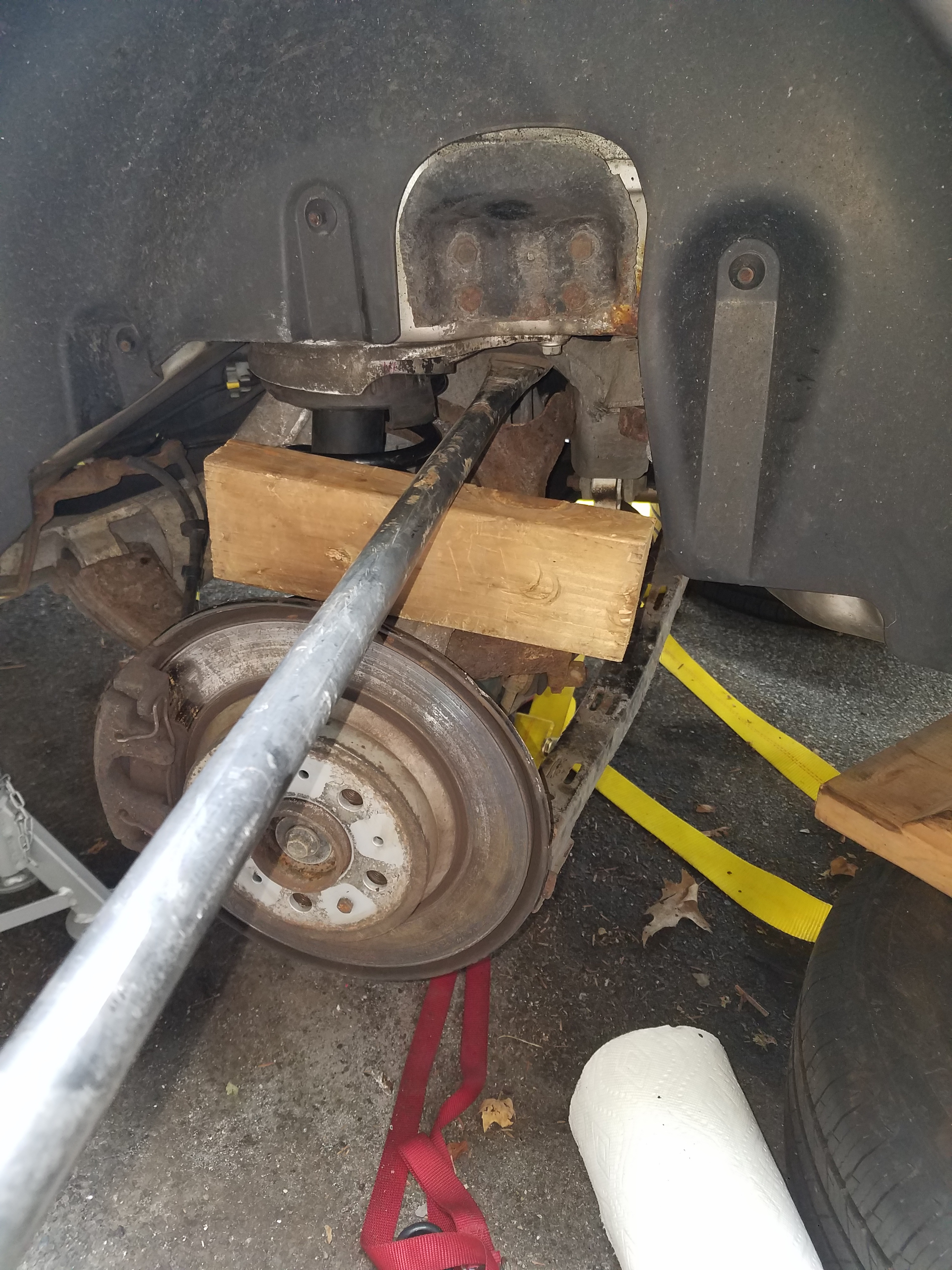

Well we kicked this cars butt today. That being said, it’s a two person job with a six foot pry bar to get that shock bolt on. There was no way straps were going to get the control arm down hard enough to slip the strut bushing onto the boss on the control arm. Moreover, the strut mount needed a lot of pressure to get it fully seated up into the frame, which we completed after we got all the bolts in.
With two of us dividing the labor of positioning and applying very downward force on the arm, it took 60 seconds once we found the magical method of pry bar and lumber
Picture to come.
Picture to come.

Abscate to the rescue. I'm a light weight at 162 lb. It took most of my mass applied to the very end of that 6 foot pry bar to lower the control arm enough to fit the strut. Any more and I would have been suspended in midair. Probably ~750 lb applied force given the fulcrum was about one foot from the end. After the strut was on the control arm, tightening the two upper bolts brought the spring seat above and everything else into place. Starting the upper bolts on the spring seat from below before using the pry bar was a good strategy. The rest was easy.
Leveling the jack stands did make this less impossible: "almost impossible".
To do this routinely I think it would be useful to notch the wood piece, or use something else, so it sits more stably on the suspension.
I wonder if the strap can retain the control arms in the right position but cannot align them once they have shifted. Seems like it would still be difficult to slip a strut back on.
