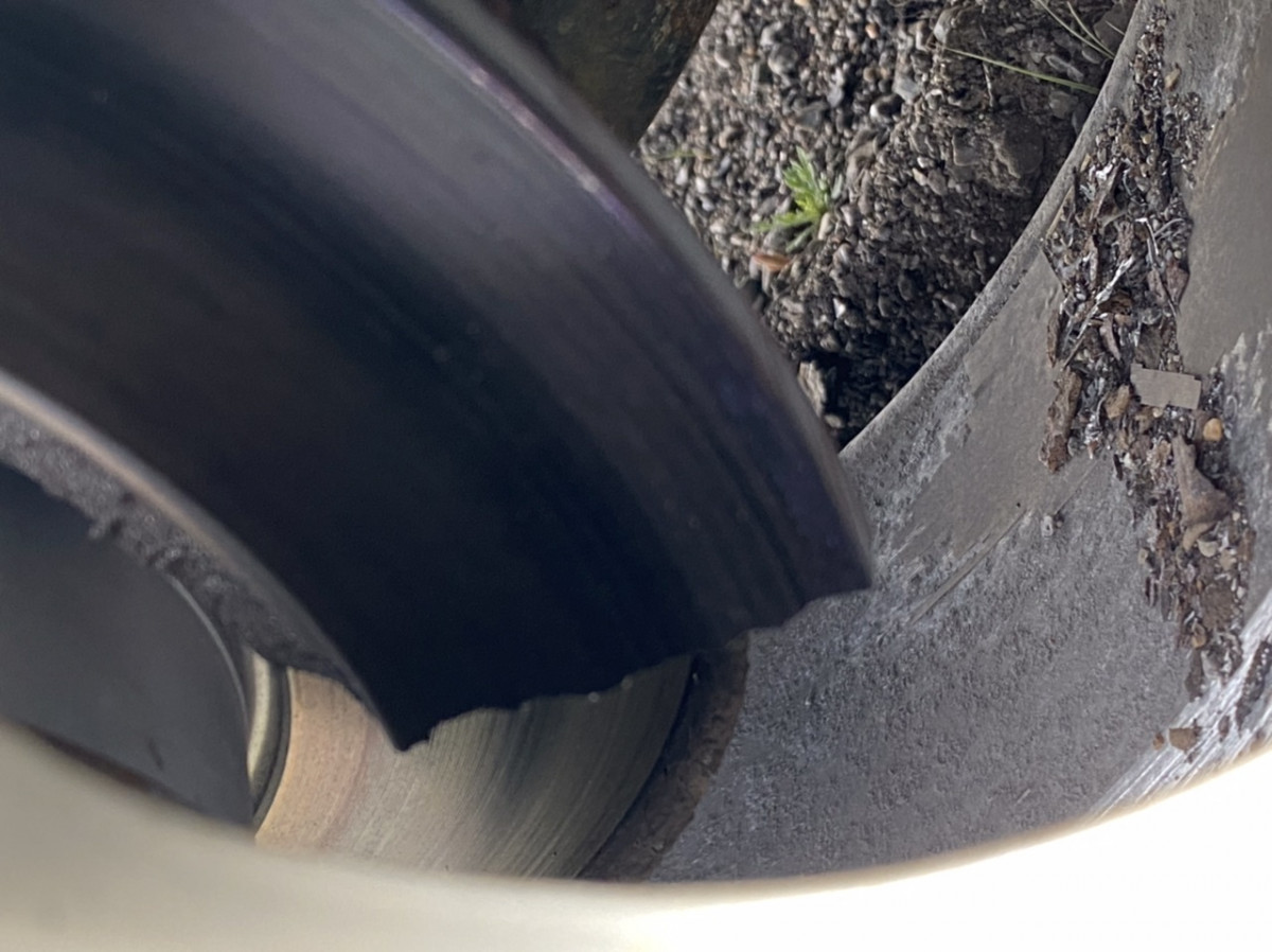

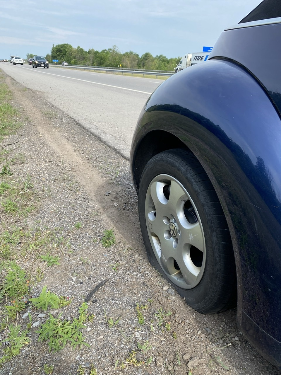

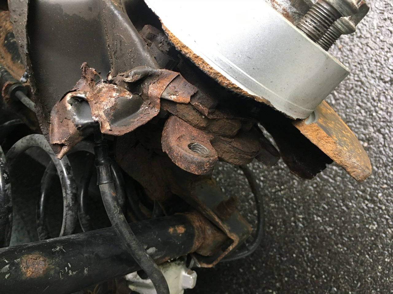

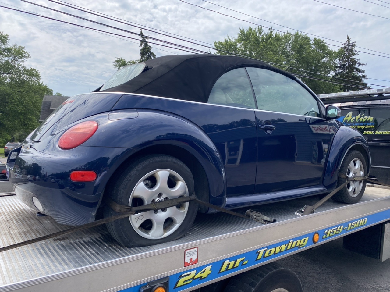

Have to update with my ManBeetle
At 70 mph, the rear wheel locked up, destroying the wheel, two tires, caliper, rotor , amd bracket.
I also had to rosebud the rear axle to straighten the bent bracket attach.
Luckily, no cats were harmed.

^ wait a sec...have we all discussed cause yet and I've missed it? Which piece failed first? The rotor fractured? And why?
- Posts: 36154
- Been thanked: 4071 times
Dumba**** failed to torque the caliper attach bracket correctly to the rear axle. It got loose, the caliper swung up and machined out the alloy wheel, which blew the tire, and then caught in the alloy, fracturing the rotor, bracket, and tires.
I suspect I put the bolts in and never got around to torquing them, due to a long day and user fatigue. They drove for about two months/900 miles
I like welding in bare feet - it keeps you aware of where the metal is going
