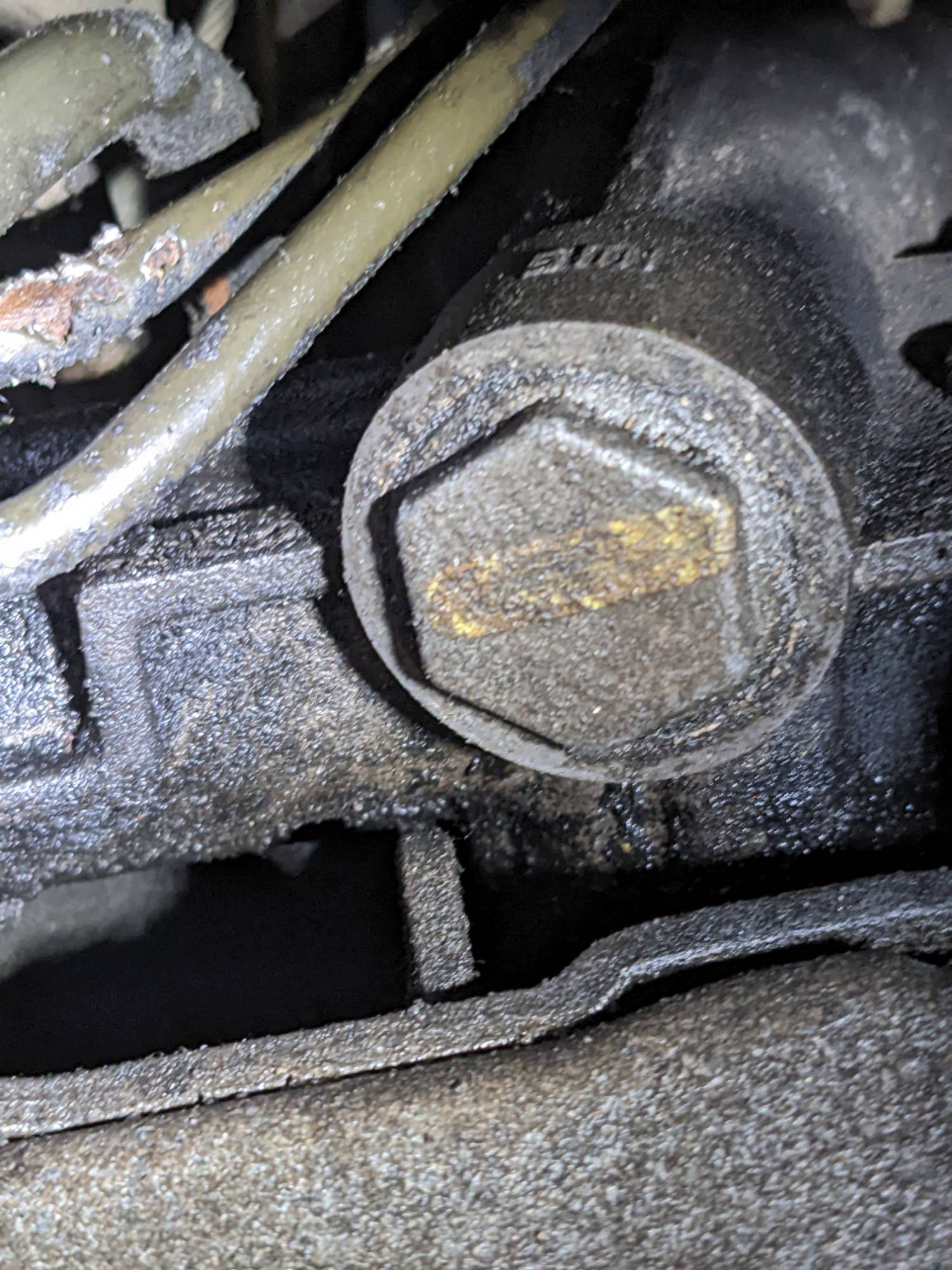

Clemens wrote: 05 Oct 2022, 00:08 Are the ps racks identical on all FWD p80 models or were there different suppliers?
Here's the SMI rack hexagon at the base of the steering shaft. When looking from the front of the car to the rear, right above the hex is a tiny raised logo "SMI".
This also may be a good illustration of what a failing rack looks like, covered in fluid and grime. I'm still trying to clean it to find out. I took this picture AFTER doing an initial cleaning......
SMI rack stamp
SMI rack stamp
