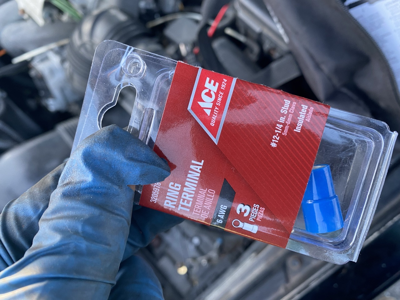

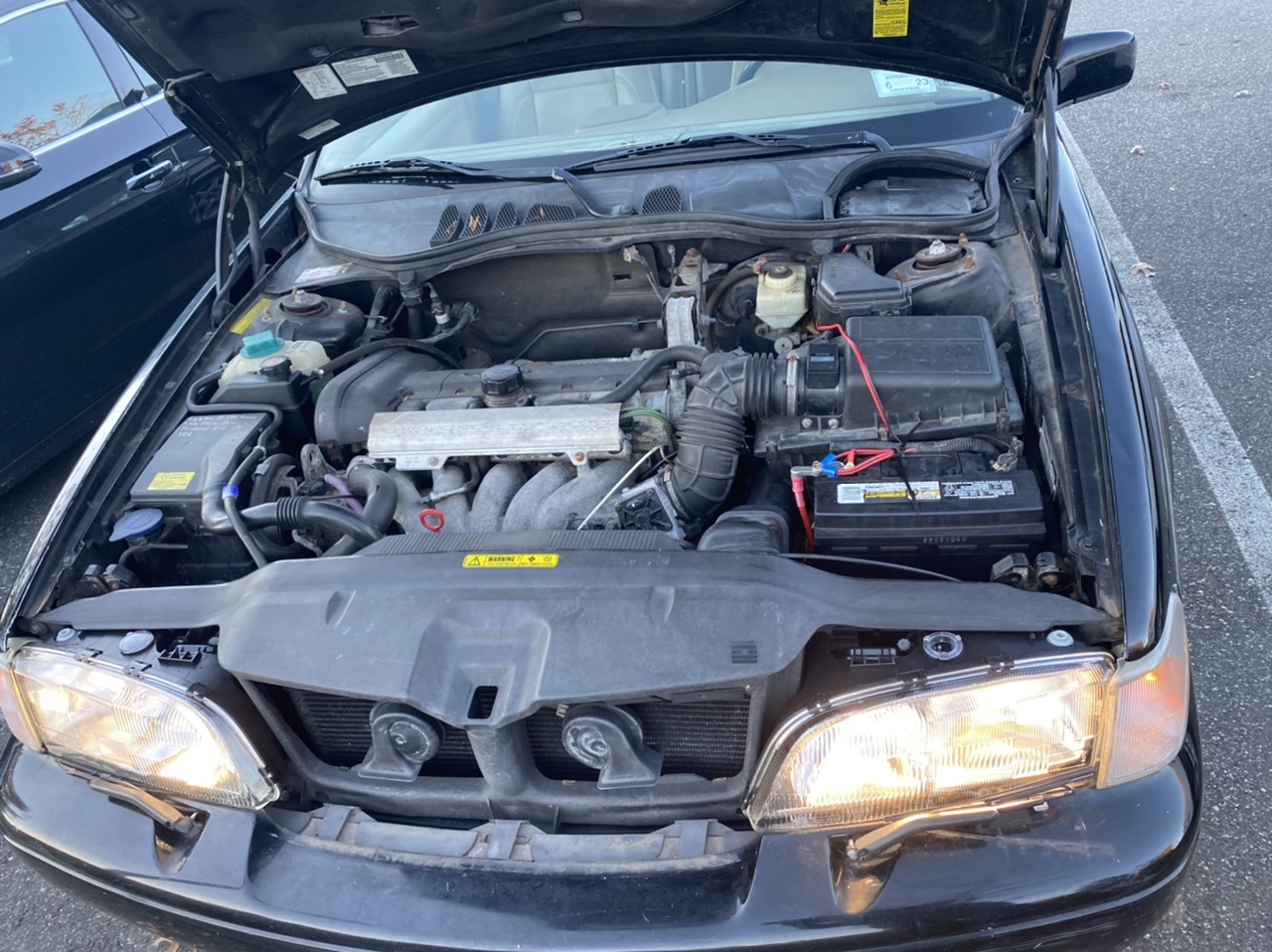

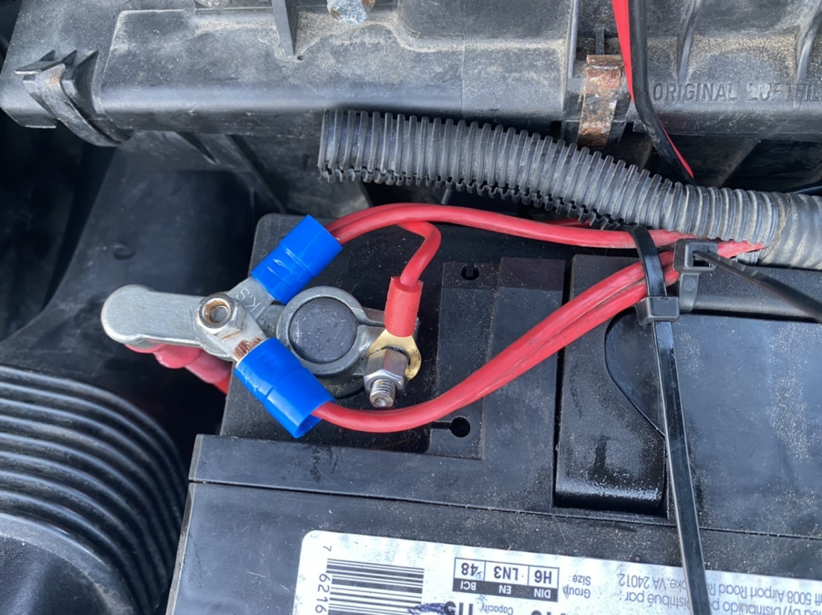

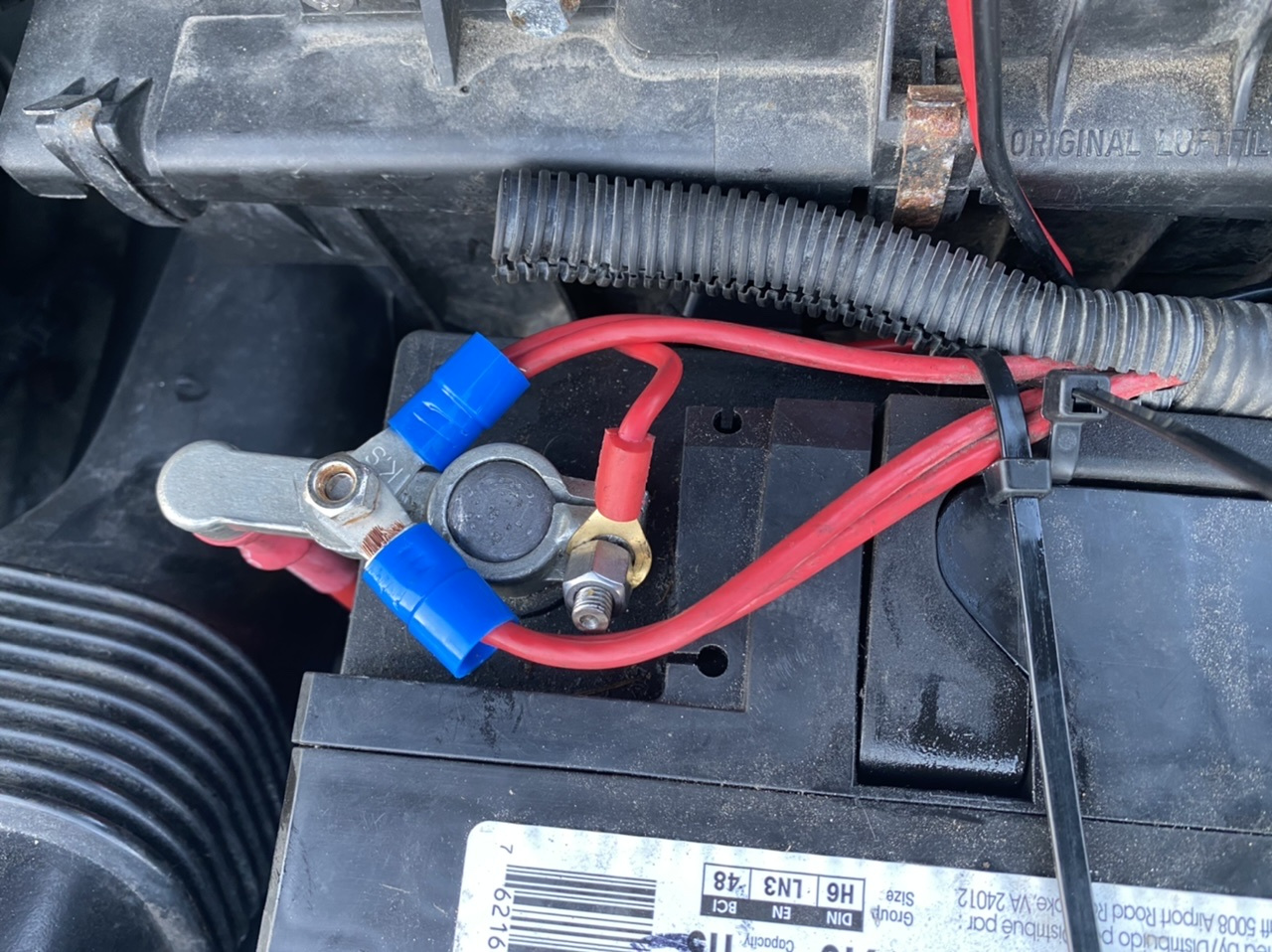

Drove Evita last night and headlights were Terrible. I had two TYC units on Island so slapped them in
Broke the main bus wires going into terminal so effected repairs

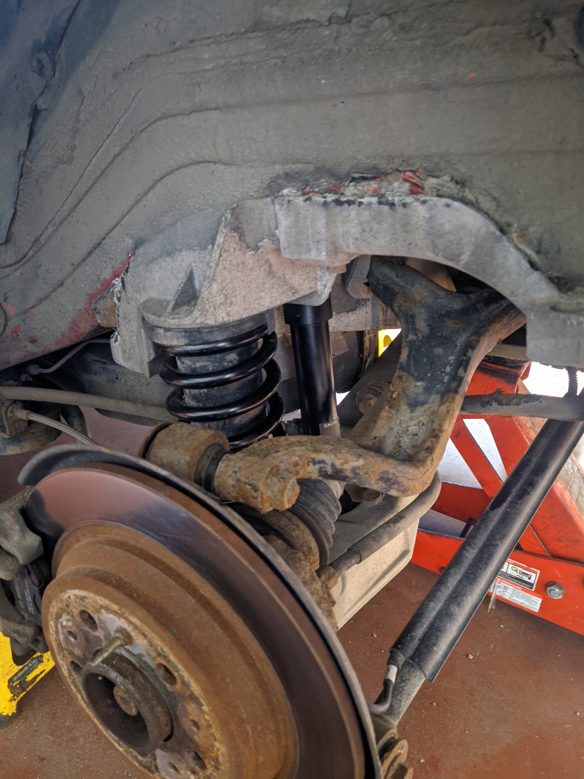

I changed out my Nivomat rear shocks and springs. Right shock was leaking. Used the Lesjofors springs that said they were for V70 AWD without self leveling suspension, and factory Volvo shocks. So far, ride is much smoother.

Check the condition of the rear sub-frame. Looks ok for what I can see, but the area which corrodes badly is around the rear mounting bolts through the frame into the main steel frame. You can see how the aluminum is being 'nibbled' along the upper edge and that is the start. Try to see if you can clean it off and paint it or clear coat as much as you can to save it for as long as you can.

I have been wanting to drop my subframe for a year now. I have a spare subframe from a 2000 XC70. But my left fuel tank sender float sinks or jams so I need to drop subframe to replace that, and check over fuel lines.
