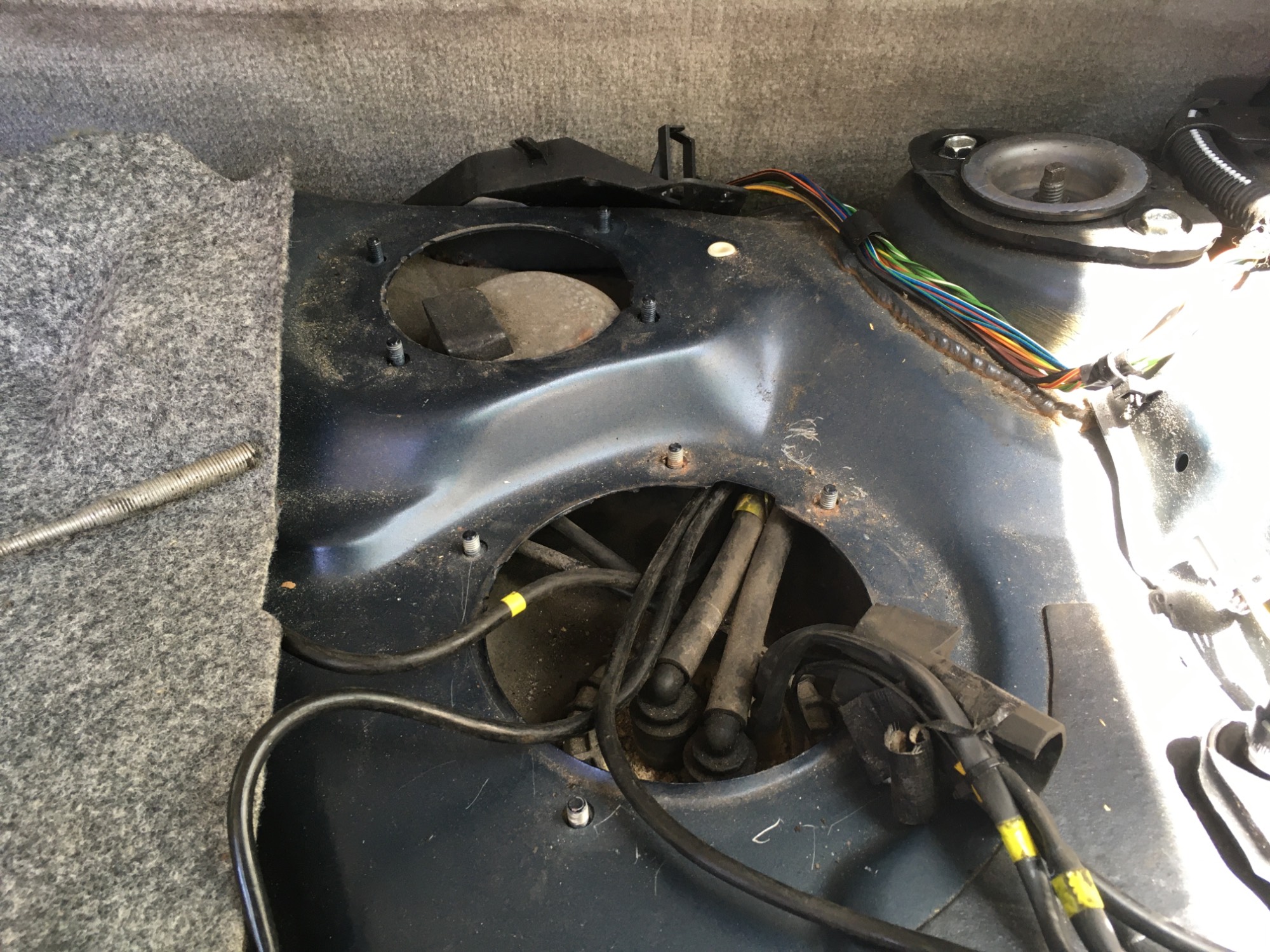

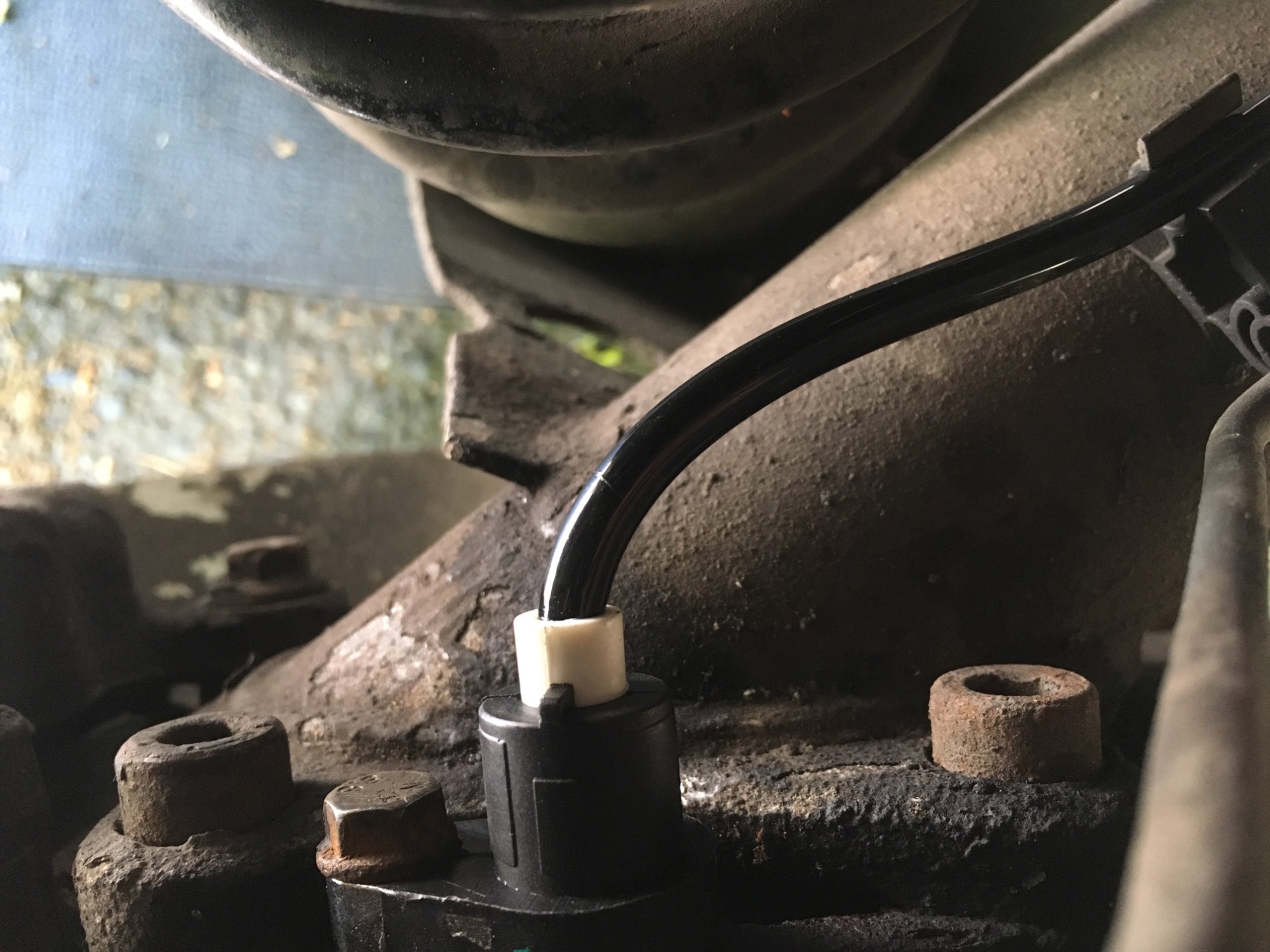

bmdubya1198 wrote: 04 Jun 2022, 08:40 You don't need to drop the tank, the connector is accessible under the cargo floor, right near the fuel pump access panel. It might take some creative fishing to get the new one in place, but it's not too hard.
Thanks! Although it wasn’t the most elegant way to do it, I snipped the old connector, pulled out the wires from below, ran the new connector up through the secondary access panel and then scooted the wires back toward the correct position.
The sensors took a bit of wrangling to get loose, as there was a lot of crud in there. I cleaned out the opening with brake cleaner and a rag, and the new ones went in easily.
1998 Volvo V70 fuel tank access panel
1998 Volvo V70 rear ABS sensor newly installed
