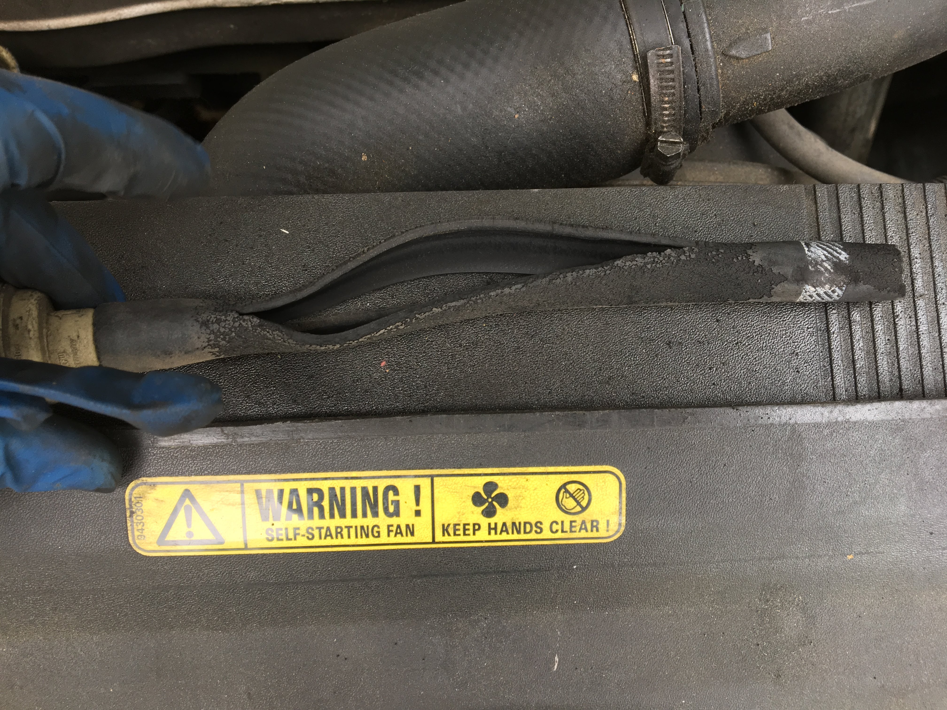

Find the vacuum hose in front of cylinder 3, pop it off, then pull the hose out to the driver side and inspect for holes

Gonna do that tomorrow... the one in the middle of the intake manifold? It’s definitely cracked at the fitting, so I’m sure the rest of it is pretty bad. All of the vacuum hoses I’ve noticed are pretty dried out, so checking and replacing those is on the list.

Fixed a pretty significant vacuum leak on the R today. The pulsing idle isn't as bad now, but it's still there. I'm going to go through the rest of the hoses through the week. The 740 is still driving me nuts with its no fuel condition.
This was the right side of the hose in the middle of the intake manifold, past the check valve.
