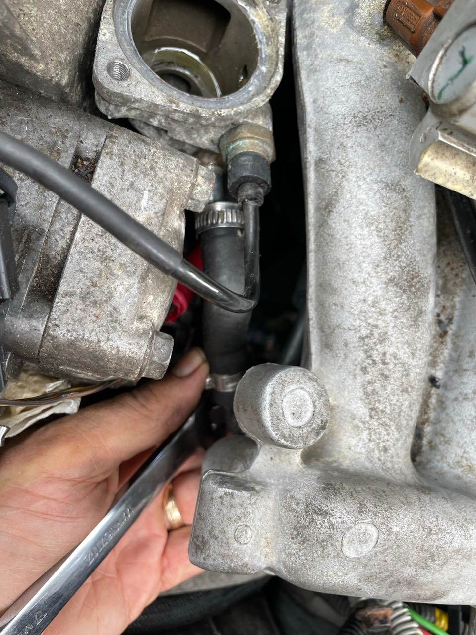

Solved my running out of gas problem by replacing throttle body.
However, victory was mine….thanks to Glenn!!
Also, 5 minute banjo bolt on the intake manifold
Pcv attached
Coolant bleed hose not attached
IM threaded on fuel line
Lift IM, prop it up, thread banjo
17 mm to tighten
Seat IM
Attach coolant hose
Double check that vacuum line didn’t pull off PCV. Can be attached with forcep through IM
Pcv attached
17 mm to tighten
Seat IM
Attach coolant hose

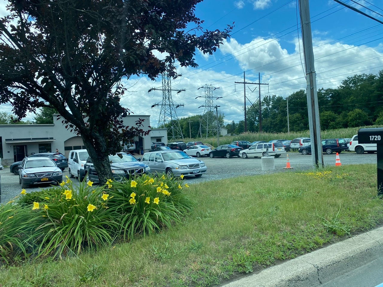

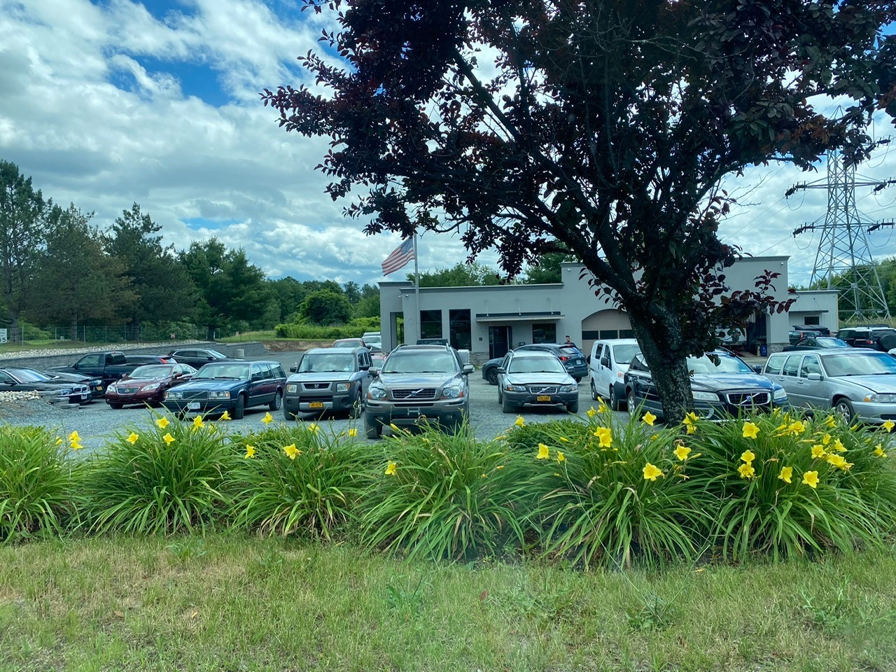

That shop looks interesting. He's got one or two Volvos.
