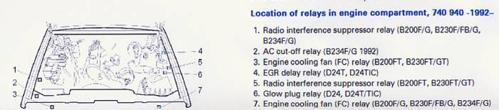

I'm doing a good job of confusing you, for which I apologize.
FI = fuel injection and found its way into my post because I was copying from my not so little cheat book and that was how my friendly Volvo tech had written it down.
Now that you have queried the exact locations of the relays I have dug a little deeper looking specifically for the 16 valve engine and come up with a diagram:
Relay 1 is the radio suppression and relay 7 is the cooling fan. If I was checking this I would take the cooling fan relay to the radio suppression relay wiring, connect it up and see if we had a starting engine. The two relays are exactly the same - Volvo part number 1323592.
Why did Volvo put relays in different places on different models? Answer: to make it more difficult for DIY and non-Volvo techs to work on the cars.
Hopefully this will help.
Bill.
Bill.
