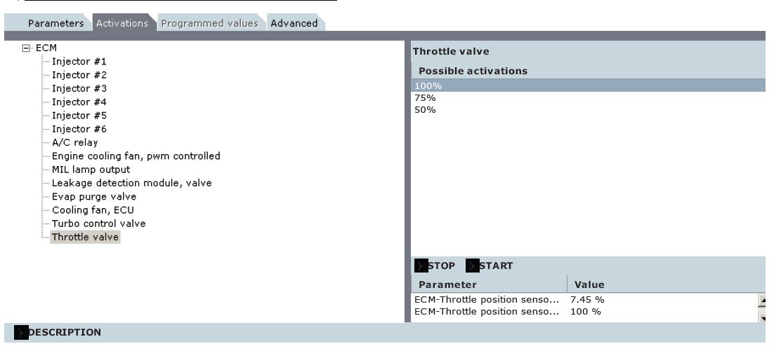

Mike
As you know I am very very new to Dice / Vida, I get lost in the pages.
I once got the measures of MAF, not that there is no MAF malfunction reference, I don't remember where it was!
2
Is this where I have to go to activate TB?
My Stat / Stop don't make any change
3
I followed the instructions on this "TB adaptation.pdf" page.
Sorry, but I get lost at the Highlighted lines.
Thanks

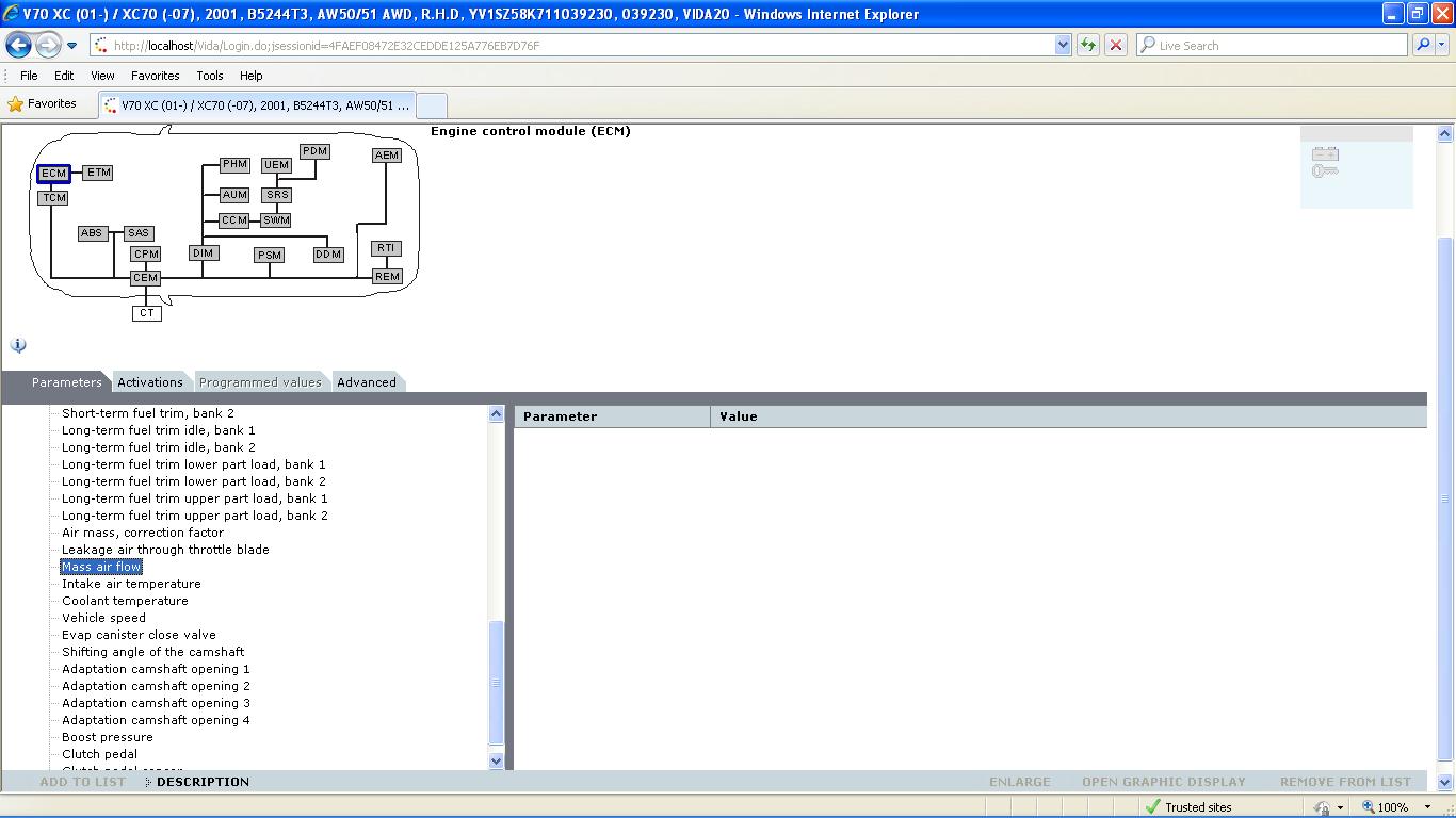

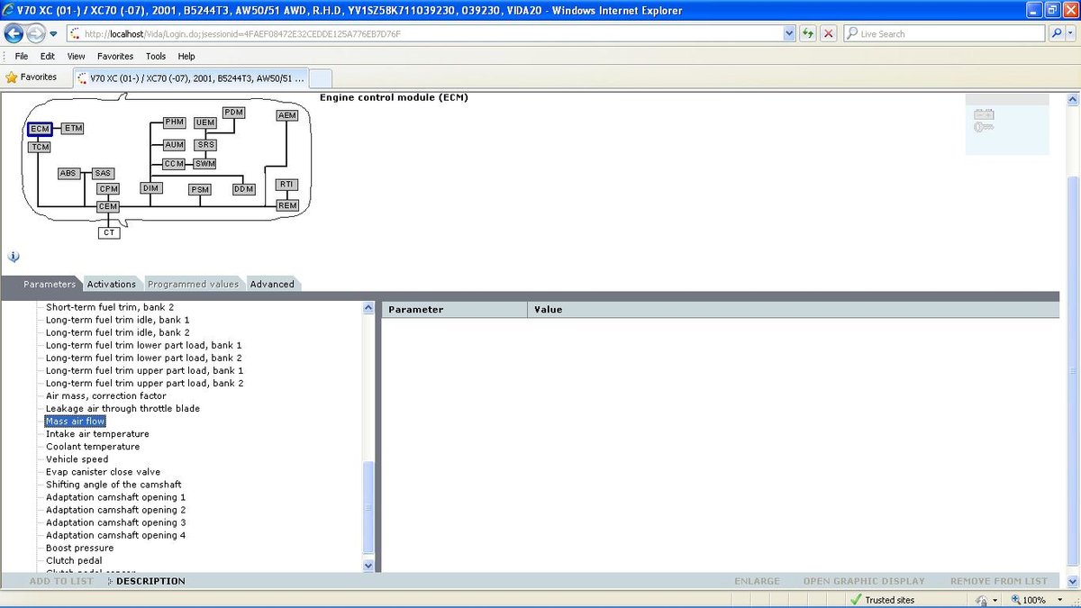

If it's not in Activations Tab then it must be in Parameters or Advanced
I think you're forgetting that you need to click on the ECM icon in the diagram showing all the modules.
In any case you'll need the ECU/ECM removal tool from IPD or dealer. Call IPD on Monday
