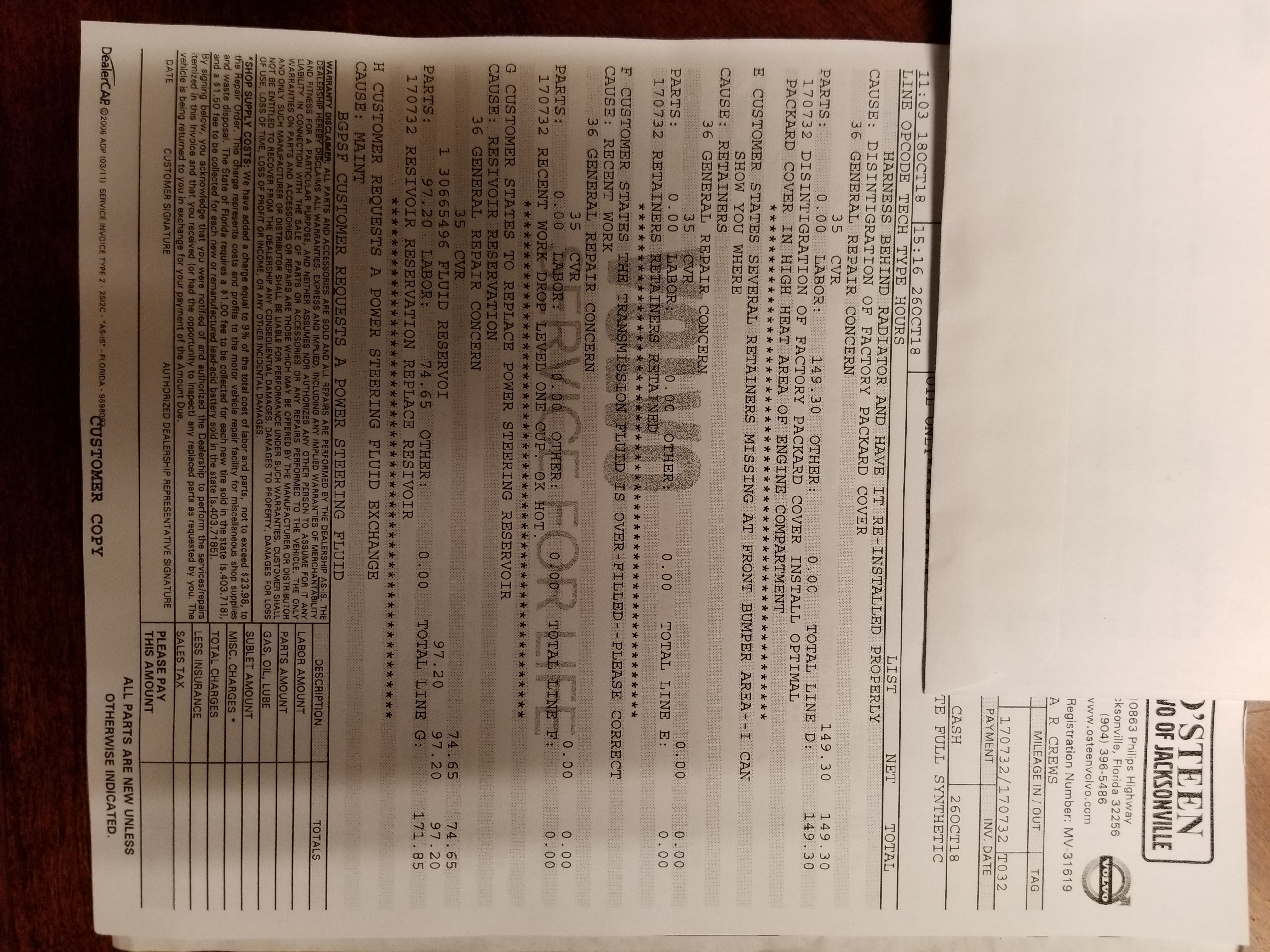

170,732 miles October 26, 2018
Line A, Oil change Redline 5W30 grade Volvo filter.
$60.55
Line B labor only part prepaid. Replace both A pillar fabric panels $74.65
Line C vibration during acceleration
Replace Passengers side axle NC Volvo lifetime warranty paid
Line D replace wiring covering under hood.
Labor only $149.30
Line E wiring loom retaining clips broken replace NC
Line F overfilled transmission fluid NC
Line G replace power steering auxiliary reservoir
$171.85
Line H power steering fluid exchange $209.30
Line I secure a cap on sensor on intake tube that does not belong to this model. NC
Line J Alignment NC
Ticket total $737.88

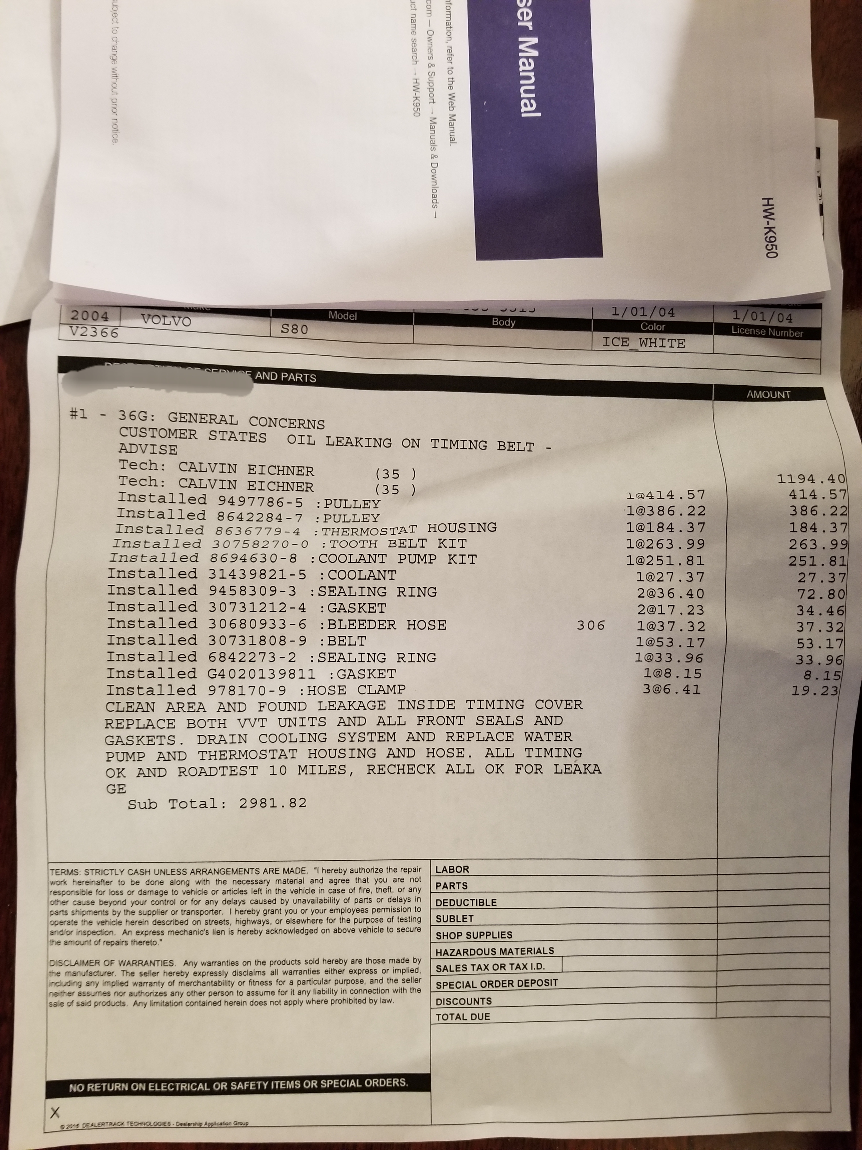

February 6 2019
I took the car in for a oil leak in timing belt area.
#1 VVT hub leaking oil. Full timing belt service required, customer requests water pump kit and thermostat kit be installed.
Labor $1194.40
1 @9497786-5 pulley $414.57
1@8642284-7 pulley $386.22
8636779-4 thermostat housing $184.37
30758270-0 tooth belt kit $263.99
8694630-8 coolant pump kit $263.99
31439821-5 [email protected]
9458309-3 sealing ring 2@ 36.40
30731212-4 gaskrt2@$17.23
30680933-6 bleeder hose 1@$37.32
30731808-9 Belt [email protected]
6842273-2 sealing ring 1@$33.96
G4020139811 Gasket 1@$8.15
978170-9Hose clamp [email protected]
Subtotal $2981.82
Bill charged $2927.05

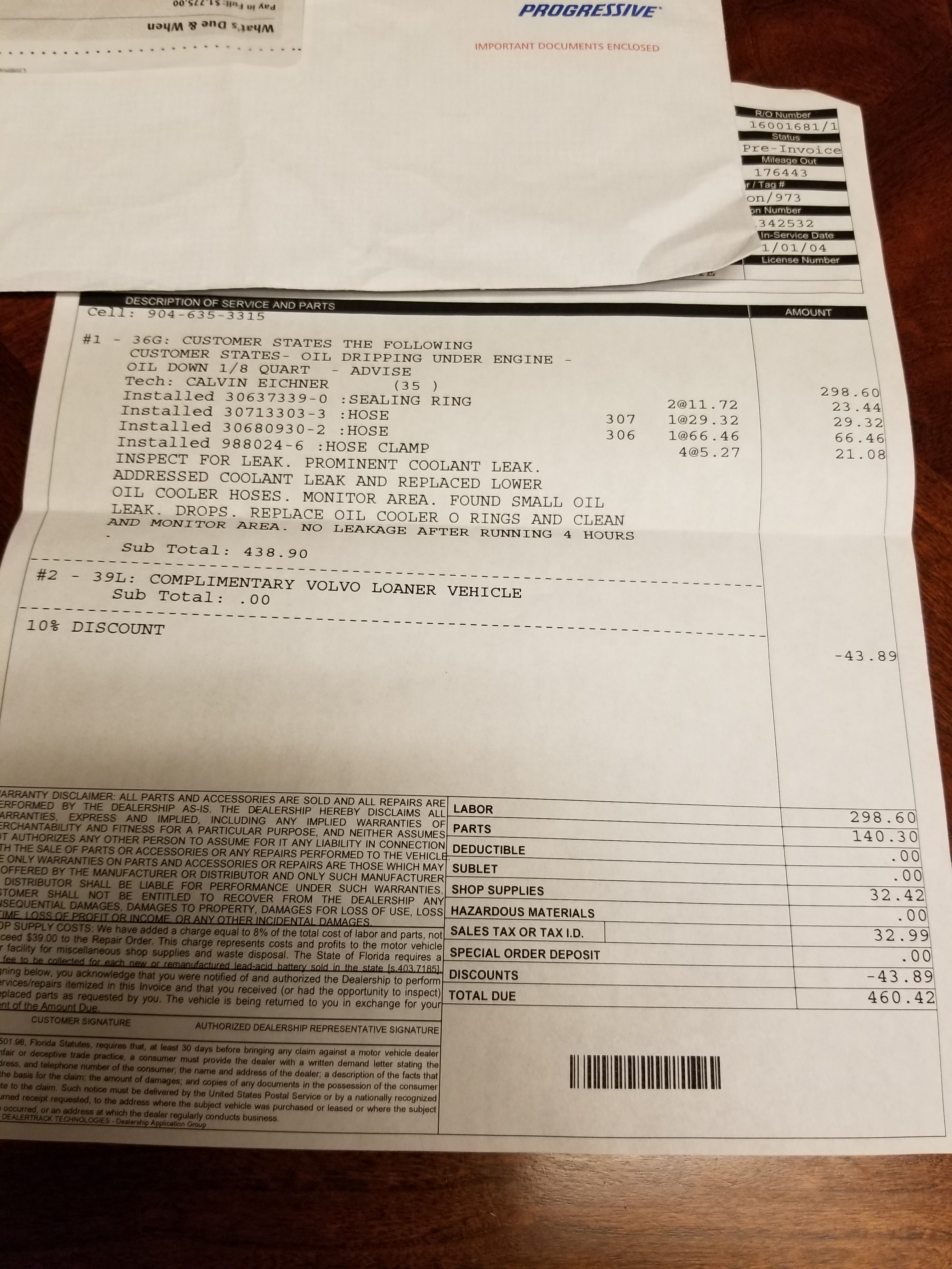

2/21/2019
176,443
$460.42
Osteen Volvo service. Leak under car. Cooling lines to oil cooler leaking.

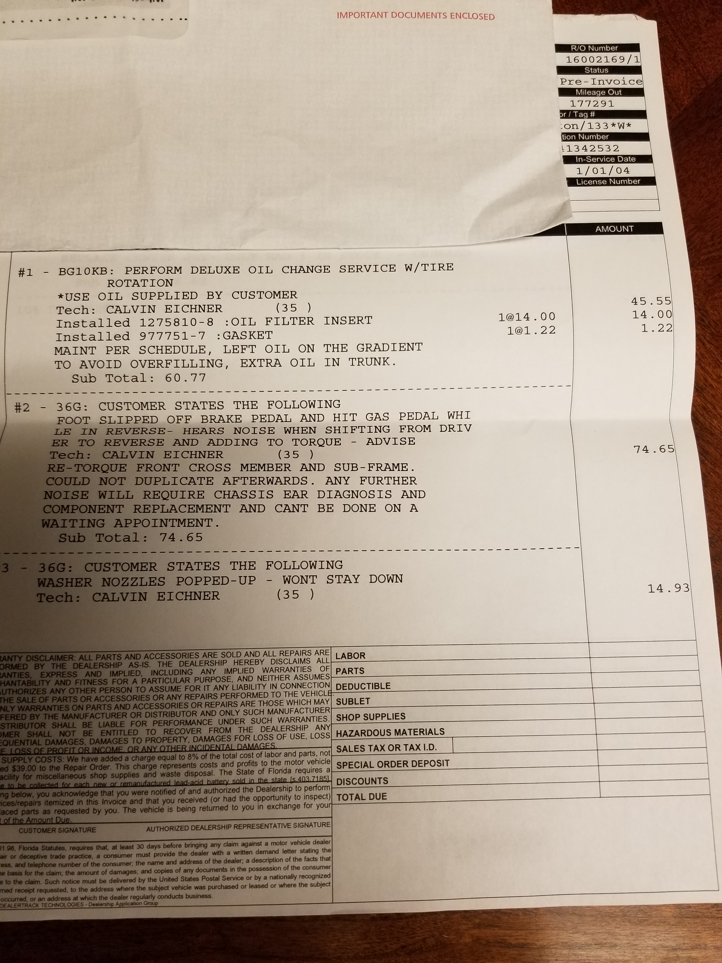

3/8/19
177,291
$172.79
Osteen Volvo Service
Oil change
Replaced spray nozzle

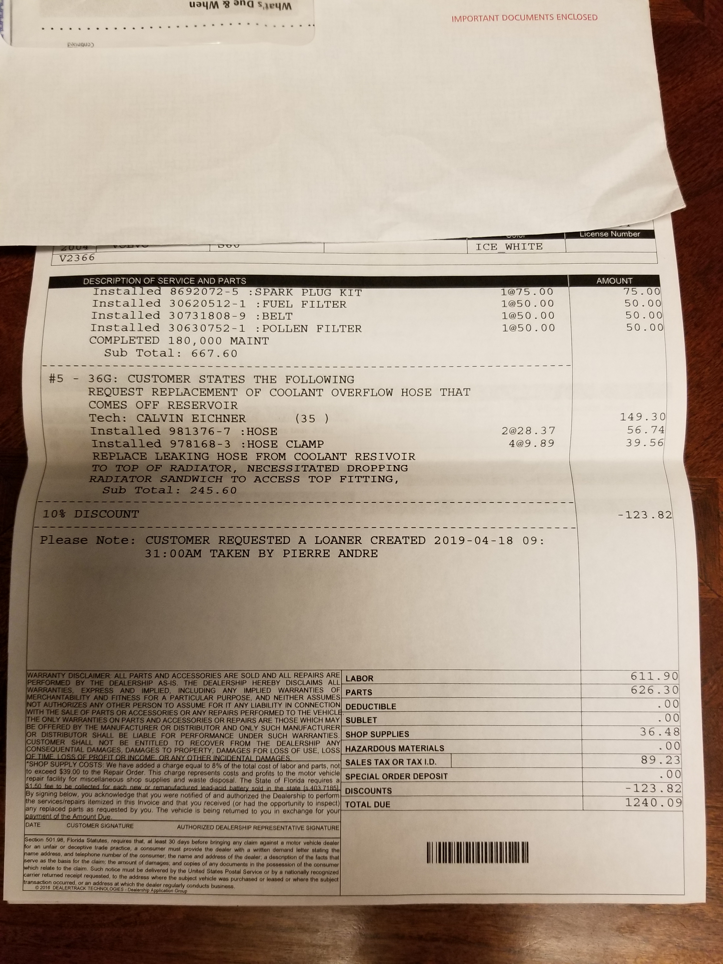

4/26/19
180,269
$1,240.09
Genuine Volvo transmission fluid exchange.
180K service
Replaced coolant overflow hose

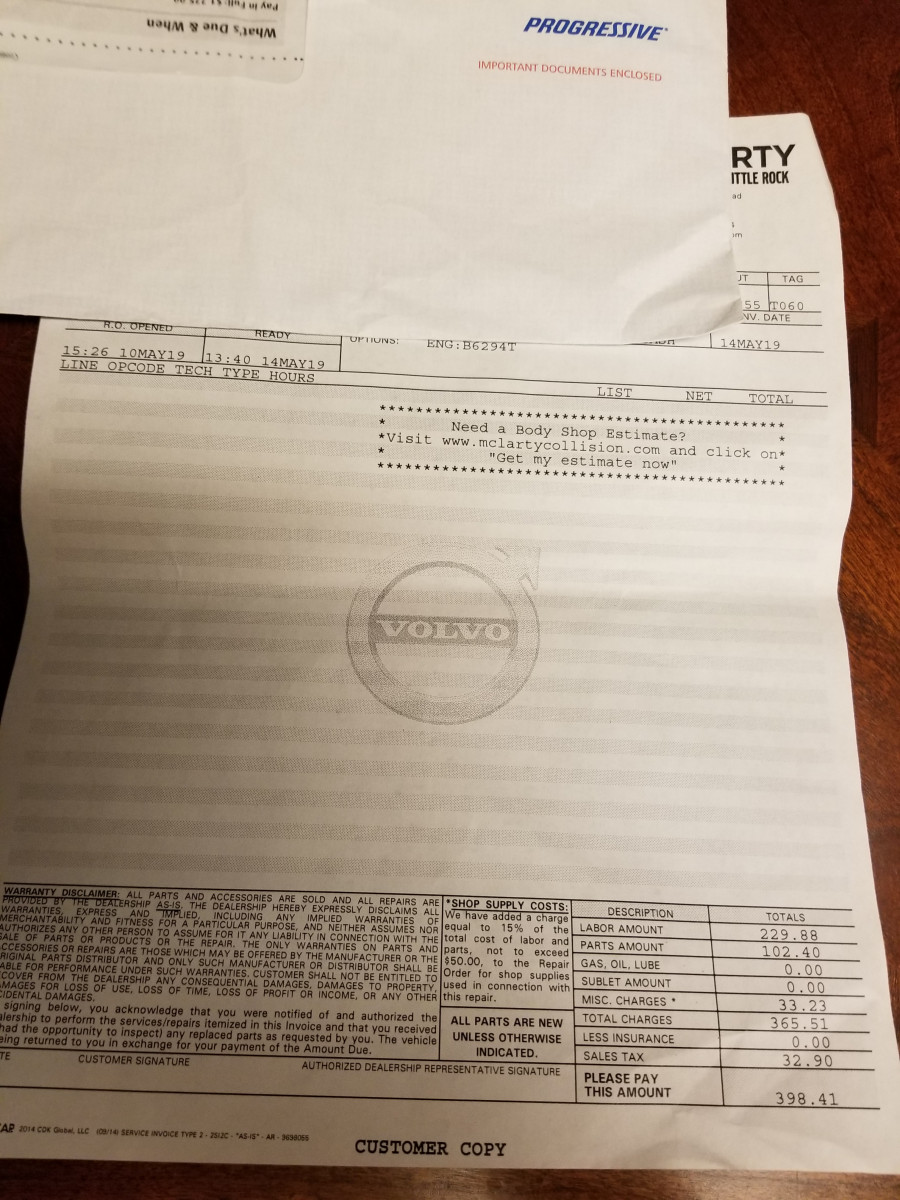

5/10/19
181,853
$398.41
McLarty Volvo Cars Of Little Rock
Parking breaks died while away on family emergency.
