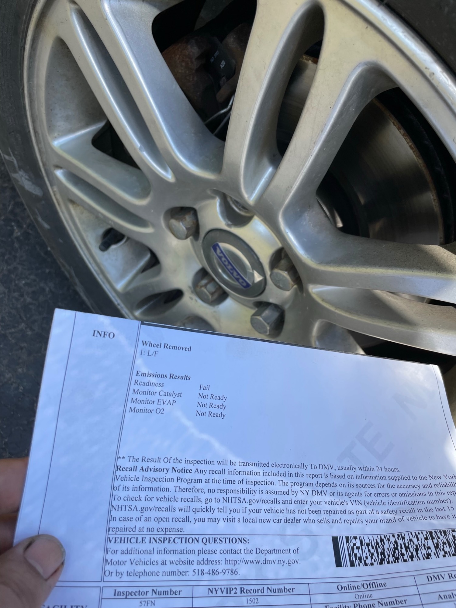

Did the worlds fastest left hand drive axle change on Shagg, diagnosed by bad knocking on float, which disappeared on braking or acceleration……
By tightening the loose lug nuts the inspection shop left , I had to replace one lost one.

abscate wrote: 29 Jul 2022, 19:13 Did the worlds fastest left hand drive axle change on Shagg, diagnosed by bad knocking on float, which disappeared on braking or acceleration……

New York requires them to document the wheel they removed to inspect brakes and write it on the invoice.

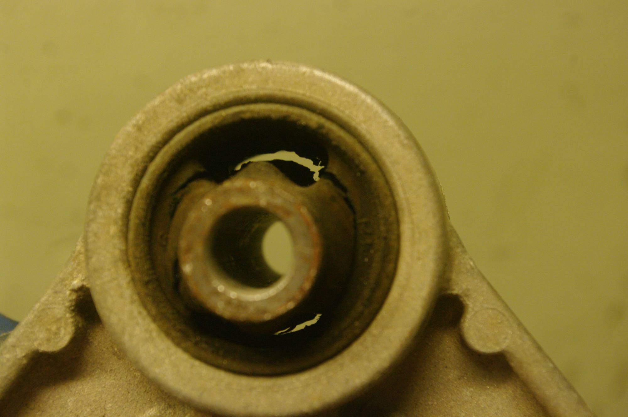

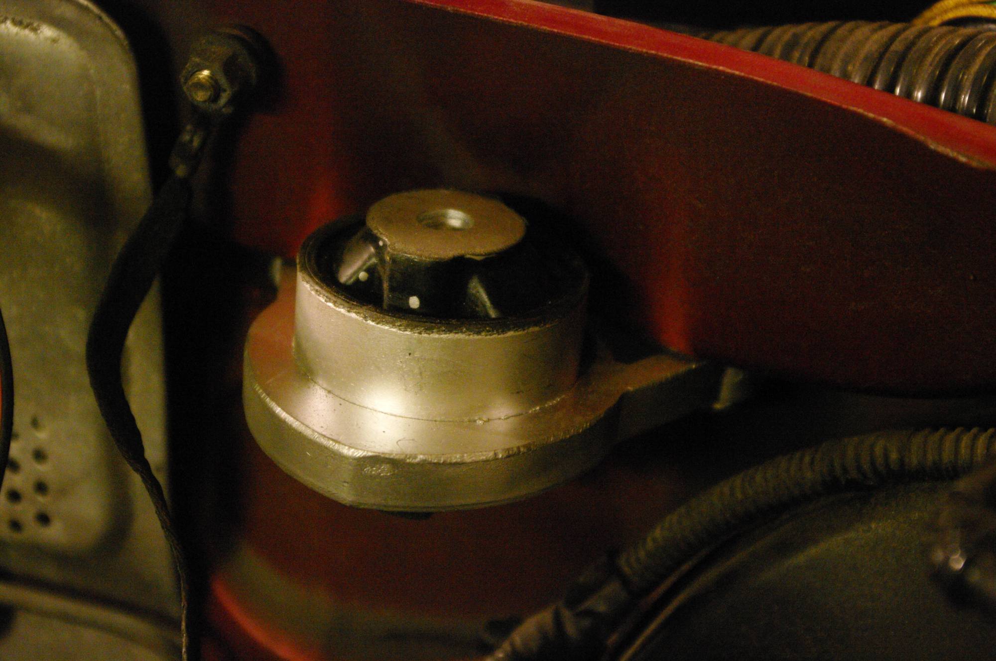

Started the process to replace the upper torque bushing, 9434263, and the bracket flopped around like a stunned mackerel.
8631159
If the weather cooperates, the press-in part happens next. This car may join Neil in the PITA Club.
