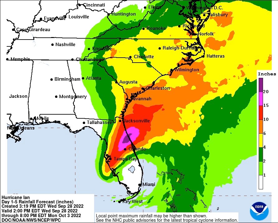

You're gonna get hurrakanned and rained on down there! 4-6" according to this NOAA chart.

Get them soaped up and ready for a rinse!!

Yeah, I hope it blows through quickly. I'm already mad that it's gotten so cold here... barely hit 70 yesterday
Rain is just icing on the cake.
