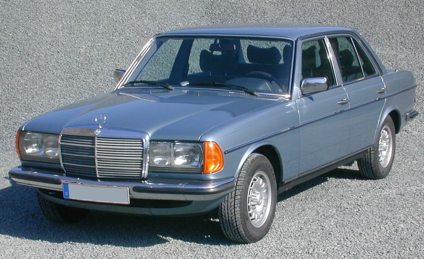

The 1960s 4-door was the W110 series - the 190, 190D, 200, 200D, and 230 straight 6. They had fins!
In 1968, the W114 / W115 series replaced it. Designed by Paul Bracq, they had an all new suspension design and were the first to be extensively crash-tested. The W114s were 230, 250, and 280 straight sixes, while the W115s were 200 straight four gas and 200D diesel, 220, 220D, and 240D.
"The Mercedes-Benz W115 is known to be a very durable car. In 2004 Greek taxi driver Gregorios Sachinidis donated his 1976 Mercedes-Benz 240D to the Mercedes-Benz Museum Collection with 4.6 million kilometres (2.9 million miles) on the odometer."
The W123 series extended from 1976 to 1986, with a "reputation of being well-built and reliable."
In Mercedes-speak, C means coupe, T means touring or transport for wagons, D of course means diesel, and E means "Einspritzung!" or fuel injection.
Most of the engines carried over from the 114/115 series, except the new overhead cam 2.5 six.
Models based on engine size were -
230 same
250 straight six gas
280 same
200D straight 4 diesel
220D same
240D same
300D straight five diesel
300D straight five turbo diesel
These last diesels put out a whopping 123 hp, with 184 lb-ft of torque. You could have gotten a 280E straight six gas with injection and 140 hp. The four-doors weighed about 3600 lbs.
