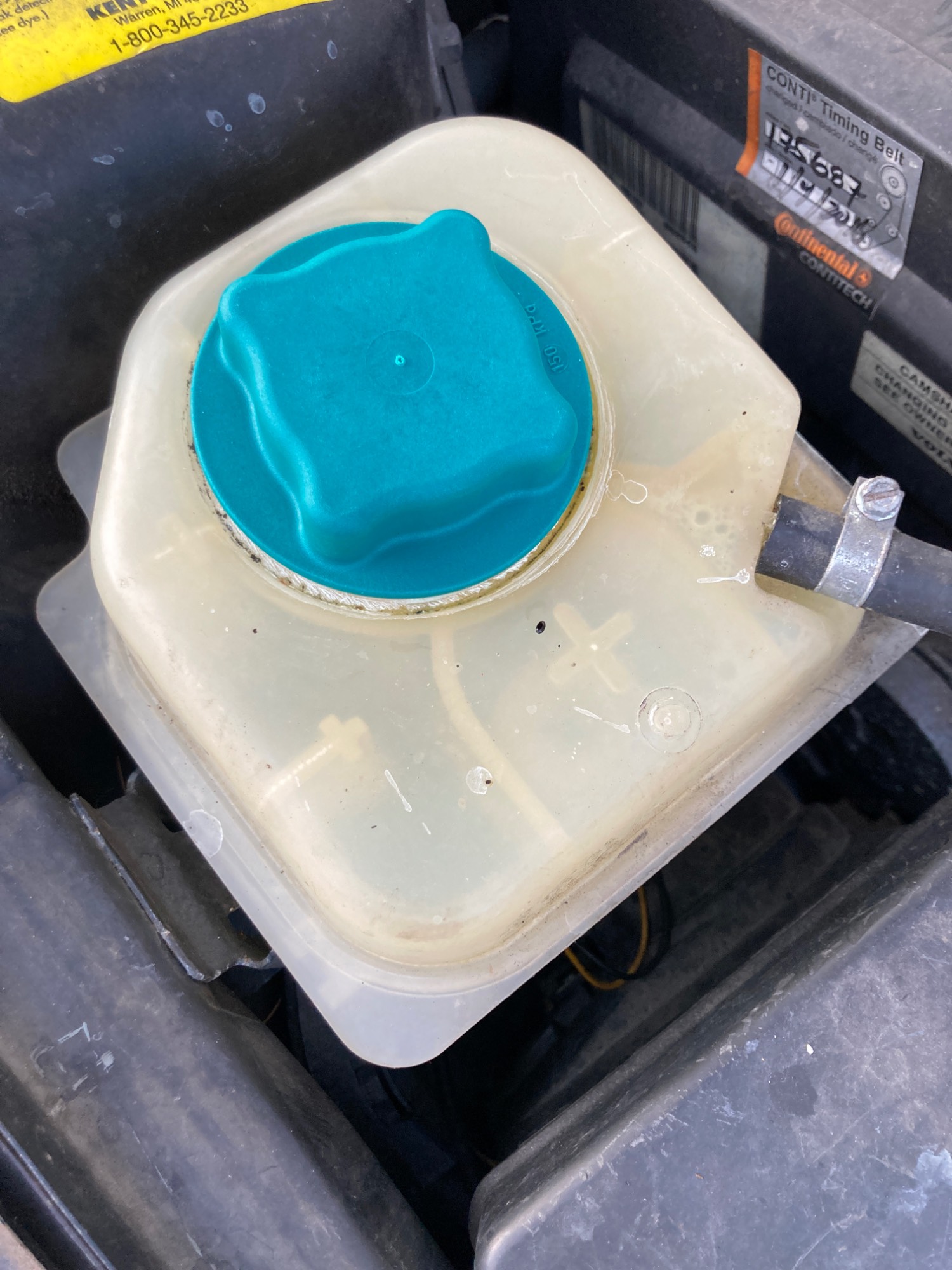

Agreed. Expansion tank cap failures on many cars are usually unrelated to anything but a crappy worn out cap. I feel like I replace the caps on mine and my brother's fleet of BMWs almost regularly. Either that or they have just failed one after another on each of the cars... which is honestly more likely. Good thing BMW used the same caps for about 25 years, much like Volvo did. Except Volvo did for even longer!

A lot of folks in X3 X5 land back off the stock caps for lower pressure ones to keep the system pressure down and prolong life of the cooling group stuff. I just freeCP them every 100k miles....
Bruno , let that smoke hit some cold paper and see if you get the sniff of coolant in the condensate. Plugs cap coil rotor wires all under 50k on realBosch parts ?

That makes sense to back off the pressure on an older system. Should I keep a the original spec 1.5 bar / 150 kPa cap or the .75 bar / 750 kPa cap?abscate wrote: 29 Dec 2022, 00:12 A lot of folks in X3 X5 land back off the stock caps for lower pressure ones to keep the system pressure down and prolong life of the cooling group stuff. I just freeCP them every 100k miles....
It has Bosch plugs that I put in less than 2,000 miles ago, but I haven’t done the cap, rotor and wires yet.

My suggestion is to replace the existing Gates part in any case. Volvo put the 22 pound cap on these cars originally to cover all their bases for any situation around the world. Since the boiling point of 50/50 antifreeze is something like 228F, and that number increases by 3 degrees per pound, a ten pounder ( .75 bar for the Euro-Centrics ) means the coolant has to hit ca. 258F to lift the valve in the cap. If it gets that high you have something else to worry about. If the valve vents without the temp spiking it will be obvious.brunocerous wrote: 30 Dec 2022, 06:04That makes sense to back off the pressure on an older system. Should I keep a the original spec 1.5 bar / 150 kPa cap or the .75 bar / 750 kPa cap?abscate wrote: 29 Dec 2022, 00:12 A lot of folks in X3 X5 land back off the stock caps for lower pressure ones to keep the system pressure down and prolong life of the cooling group stuff. I just freeCP them every 100k miles....
(As a side note, we ran a 35 pound cap on our NASCAR engines, running straight water [ antifreeze isn't allowed under the rules], and we regularly saw ~260 water temps, but tried to keep oil temp under 300.)

The stock caps on these Volvos are just fine, I haven't heard of any issues resulting from the pressure. I would keep the OE 1.5 bar cap.

Thank you, all. I added coolant and had more venting from the .75 bar cap. I swapped in the green 1.5 bar cap and drove the kids to their grandparents’ house about 90 minutes away with no apparent coolant loss and no more hissing.
