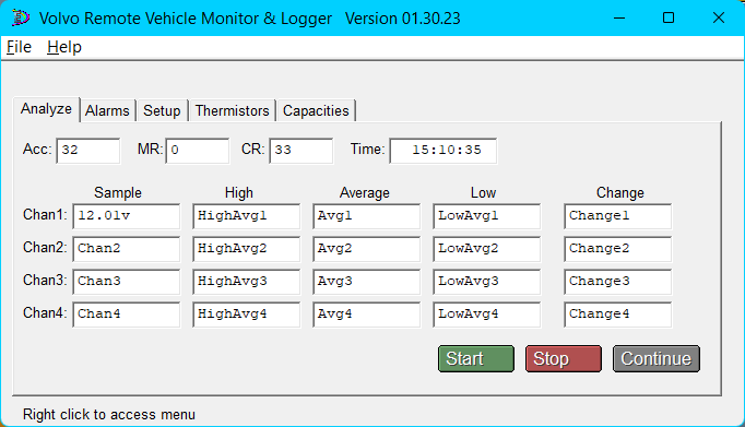

As to what i did, I have been working on my telemetry project mostly for measuring the car battery voltage remotely. I had to create my own monitor program because i didnt like the one i downloaded as it did not log the date and time with the data it received via USB port.
Here is a screen shot of the initial result. I am not using all that yet, just the voltage and the time really. The date and time and voltage are all logged permanently to a file on the hard drive. This may look simplistic but it doesnt have to have fancy graphics for me i just need it to show the results of the transmissions from the vehicle.
Later Channel 2 will be current and Channel 3 will be temperature. Channel 4 maybe insolation level.
Channel 5 for the Stock Market (ha ha).
