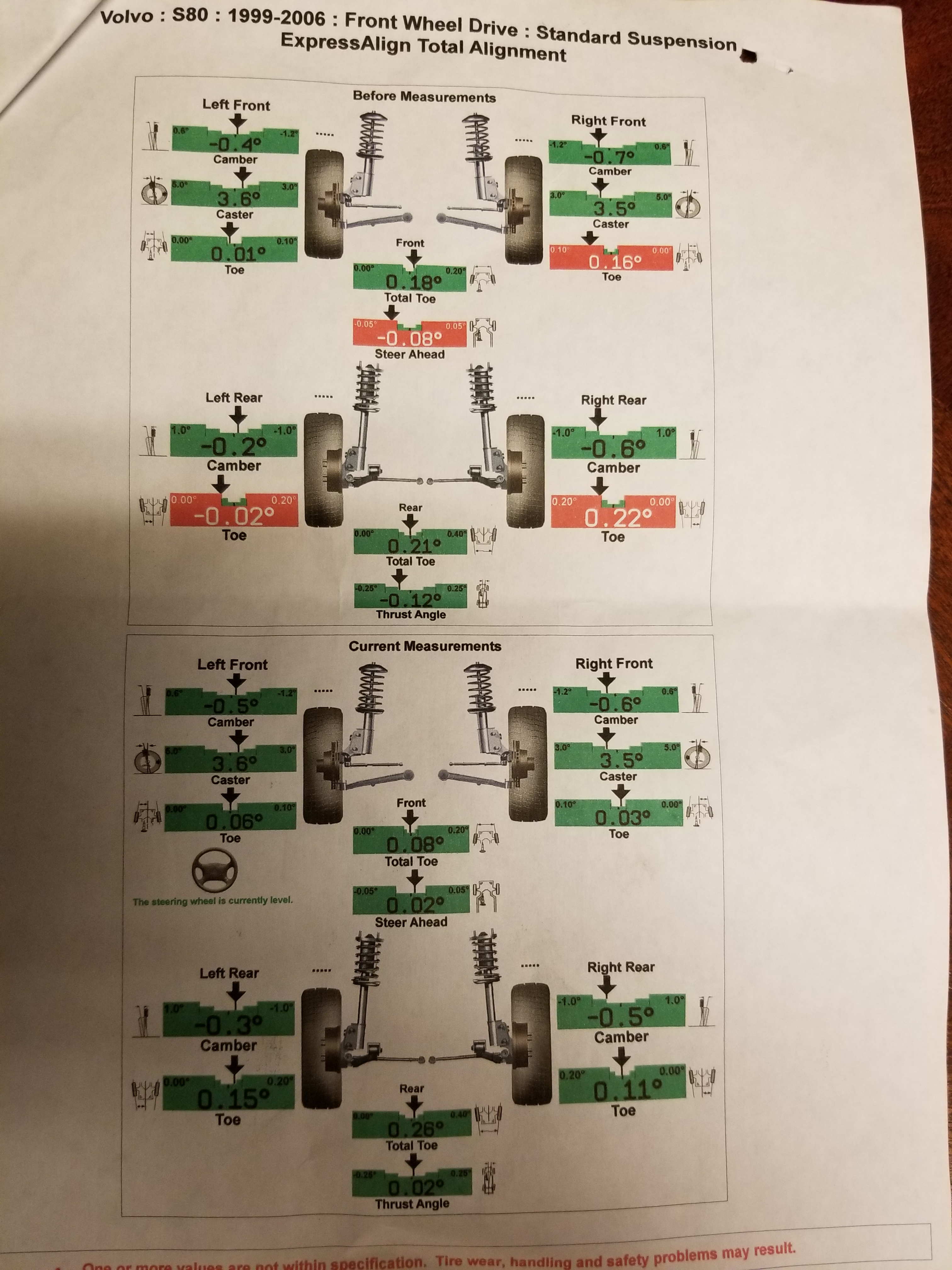

12/16/2019 dropped off 12/23/2019 picked up. I received delivery of the car 12/23/2003 so I got her back on her sweet 16th birthday!
193,093 miles
$869.91
Had a check engine light on for four days then went off last month, had a one time thump in the front end resulting in car loosing alignment, oil change, car slow to warm on cold days. Also needed car ready to run down South Florida to be with my daughter for Christmas. Attached is the repair ticket. June
193,093 miles
$869.91
