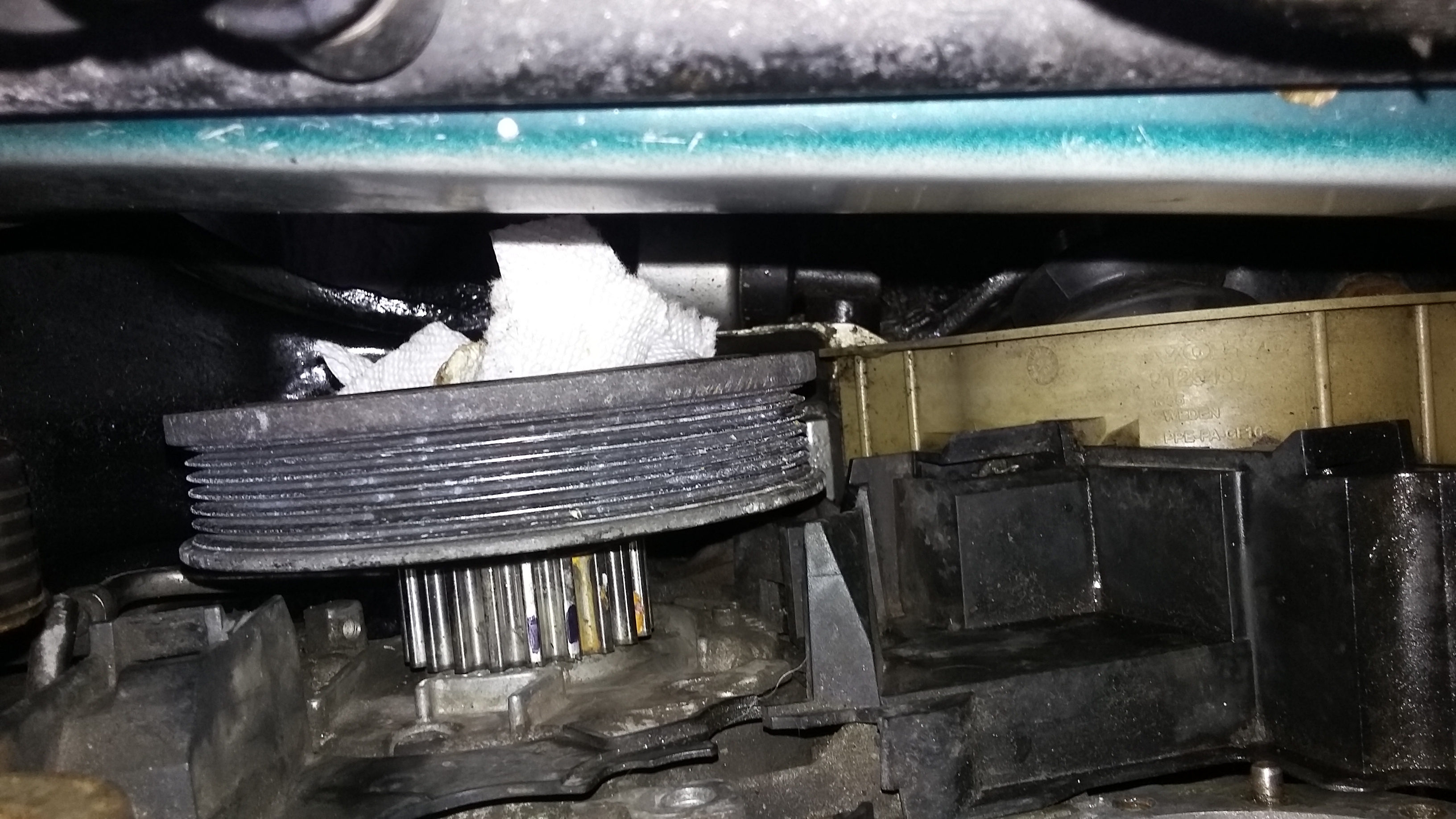

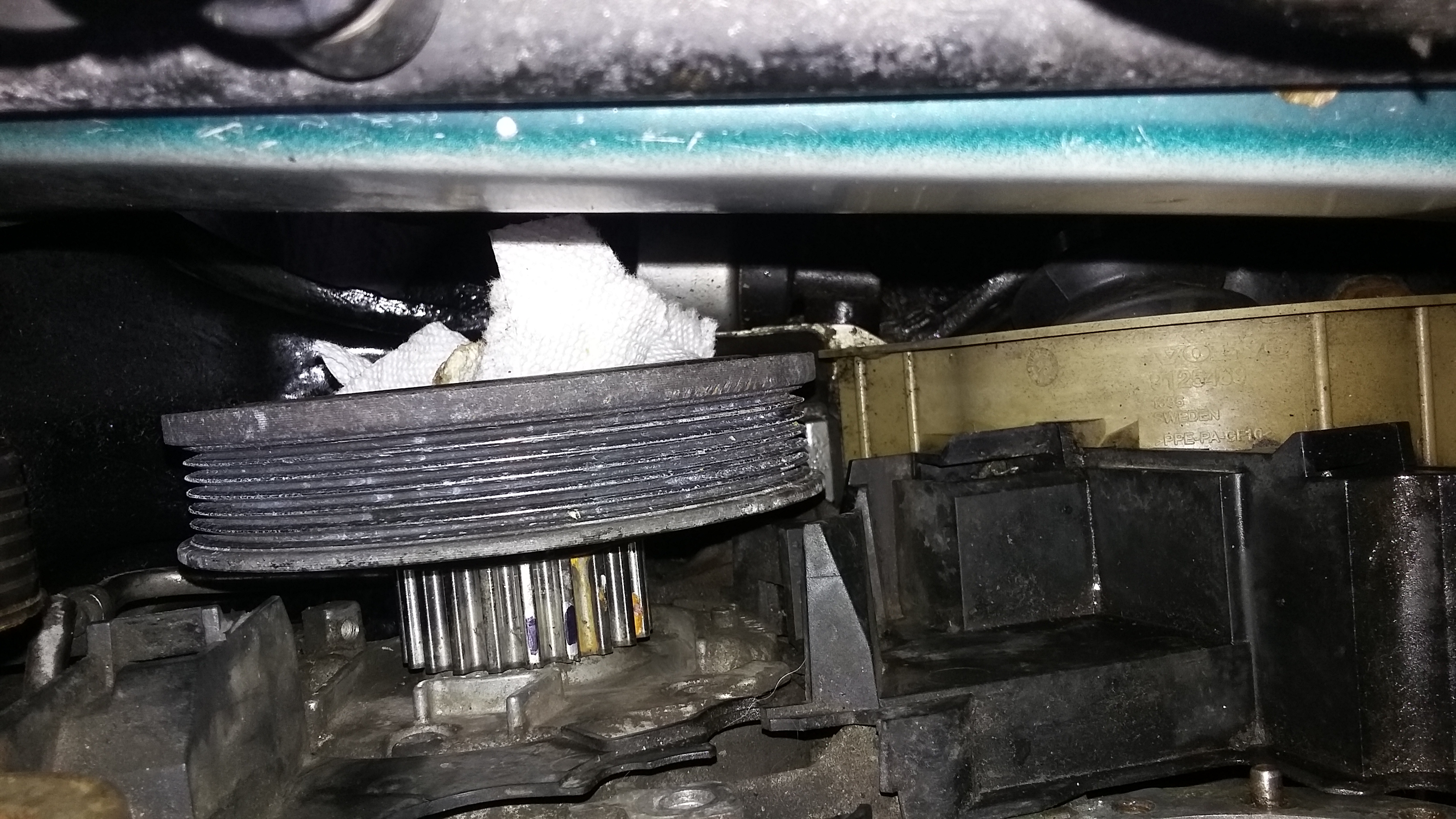

Hi can someone tell me if this the correct way to line up the timing marks? I've seen it a few different ways, Is the metal that's sticking out, On the left corner that where my crank marks should be in between?
I'm not a 100% sure.
Thanks guys.

It is correct.
When there are two marks on the crankshaft gear, you align the third mark to the valley between the two marks.

Ok thanks .. I seen where it's showing that the 2 marks are right in the middle of that piece or the metal. . Since I can't access Vida/dice I wasn't sure, didn't remember .
Thank you Rick
Thank you Rick
