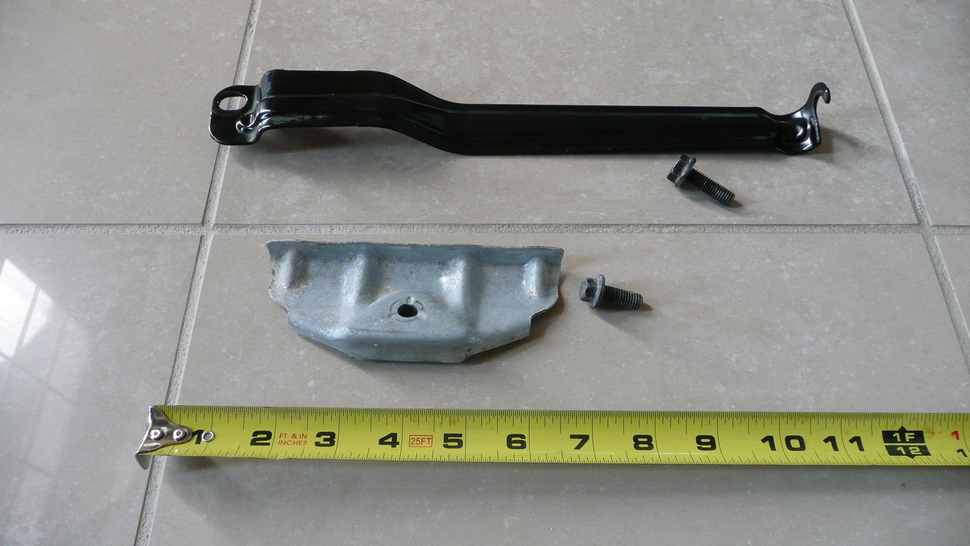

@gnalan,
I went to the junk yard today and got the part you requested.
I got these parts from a 2007 S60 3.2L car:
1- Battery Top Bracket (black) + one bolt.
Could not find the other bolt but you can easily find it at hardware store.
Make sure you have the correct thread pitch (I think it is M8 x 1.25, but please verify yourself).
2- Bottom Bracket + bolt.

I have the original top bracket and hardware for my battery, just not the hold down for the bottom of the battery which I thought was a plastic piece (but it didn't come with the car so I may be wrong).
The battery terminals are held onto the battery posts with 2" or 2.5" Phillips head cap screws and nuts that didn't want to hold very well. I put double nuts on them to help, but my battery cover won't fit over the longer bolts. Does anyone have the original bolts and nuts for the terminals to clamp onto the battery posts? I wasn't sure if I could just grab a set at the parts store that would fit or not. Does anyone know if those would work? The holes look smaller than the universal bolts are that I did see.
Right now there's nothing holding the battery down, and since it's new I don't want it sliding around or causing me more problems than I already have. Just putting the top bracket on without the plastic cover on first, or anything keeping the battery from sliding, didn't look safe with the long screws. I don't want the battery shorting out against the metal bracket, and blowing up. I had a battery that shorted to ground before, and it blew up in the middle of a 90 degree turn. Not much fun when nothing worked, and ending up in the ditch on a back road trying to find help. That was before cell phones, back in high school, but still not something I want to go through again.

Does anyone know standard nuts/bolts at hardware store work for battery cables?
PS: If you look at FCPEuro or other DIYs, the bolts are not that special:
- One end is square to avoid turning.
- Other than that nothing special.
https://blog.fcpeuro.com/how-to-choose- ... vo-battery

I removed the bolts and nuts from my 2004 V70 just to show you and others the dimensions.gnalan wrote: 24 Aug 2020, 16:43...The battery terminals are held onto the battery posts with 2" or 2.5" Phillips head cap screws and nuts that didn't want to hold very well. I put double nuts on them to help, but my battery cover won't fit over the longer bolts. Does anyone have the original bolts and nuts for the terminals to clamp onto the battery posts? I wasn't sure if I could just grab a set at the parts store that would fit or not. Does anyone know if those would work? The holes look smaller than the universal bolts are that I did see....
For the P2 cars, I don't think Volvo sells the battery cable bolts and nuts for the P2 (S60, S80, V70, XC90) cars...I might be wrong though.
The bolt is M6 x1.0 x 25 mm. The square end is nice bc it prevents spinning.
In the absence of square end bolt, use generic M6 bolt, just use a separate wrench on the bolt head to prevent spinning.
However, you can use the bolts and nuts from the Volvo 240, 850 era. The PNs are:
- Bolt 987526...$3 or so
- Nut 987529...$3 or so
Just snug it with one finger so you don't strip it. No need for massive torque, which is what stripped them to start with.
People at local Advance Auto, Autozone etc. tend to over-tighten these nuts/bolts and strip them.
If you google "Ford Battery Cable Bolt 1/4-inch", you will see they sell a set of 2 bolts/nuts (good for one car) for about $2-$3.
Recall that 1/4 inch = 6.35mm, which *should* work for Volvo S60.
Anyway, photo of the Volvo factory bolts/nuts...

Thank you for pulling and measuring yours for me.
I'll see what I can find at ACE, sometime this weekend, and see if they have square head bolts that size.
