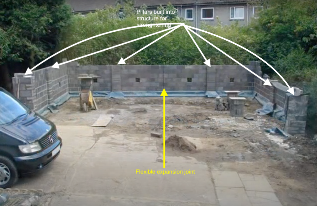

Sorry to keep going off topic, but I have a question -
These seem to be solid concrete blocks, not hollow blocks with reinforcing bars and vertical grouted cavities. They aren't just stacked, are they? Are they put up like a large-scale mortared brick wall? Where is the reinforcing?
Like Sveedy, just curious.

Yes solid concrete blocks with mortar between and pointed. They don't require any reinforcement, the back wall is in two parts with a flexible join in the centre running vertically top to bottom

^ Well that is a bit different. In this neck of the woods it would never meet code.

I should know better, than to question those who have been building a few centuries longer than we have. Not many castles here abouts

Building codes in UK and EU are much more stringent than most any US State or local code.
- Posts: 15503
- Has thanked: 2209 times
UK codes are pretty hard on the person trying to build anything. Here in Calgary they have clear rules and multi-point inspections at various stages by plumbing inspectors, electrical, structural and final inspection. Like all things you get good people and bad doing the inspections. Luck of the draw who you get on the day. Fortunately, all the ones we got during the house renos and then the garage build were fair and easy to work with.
