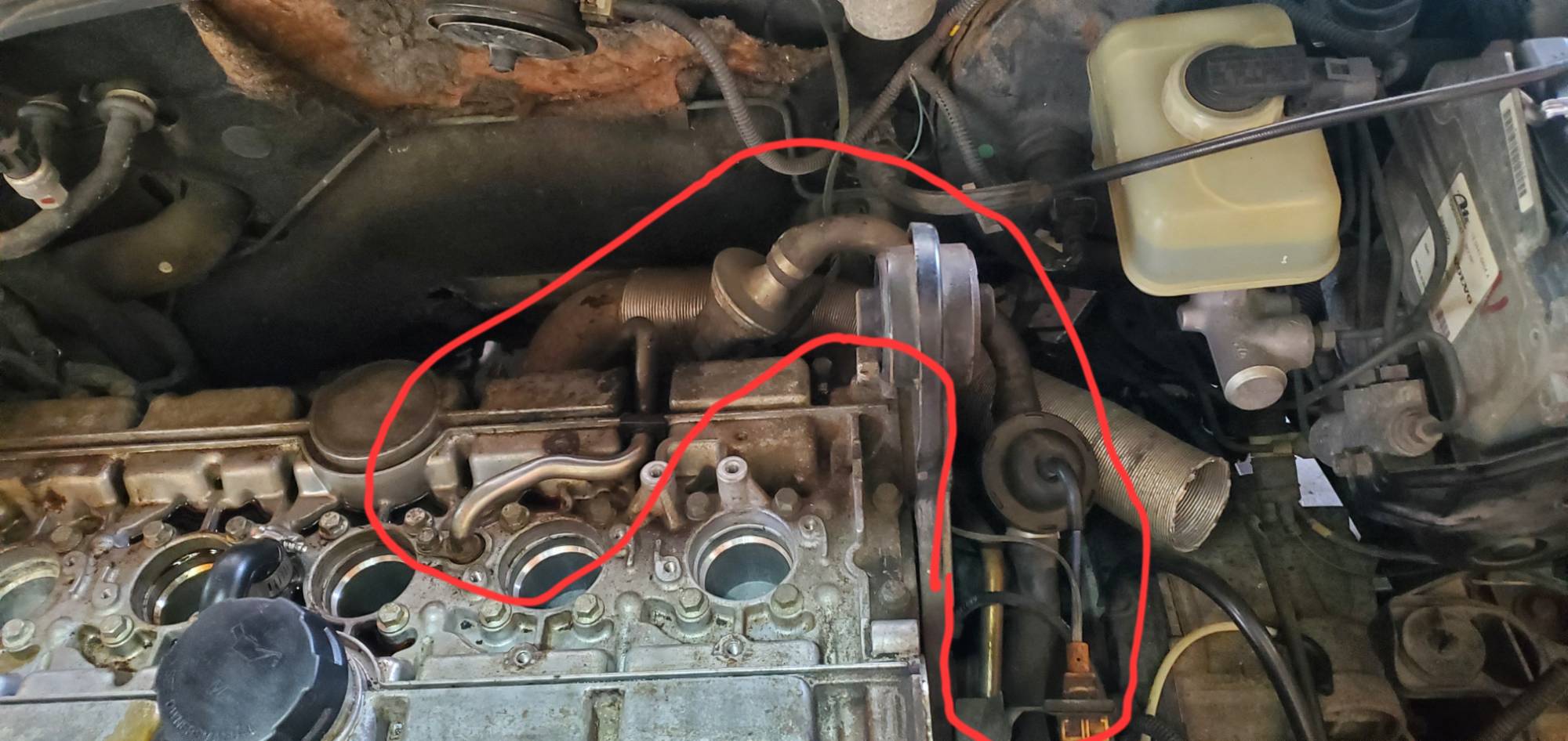

I can't find any info on this thing, does anyone know what this is?
1994 non turbo 20 valve.

Thats either really early version of Supplemental Air System (SAS), Exhaust Gas Recirculation (EGR), or an early Crankcase Ventilation system. I would guess the latter, of the threejsrnsis wrote: ↑23 May 2023, 12:58 20230523_144645.jpg
And I now have a Tekton inch-pound torque wrench. I'd really like some type of split-beam or higher quality wrench but they're a bit out of my price range. I have a pretty bad track record with shearing off bolt heads.

Looks EGR-related, but it's going to the valve cover... hmm... maybe a heater for the PCV?

https://www.bostonvolvocarsparts.com/p/ ... 07813.html
I really thought these earlier cars didn't have SAS. Even then, I don't understand the benefit pumping air from the engine bay right next to the battery tray directly into the cylinder head. Unless there's some extra passages to parts unknown that I'll find when I pop the cam cover off.
I definitely remember the other NA models I've looked at just having the regular SAS that goes into the exhaust or nothing at all. I guess I'm "blessed" with SAS, EGR, and VVIS.

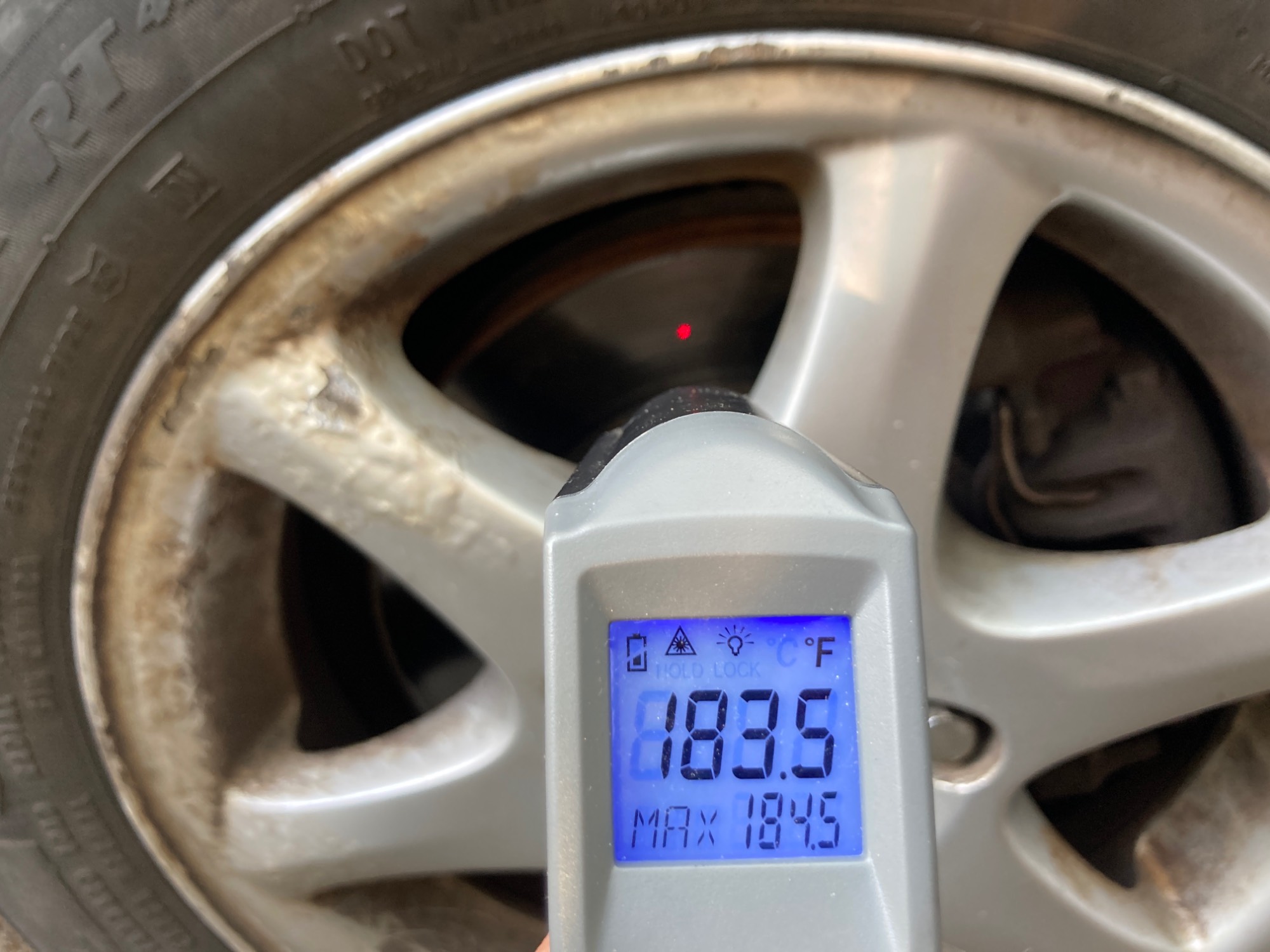

I heard scraping that came from Blue Steel’s brakes while driving to work today. When I got home, three of the discs had a band where the brake pad didn’t seem to be making contact. I also felt heat coming off them, with temps around 150-185 degrees F. The fourth disc was a relatively cool 78 degrees.
I had initially thought it was time for new brakes, but is it possible I have three stuck calipers?

Those temps I would guess you have one stuck caliper with no braking action.
150-180 disc temps is pretty normal
