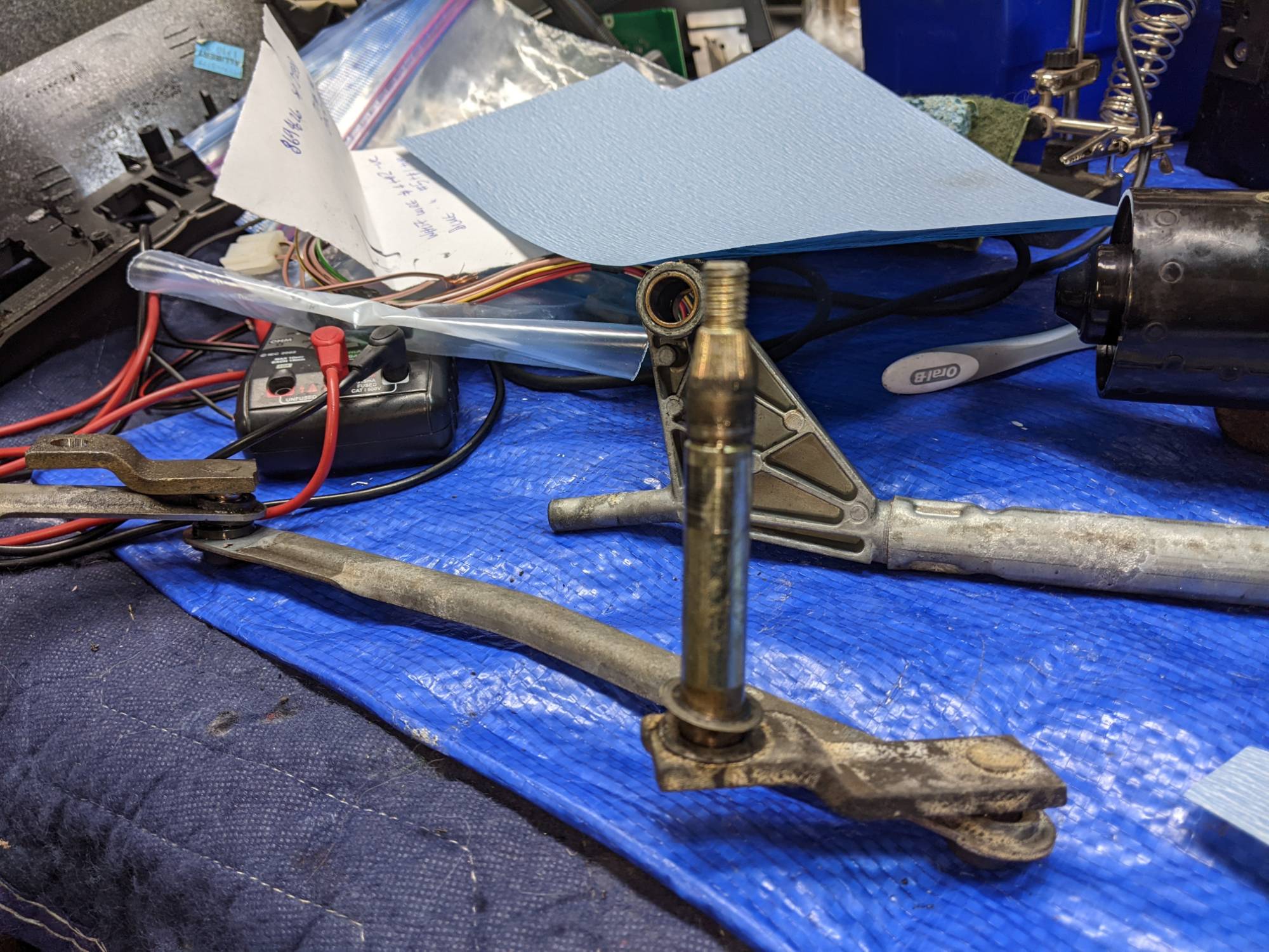

Decided to look at the window wiper mechanism while in the pile that is my R dashboard repair and while it was out.
Glad I did. One side the shaft was near perfect and no real signs of any rust on the bearing surface and shaft, the other one is badly rusted, especially at the bottom:
I have been using an old thread for info and it is fairly straight forward, but essential you mark the arm positions prior to removing the mechanism.
I am using 400 grit wet/dry and WD-40 as a lube to try to clean the shafts. The better one was not really needing much, but the bad side is almost beyond repair due to deeper rust pitting. I will do the best I can with this but have to be careful not to get too aggressive or I will end up with a lot of slop on that arm which will likely lead to judder.
I will give it a little more cleaning before rebuilding with plenty of grease.
