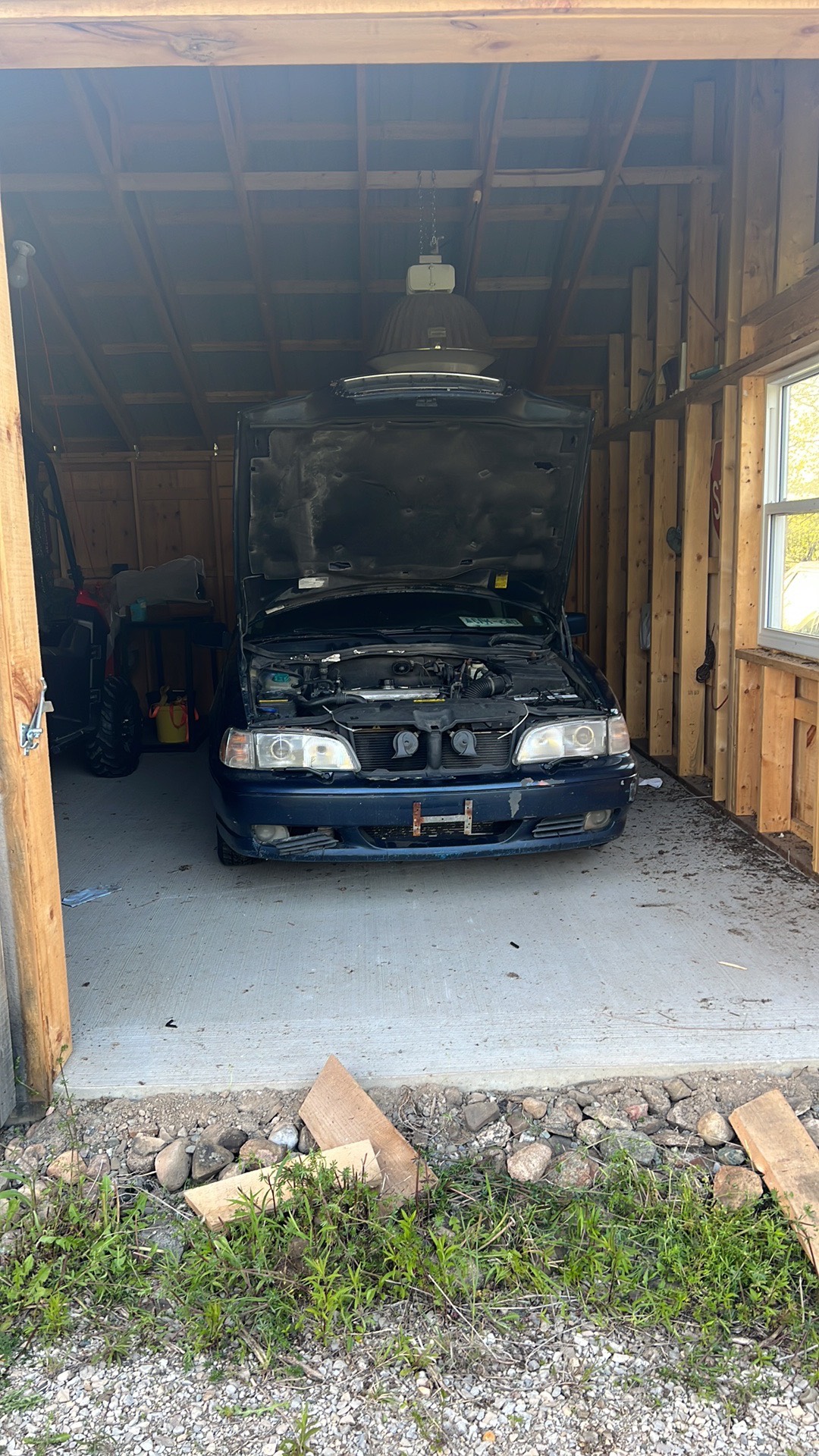

Got the wagon moved to the workshop for the next stage of its life. The tow truck driver was great and able to reverse it in with the wrecker. Hit truck reminded me as the car as the electric seats didn’t work, ac was dead, multiple dash lights, leaky hydraulics, 800 k km+ on the dash and a bad wheel bearing on it but it just kept going…
Next steps will be removal of accessories on the car and cleaning up the engine.
