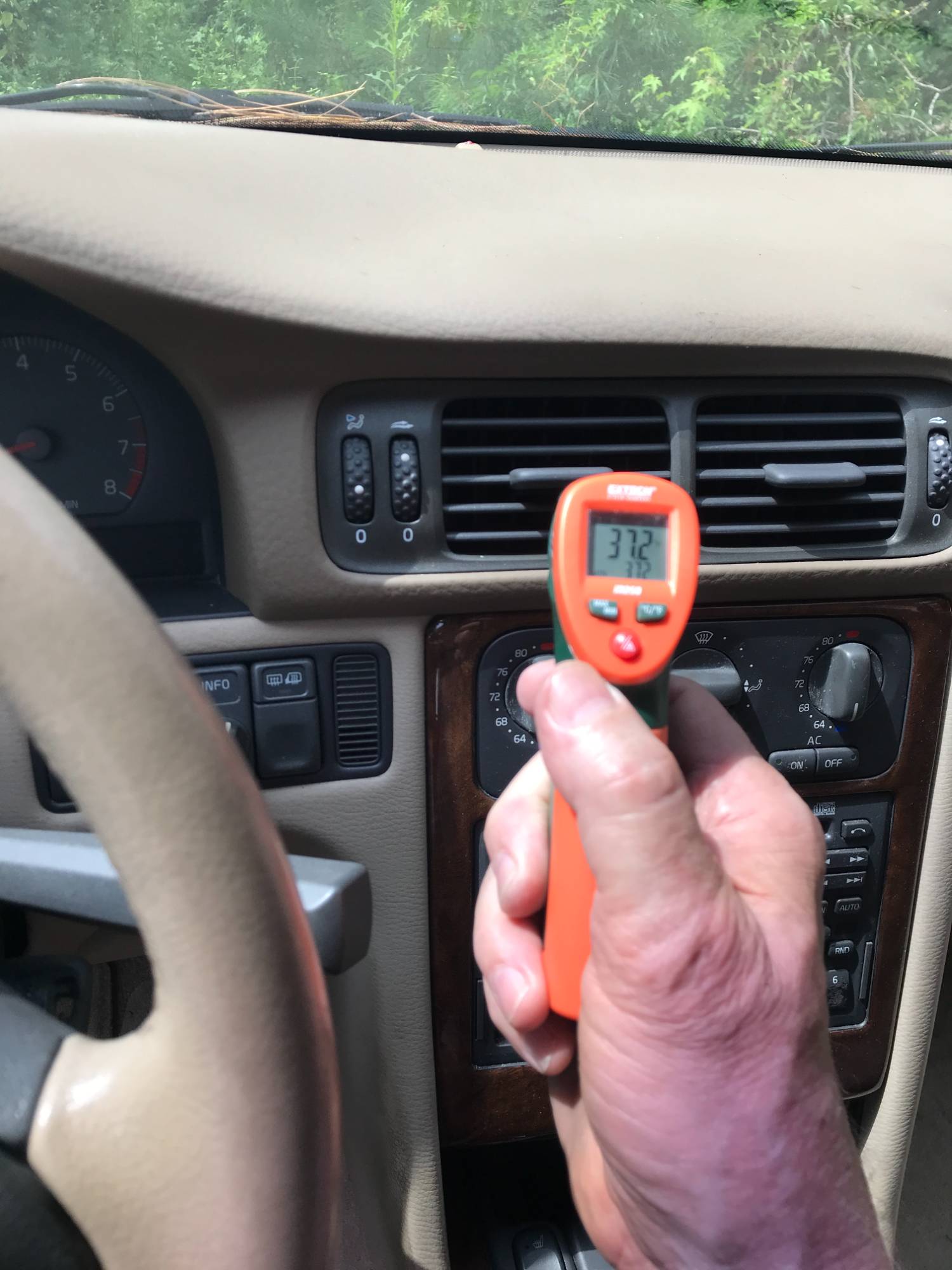

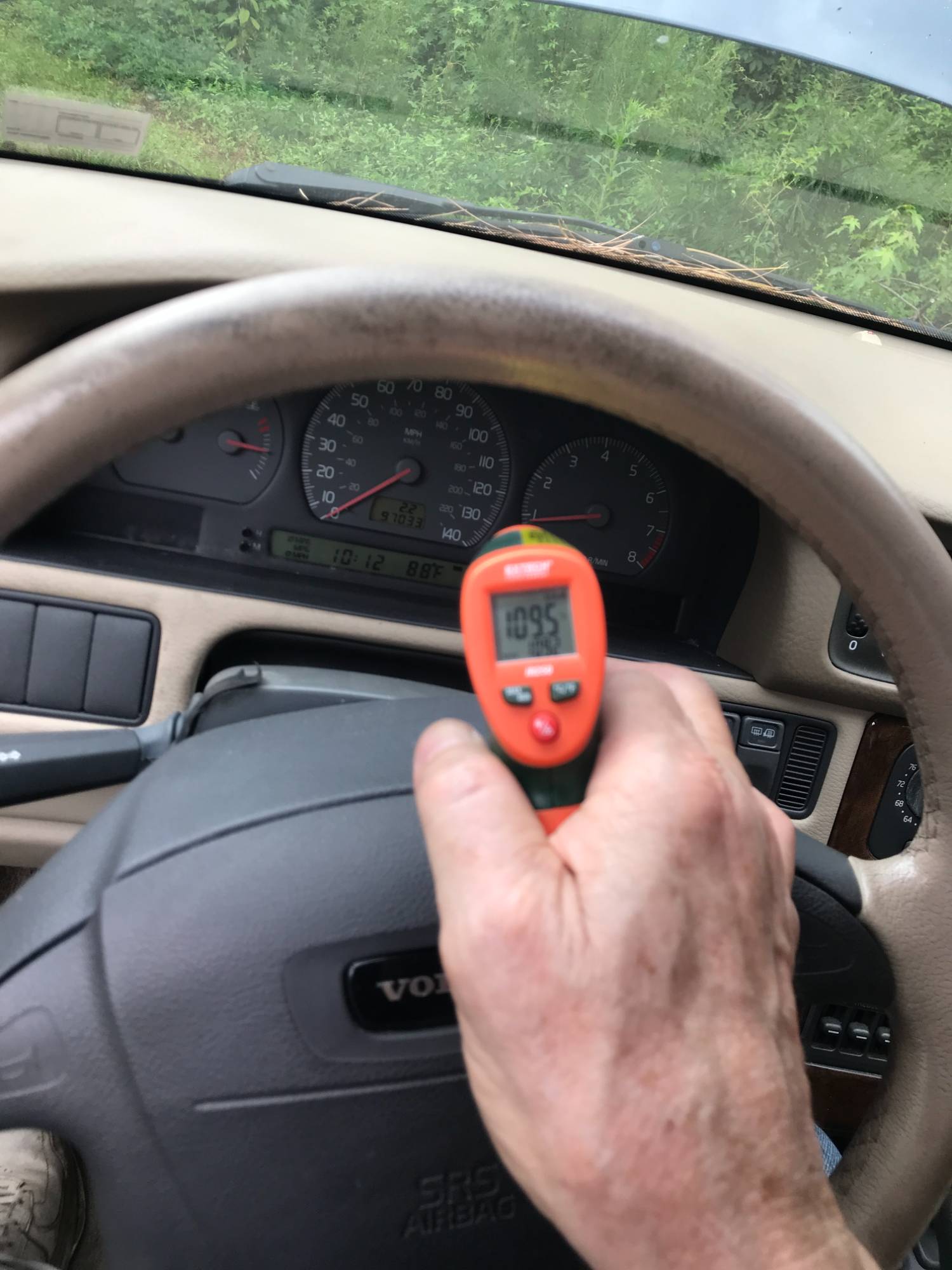

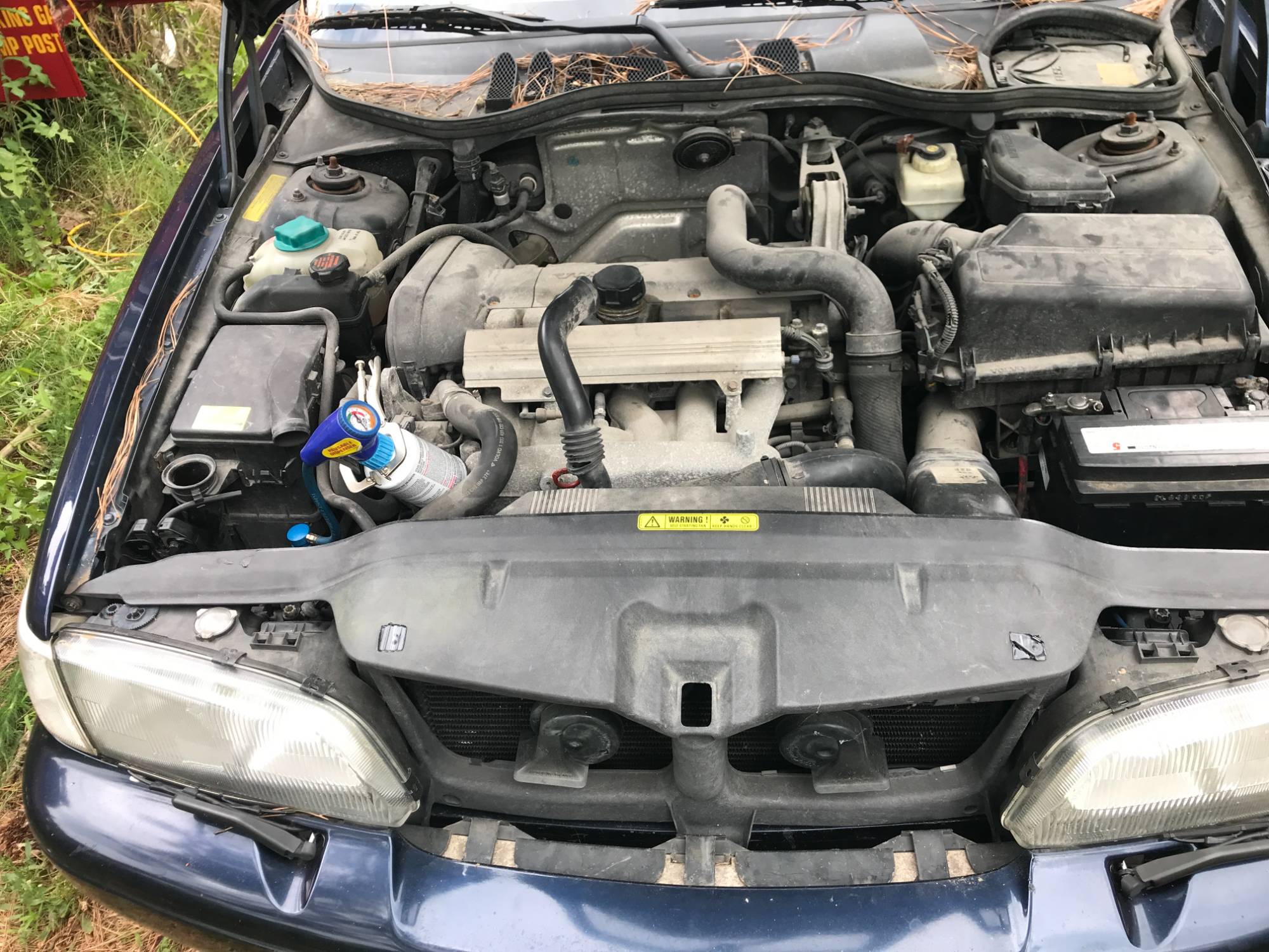

Looked over some things on a new-to-me S70 project, got the radio code from Volvo and both the radio and the antenna work as expected. Close to 90 the other day - before the smokescreen from the poor folks up North hid the sun - so it was a real world test of the A/C.
Worked, air gap on the clutch looked OK but it cycled after a bit,
(iPhone 7 takes crappy pics, common problem from new.)
Small ViseGrip holds the trigger, patience helps
Used most of the can, $9.98 fix.
